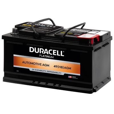

Also, FYI, Sam's Club sells Duracell AGM batteries made by East Penn for $189 vs the $250 everywhere else quoted for an AGM battery.
East Penn is one of the top battery manufacturers, the factory battery is made by Johnson Controls, the same people who made the crap Optimas up till 2020.
My factory battery died the identical way my Red Top died
