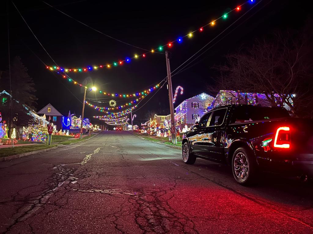

Drove it for the first time in a week up my Christmas nightmare street.
Looks like you tinted the 3rd brake light... what color and then what bulbs are you running. Looks great.
Sent from my SM-G781U1 using Tapatalk
Stock bulbs. Used luxe auto “stealth” for tint. Thanks.
