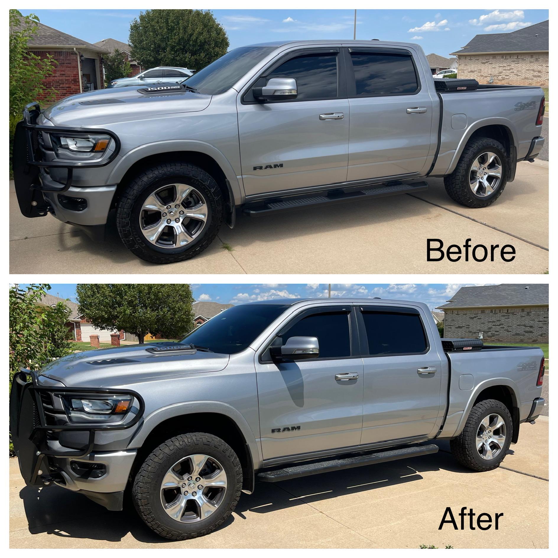

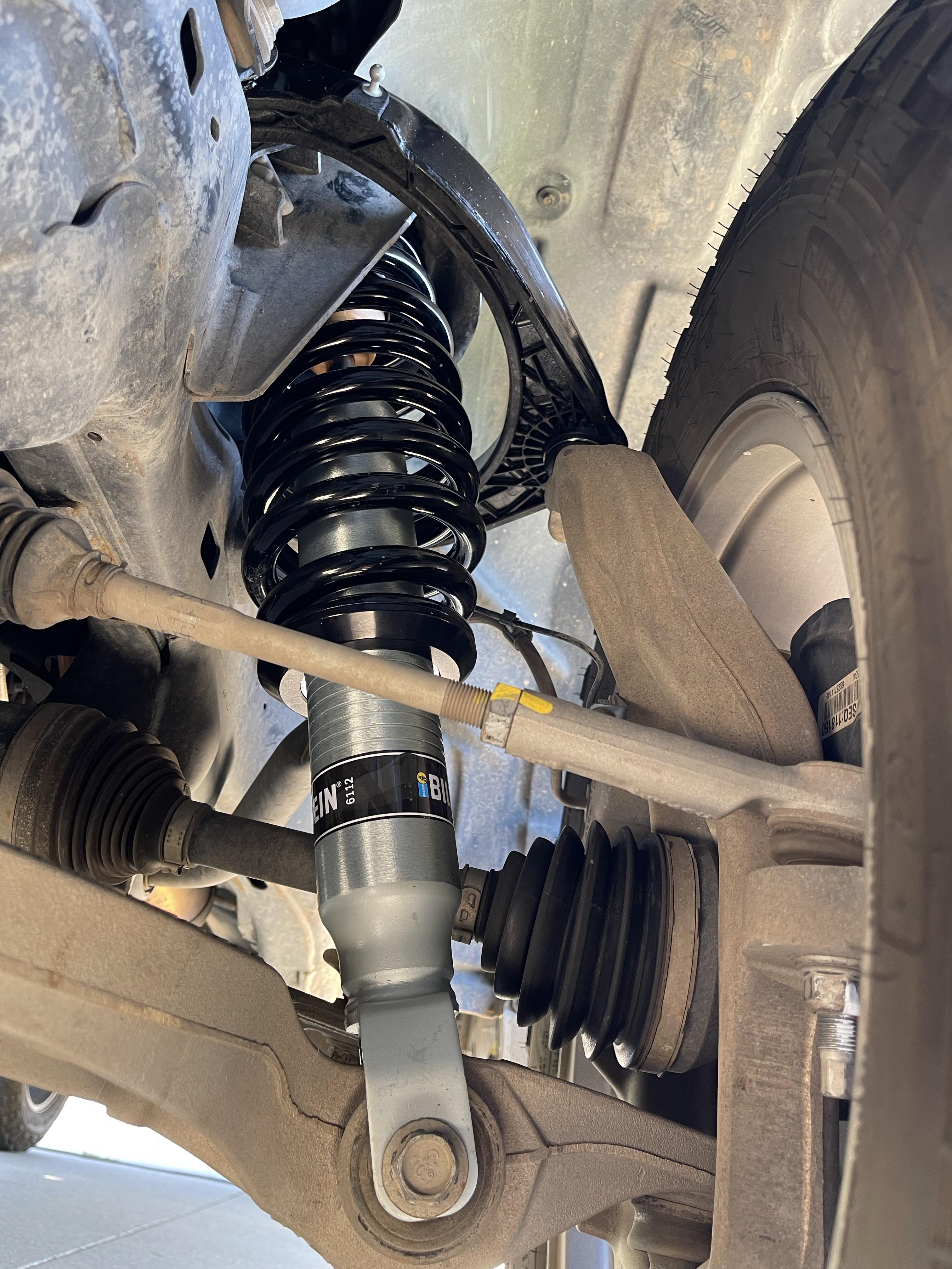

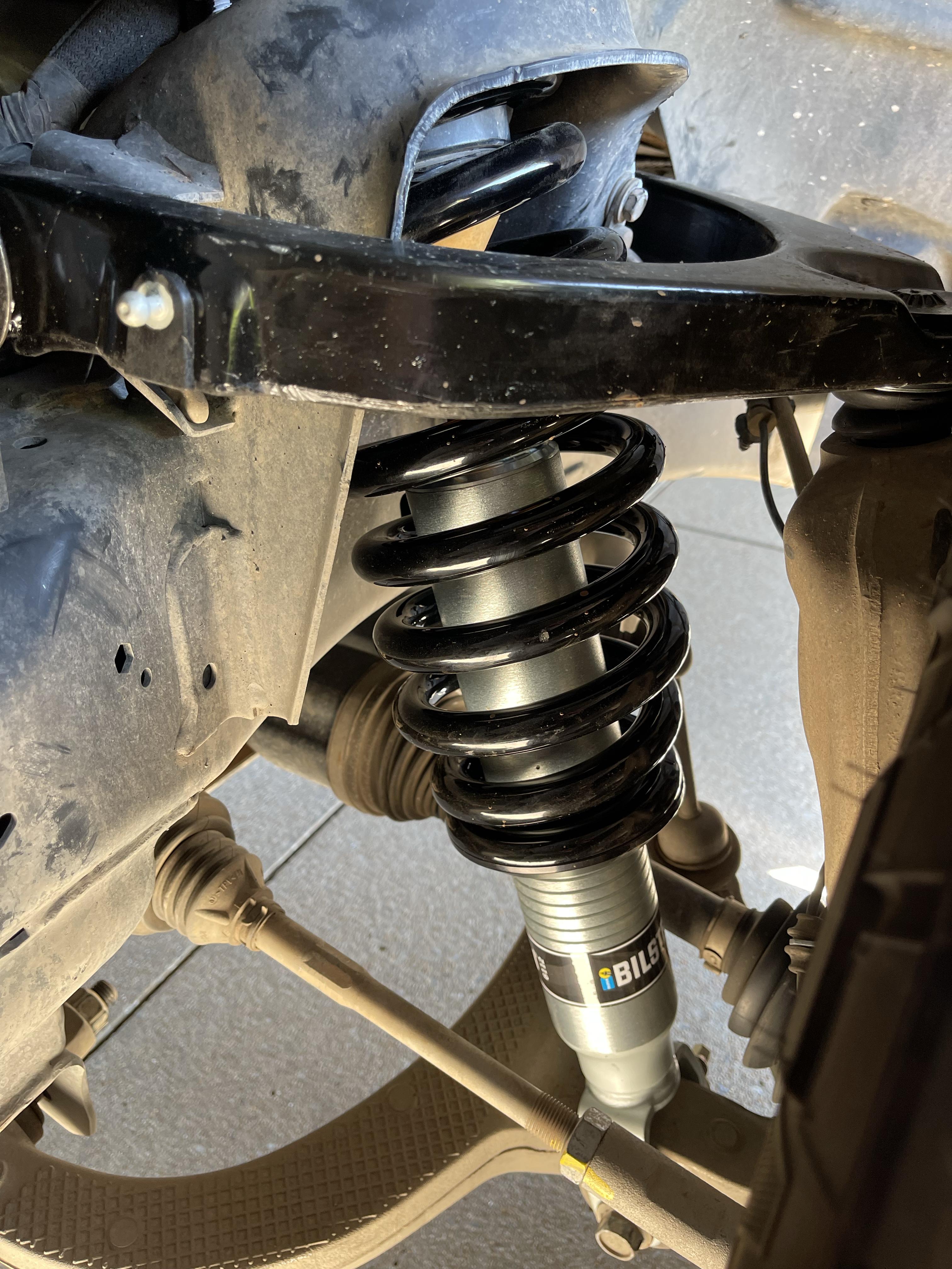

Finally leveled my ‘19 w/ ORG. Went with Bilstein 6112’s (@ circlip #8) and the upper control arms from the Mopar 2” lift kit. Extremely satisfied with the look and ride quality of this setup so far.

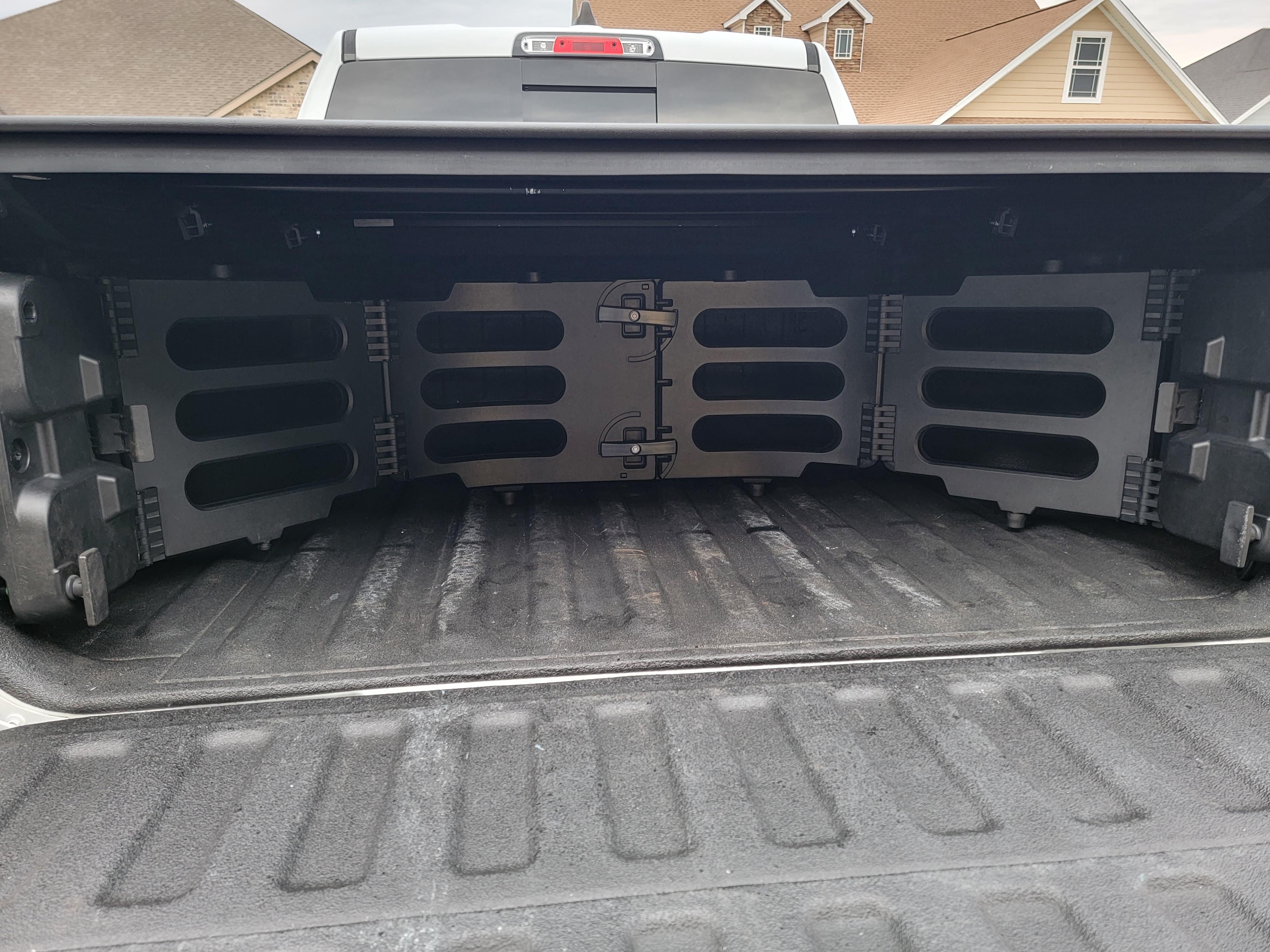

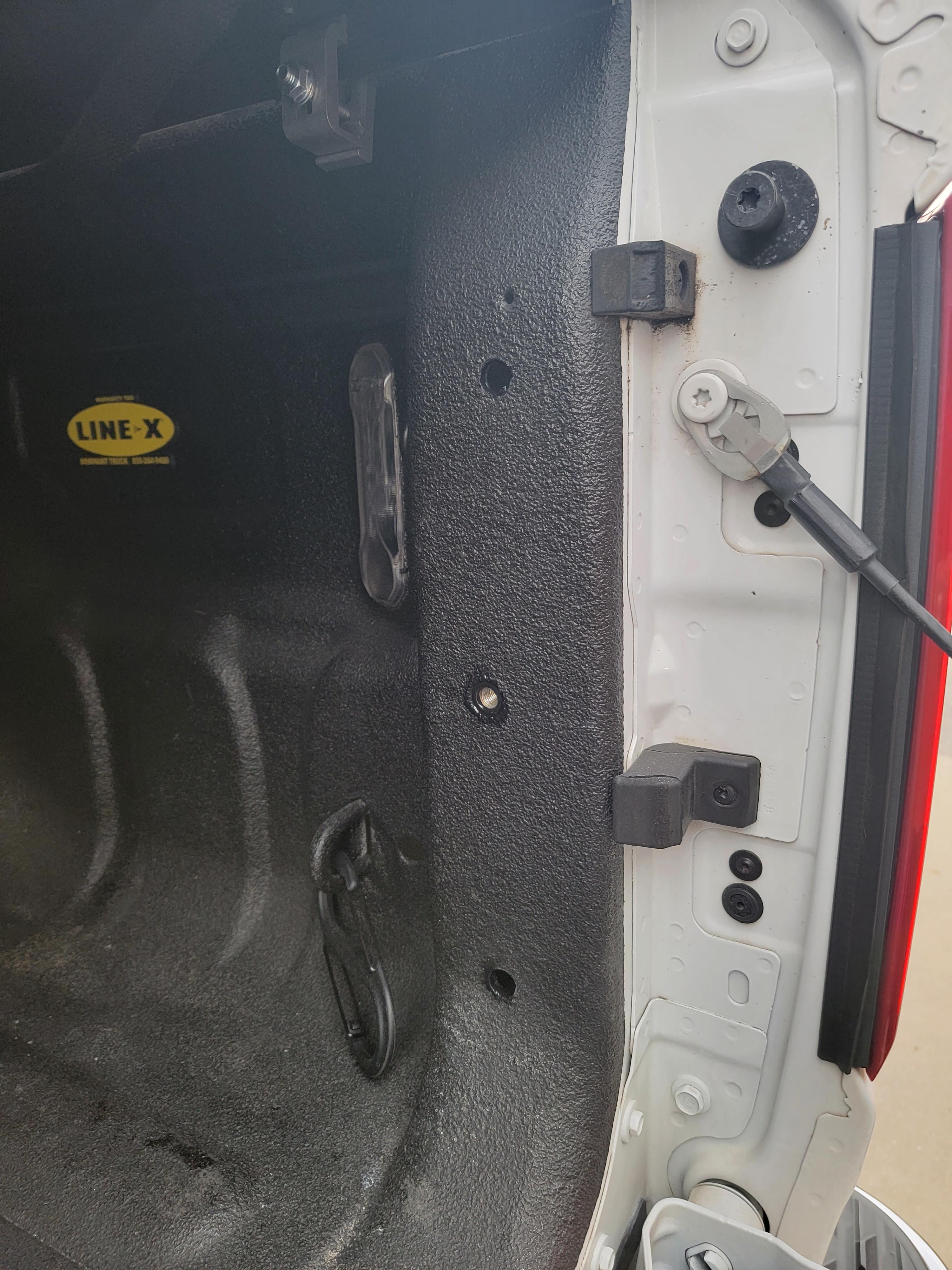

For those wanting bed extenders, I did install the Ford F150 (knockoff on eBay for $180), and works like a charm. I like the ability for it to fold away and collapse to the sides. 10mm rivnut and hole for the pin when it's extended out on the tailgate, done.
View attachment 137821View attachment 137822View attachment 137823
Got mine installed. From a 2014 F150 raptor. Found it on Facebook marketplace for $40.
Only issue I found is that the f150 bed opening is a perfect corner, while ours is rounded off. I just had to raise it about 2 inches. I decided to drill top and bottom pin holes to keep it from bouncing.
