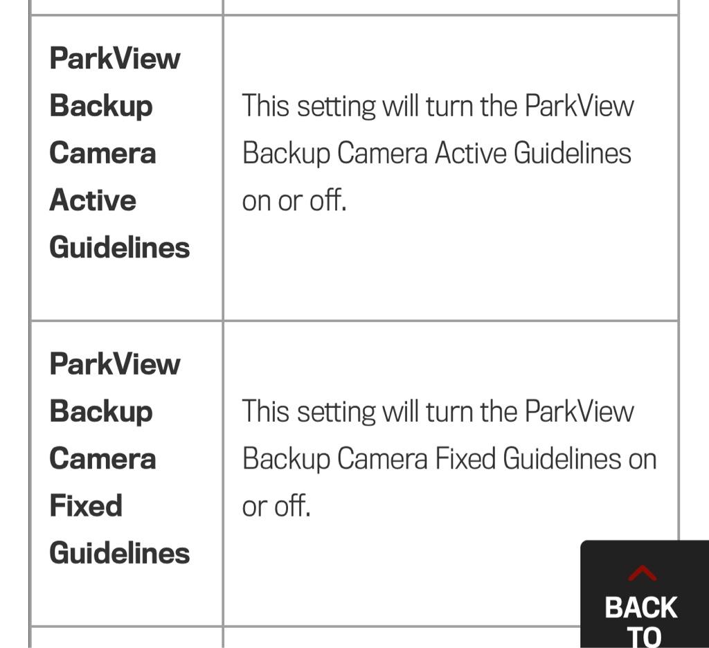

I didn't see a place to change the lines from dynamic to static.
In the uconnect vehicle settings menu under “SAFETY/DRIVING ASSISTANCE” when you go into the park view camera settings you should see a couple choices:
