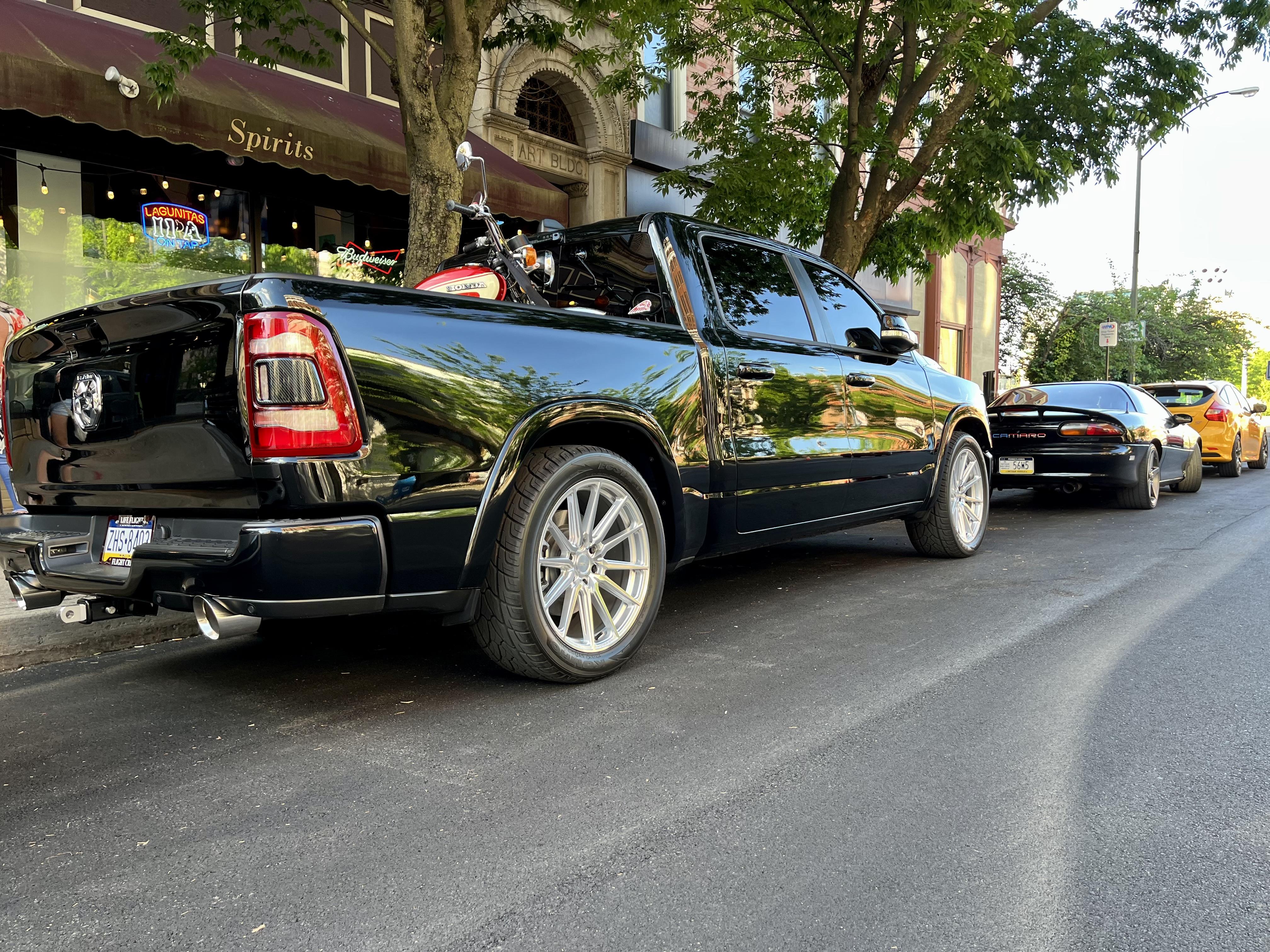

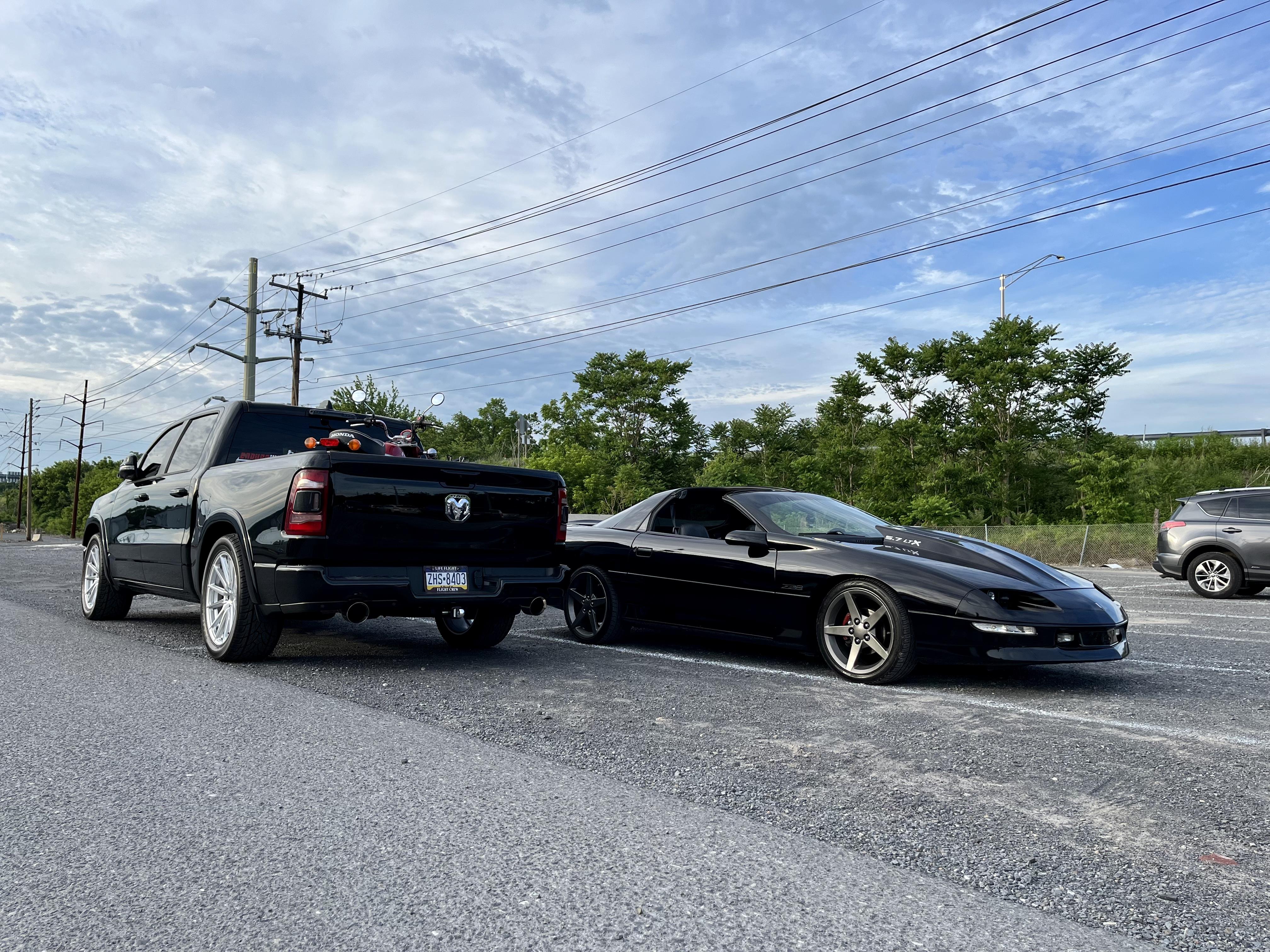

Dropped off a 72 Honda 125 I finished and picked up a 2021 Honda 125 to do a service on
