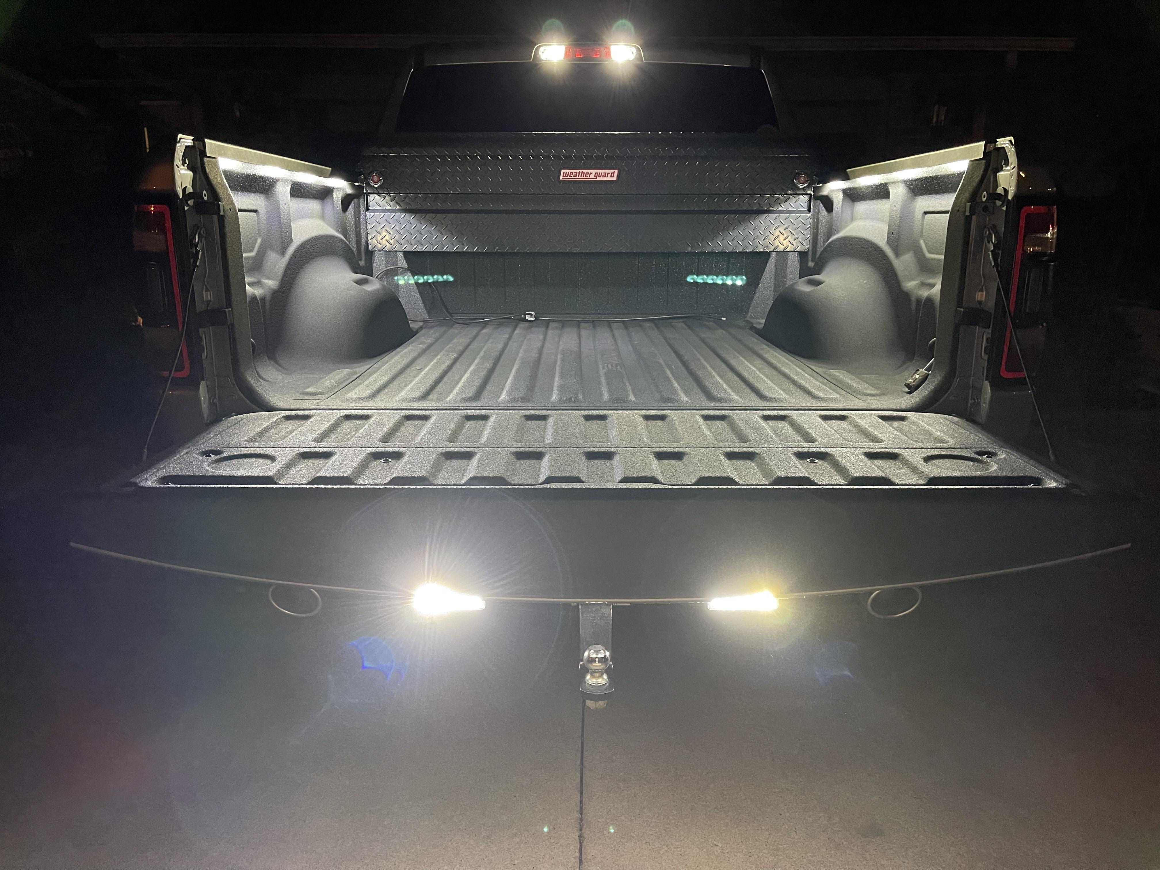

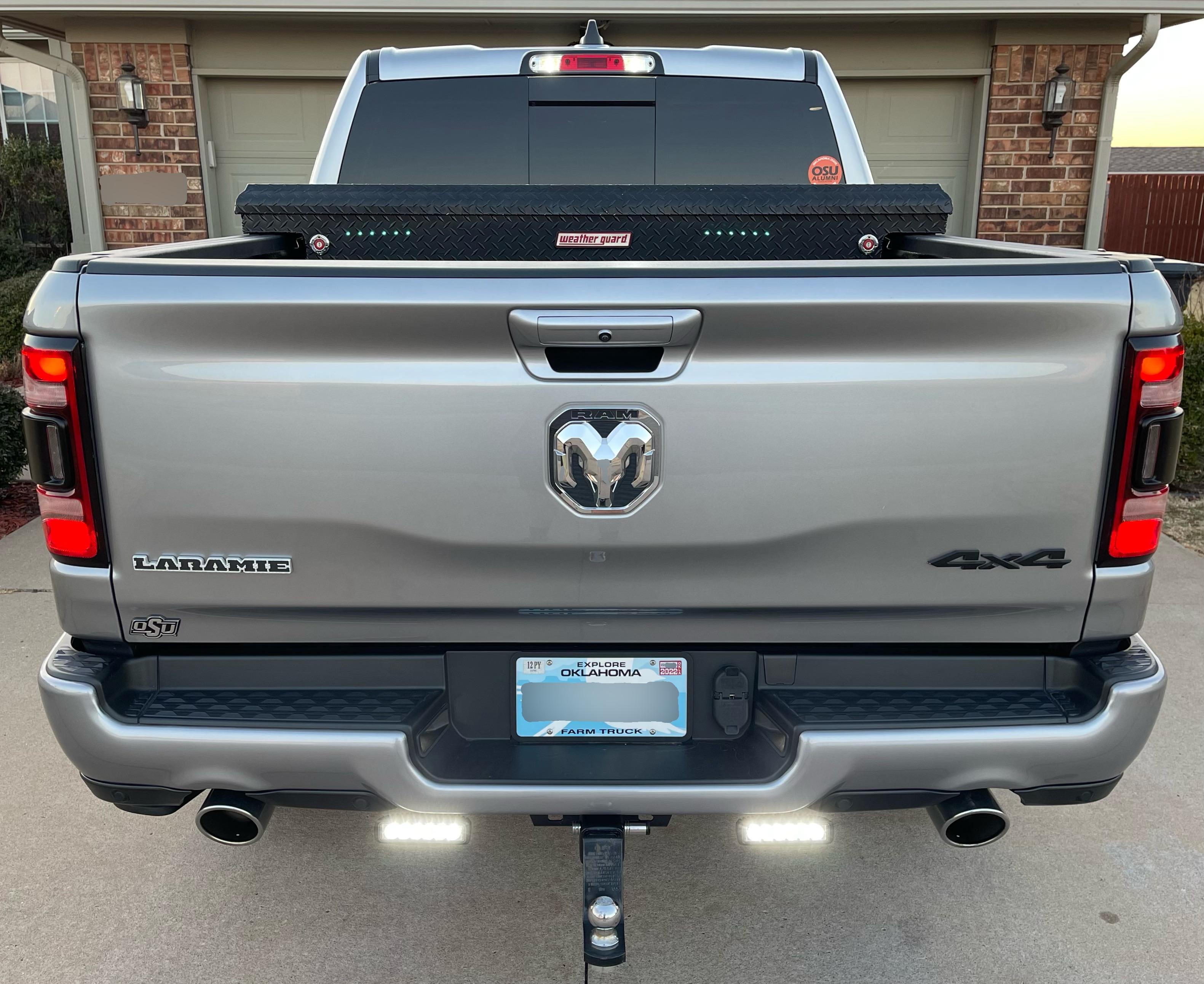

Added my rear bumper lights into the cargo/bed light circuit. Previously had them solely on the reverse light circuit via the trailer harness. Tapped into the bed light power wire and used a diode to eliminate any back-feed. Very handy being able to control them with the cargo lights as well as always coming on in reverse.
For those pesky tailgaters…

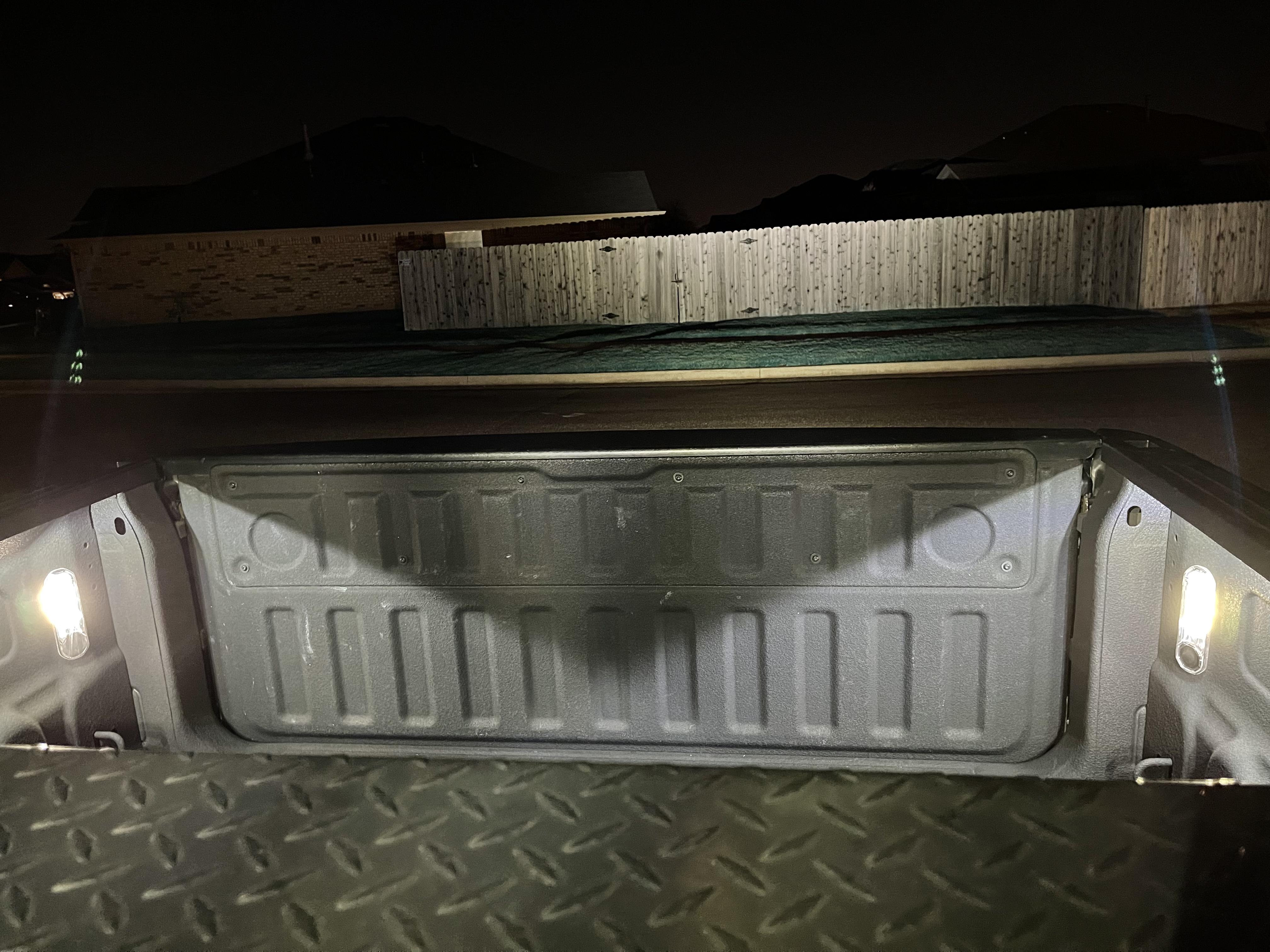

This looks great, one of the better bed light installs I've seen. Nice job! What light kit did you use and where did you tap power?
Thank you! I just pulled some parts together off Amazon (LED’s , wire , good 3m double sided tape) and soldered myself a kit so to speak. (I had to cut the strips into 3 pieces to account for the rail body mounts blocking the groove where the LEDs sit and join them with some wire).
Then I got some connectors of DigiKey and made a ‘Y’ harness to tap into the factory bed lights (which were a PITA to run the wires for btw). So now both of them light up as if from the factory.
(I still need to add some sheathing where the wires go into the bed holes)
I'd like to do this. Do you have pictures of how you wired this up?
I did not take any pictures of the wiring but it’s super easy to do if you have the OEM bed lights (I installed and activated them myself using AlfaOBD). I tapped into the power wire (brown/white) for the passenger side bed light and ran a wire with a 1N4001 diode to the power wire for the bumper lights. Make sure the stripe of the diode is pointing towards the reverse lights so that they don’t back-feed and cause the cargo lights to come on when you put it in reverse.
