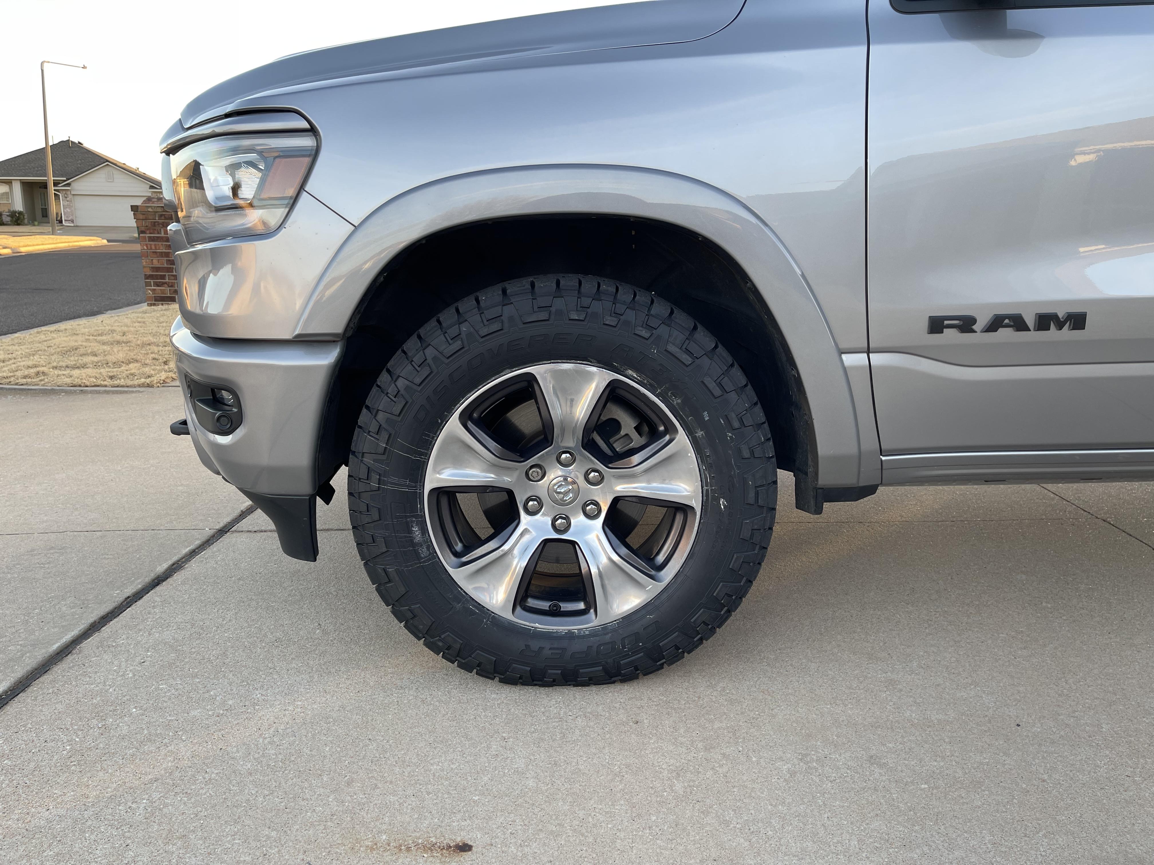

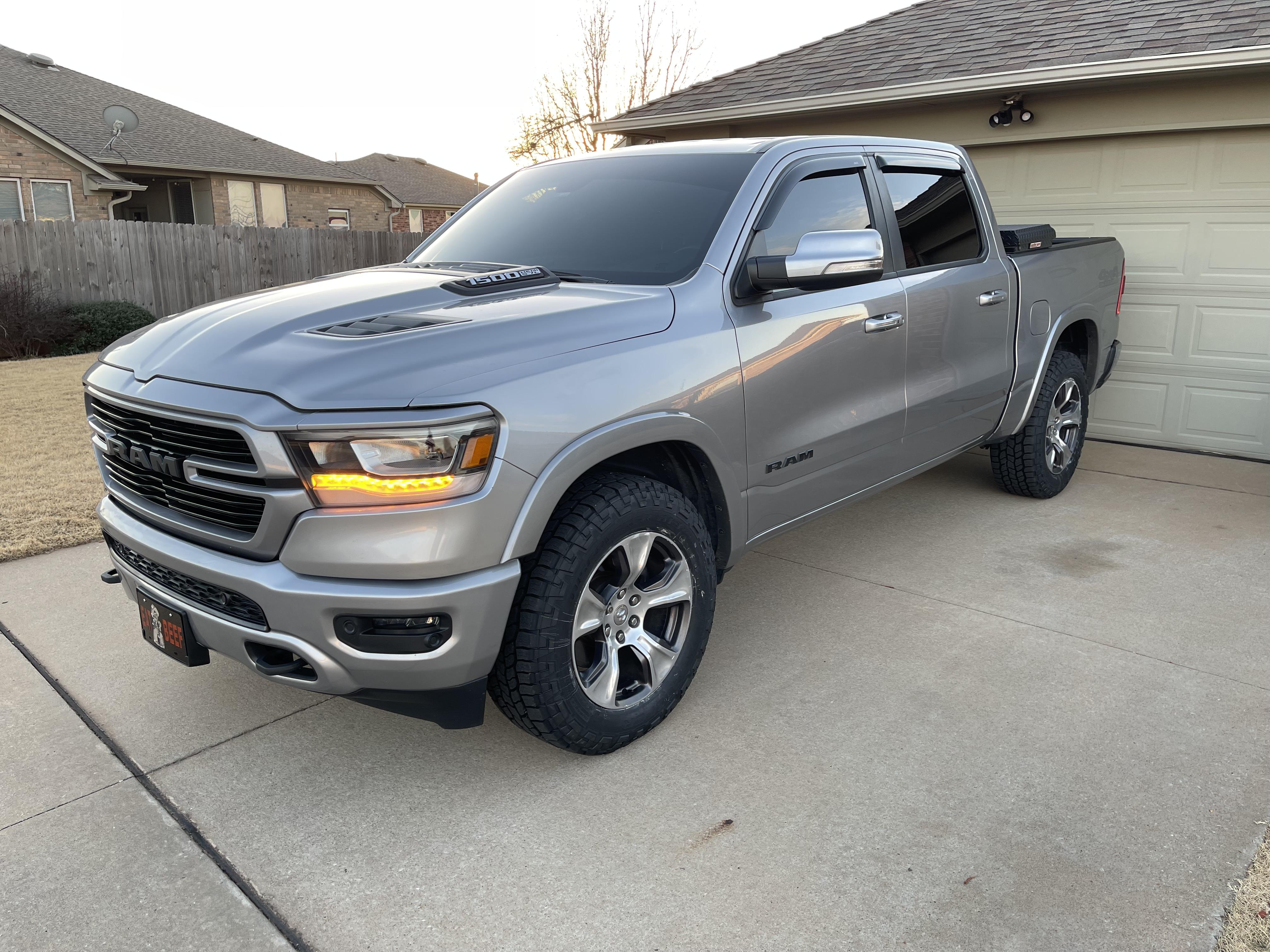

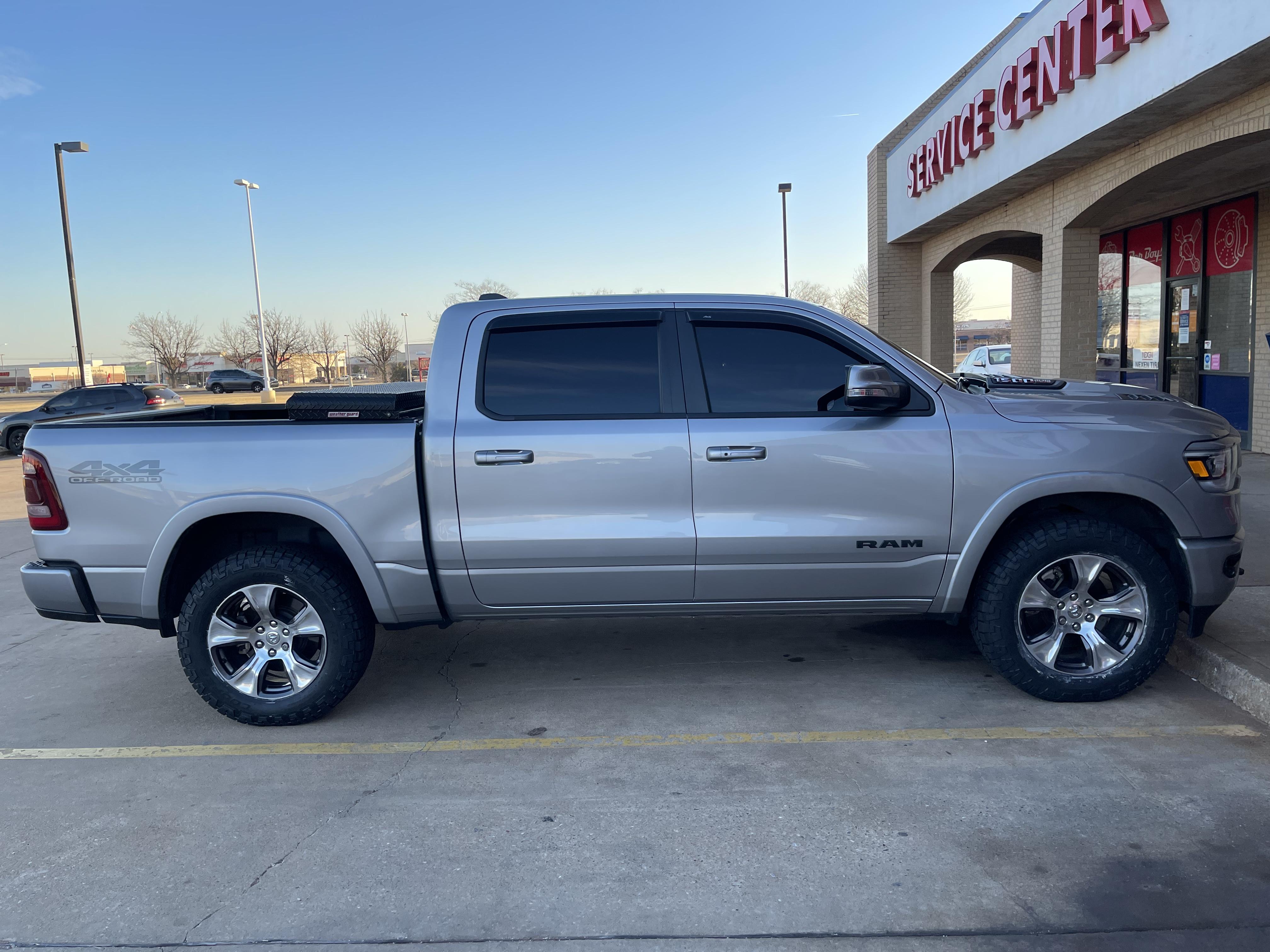

Got new tires mounted today. Went with LT275/65R20 Cooper Discoverer AT3 XLT’s. They fit great with no rub on my ‘19 with the Off-Road Group. Now I have to patiently wait for the Bilstein 5100 shocks I ordered to come in (ETA in March). I plan to install the Bilsteins at circlip #5 and replace the stock UCA’s with the Mopar UCA’s that come with the 2” lift kit. Will also use AlfaOBD to adjust tire circumference for the speedometer to read correctly.
EDIT: I used these instructions to change the tire size in AlfaOBD. My calculated tire circumference came out to 2672mm. The speedometer now reads spot on with GPS, and causes no problems with the parking sensors.

Got new tires mounted today. Went with LT275/65R20 Cooper Discoverer AT3 XLT’s. They fit great with no rub on my ‘19 with the Off-Road Group. Now I have to patiently wait for the Bilstein 5100 shocks I ordered to come in (ETA in March). I plan to install the Bilsteins at circlip #5 and replace the stock UCA’s with the Mopar UCA’s that come with the 2” lift kit. Will also use AlfaOBD to adjust tire circumference for the speedometer to read accordingly.
Unless you are going to do a rear lift, I'd personally stick with clip #4 on the 5100s. Will give you a slight 1/2" rake. With the Zone Off-road UCAs I just installed, I have zero take now,(5100s on #4) and depending on angle, there is a slight nose high look to the truck, even though I have measured it to be perfectly level. When I had the 1/2" rake, it was barely noticeable, and never had a nose high look.
I’ve definitely been on the fence between circlip location 4 and 5. I see loads of pictures of ORG’s with the 5100’s at #5 but hardly any at #4… As it sits now, with the toolbox fully loaded, I’ve got 2 3/8” of rake. I also plan to install either a grill guard or full replacement front bumper, so that will help bring the front end down. If the nose still ends up too high at #5 after that, I’ll just do 5100’s in the rear as well.

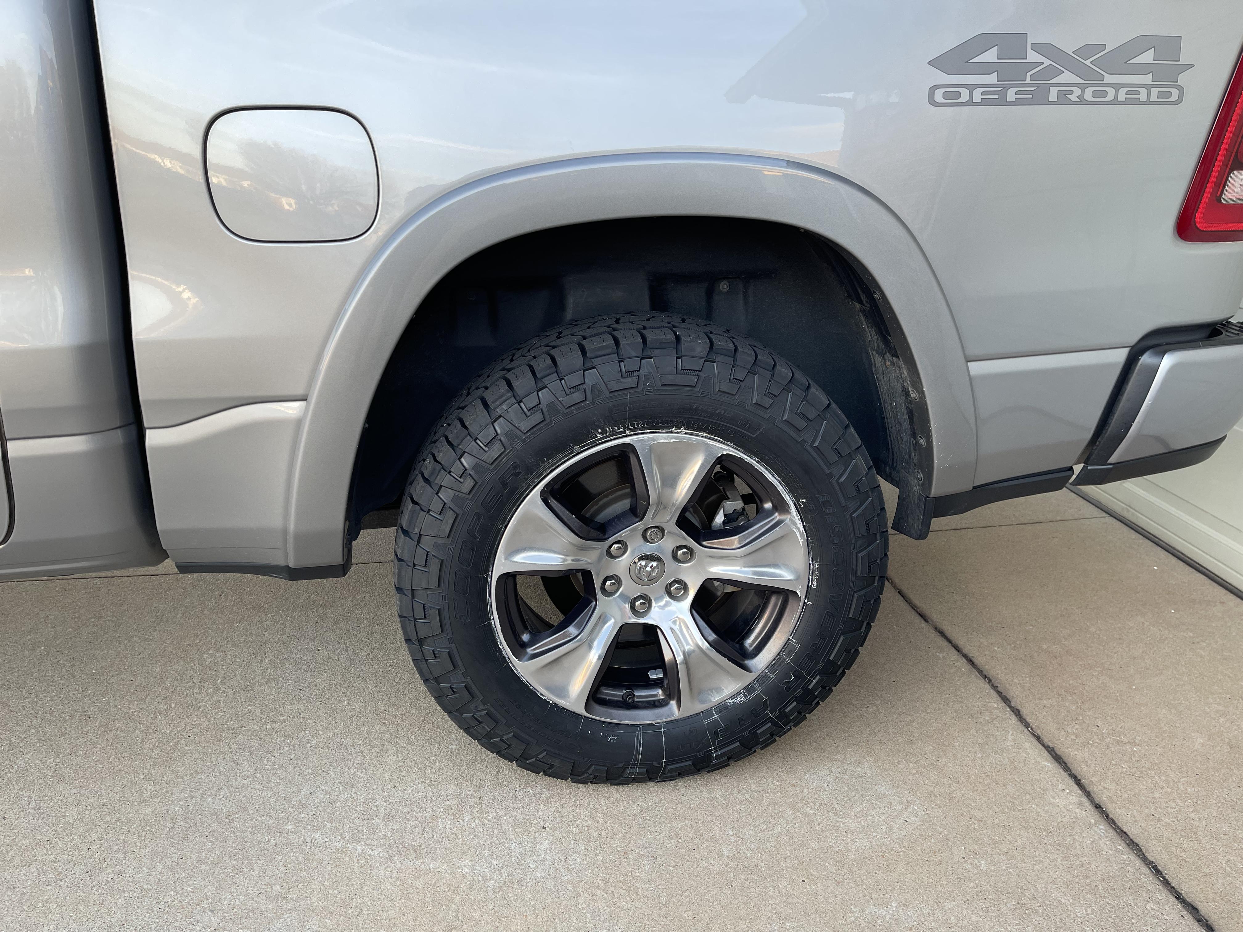

The 5100 rear shocks don't change the ride height in the rear. This is mine on #4 with 275/65/20 tires before I changed the UCAs

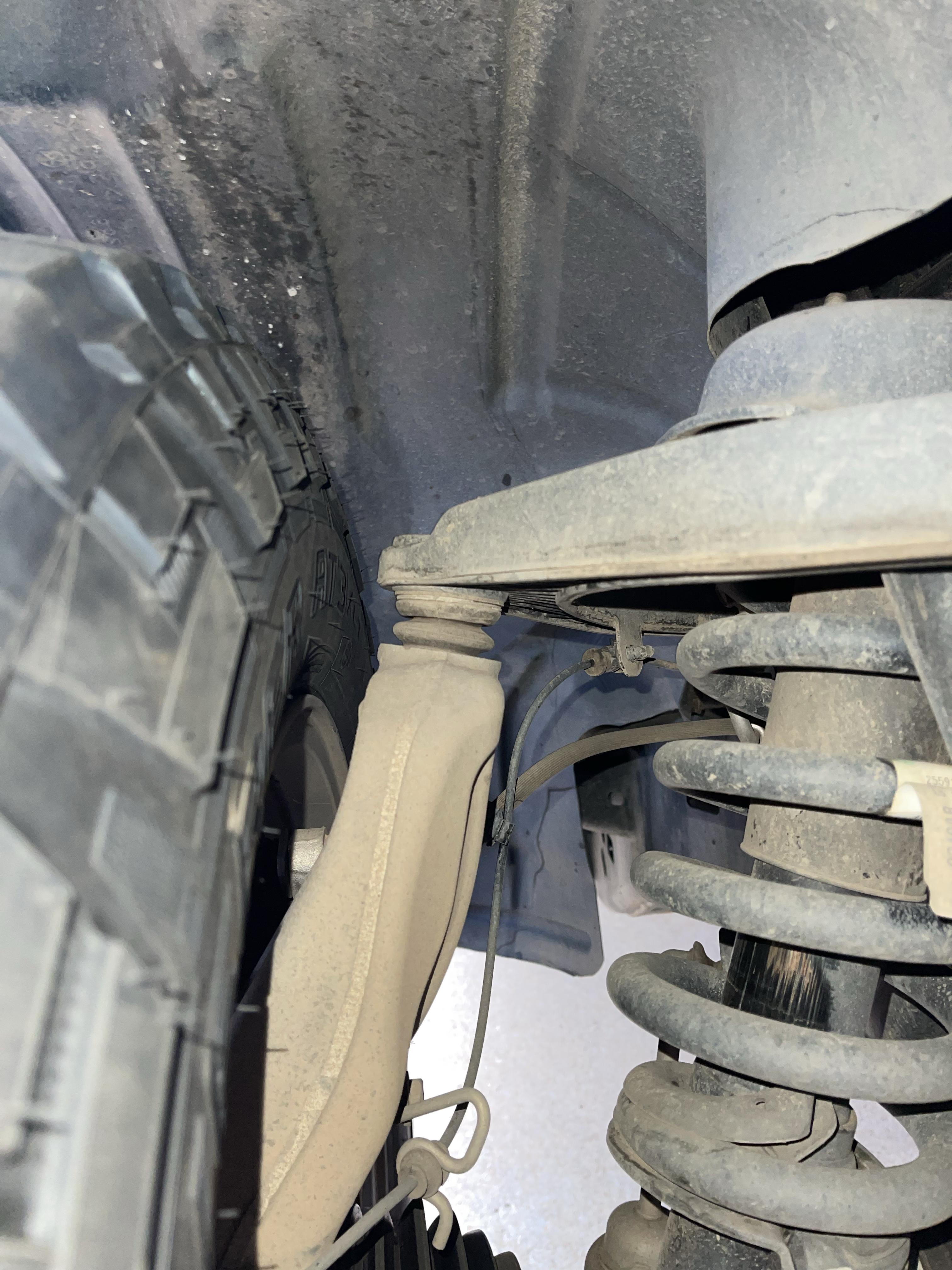

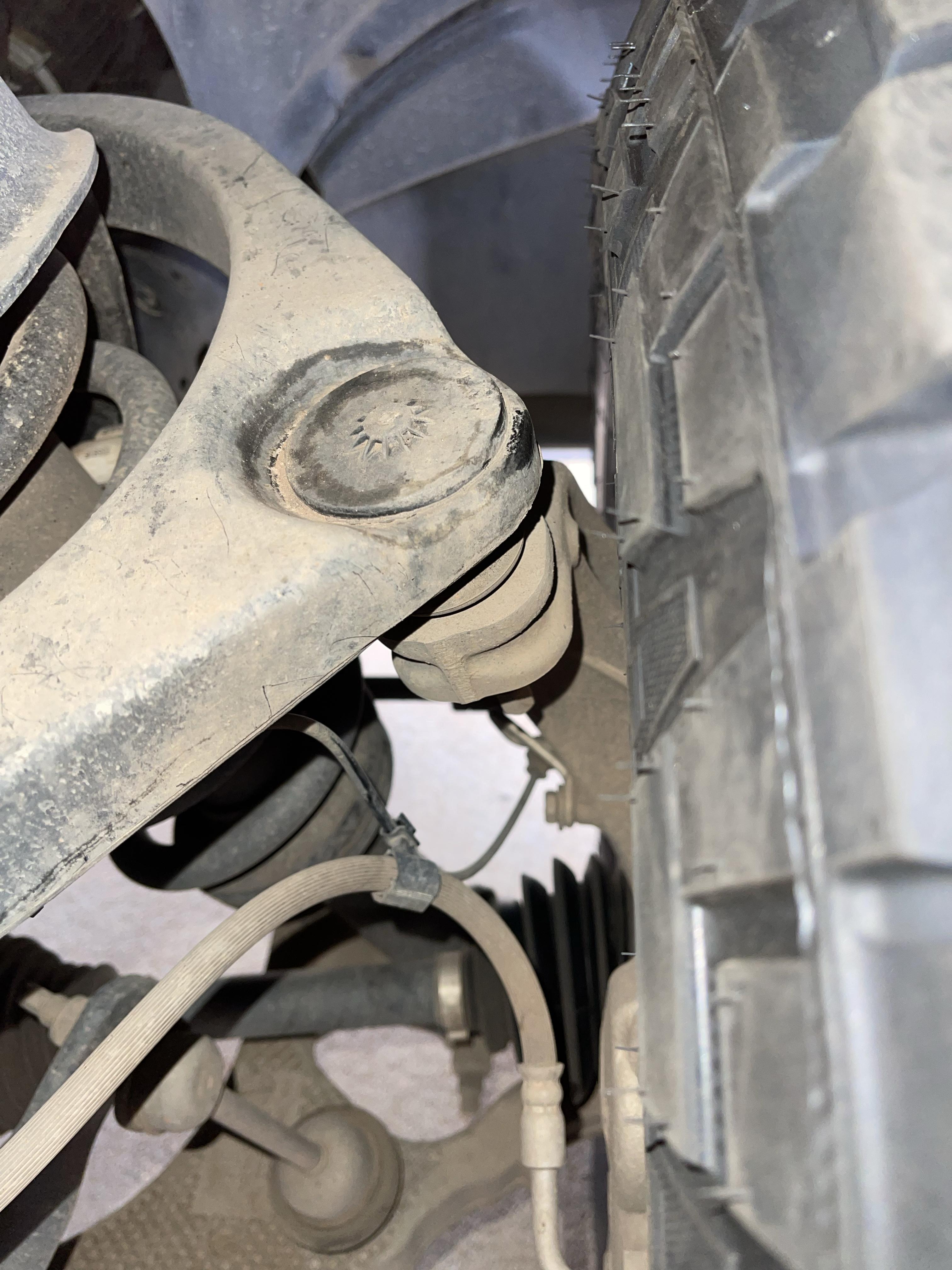

They look great, how is the clearance from the tire to the UCA?
