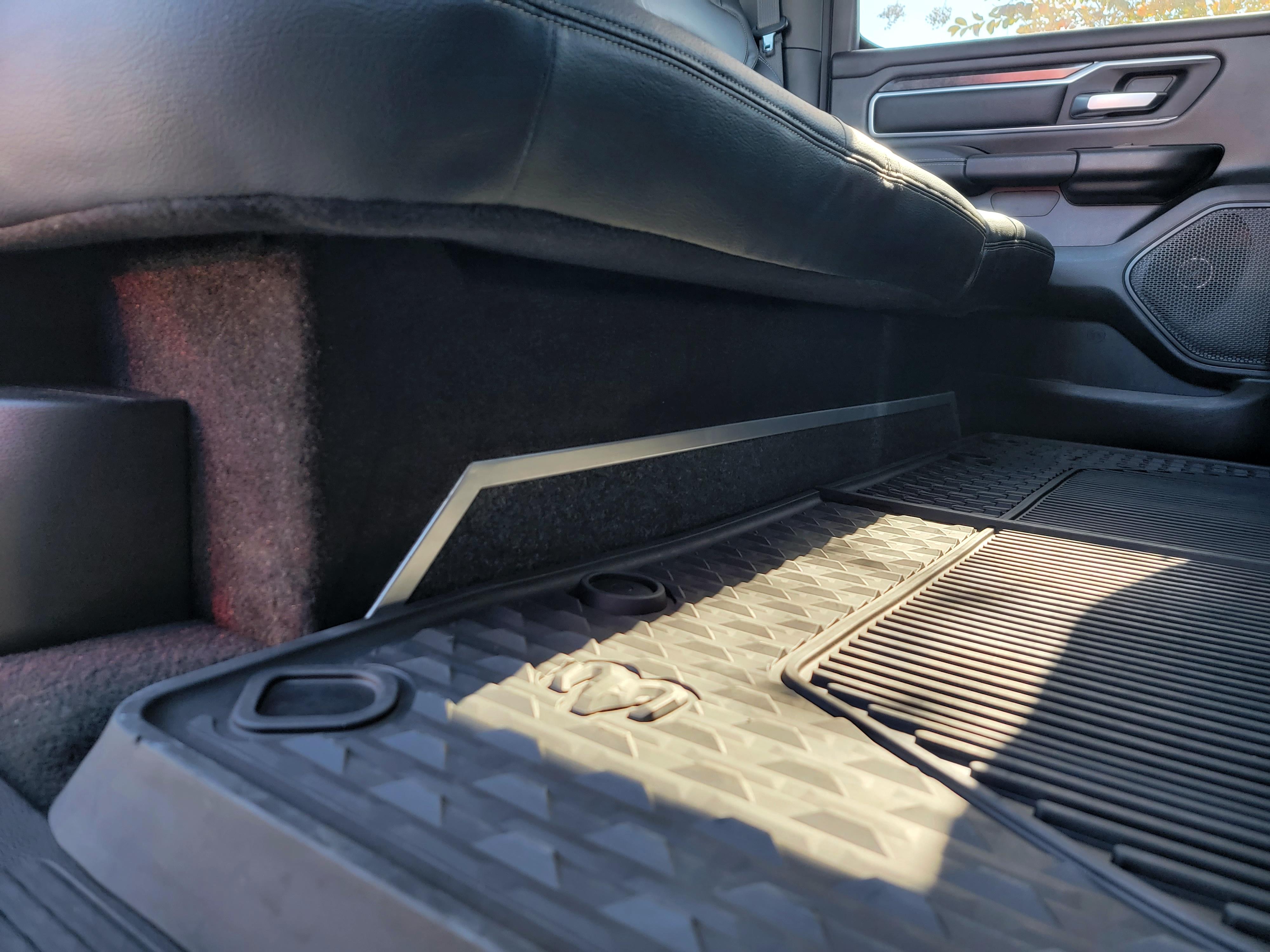

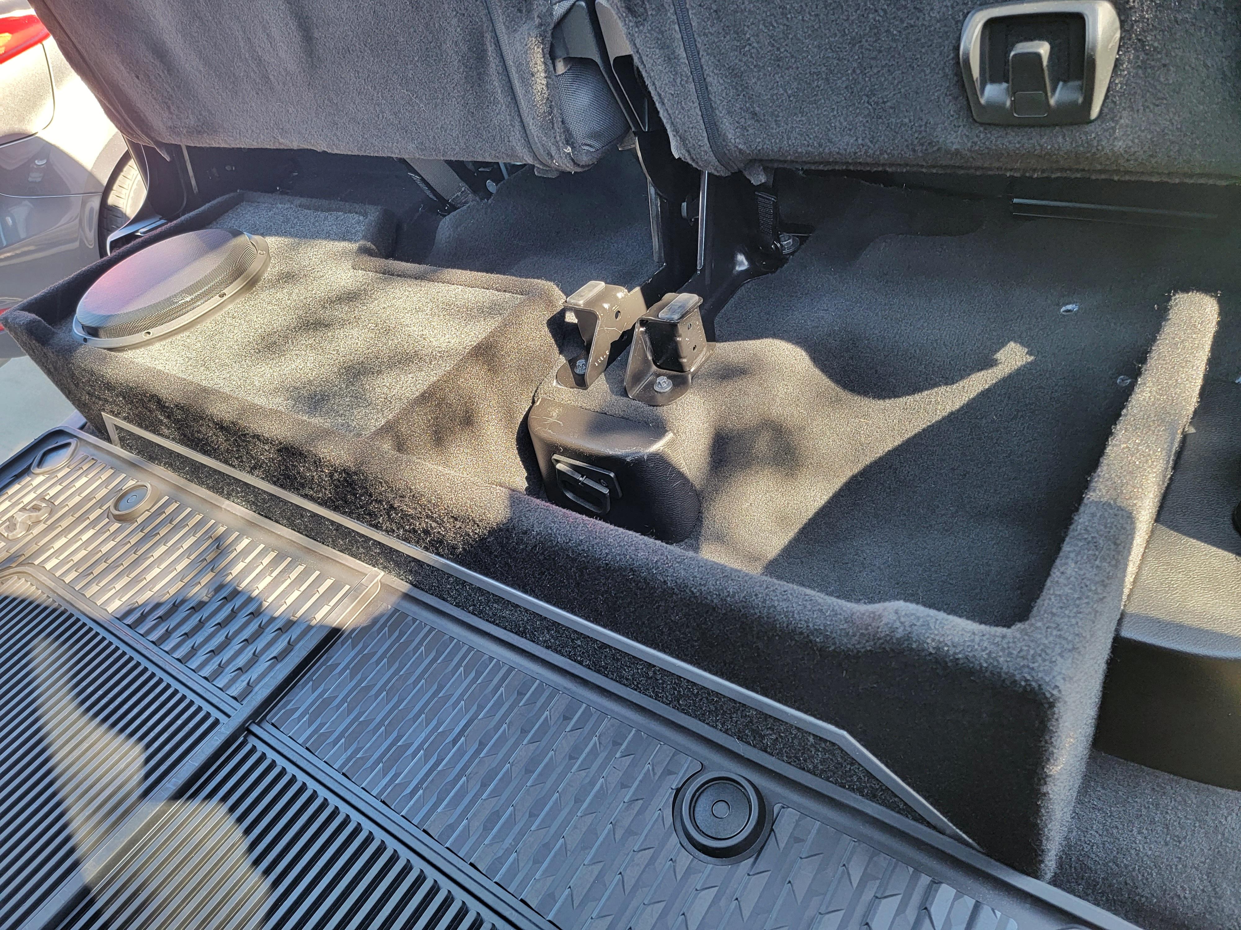

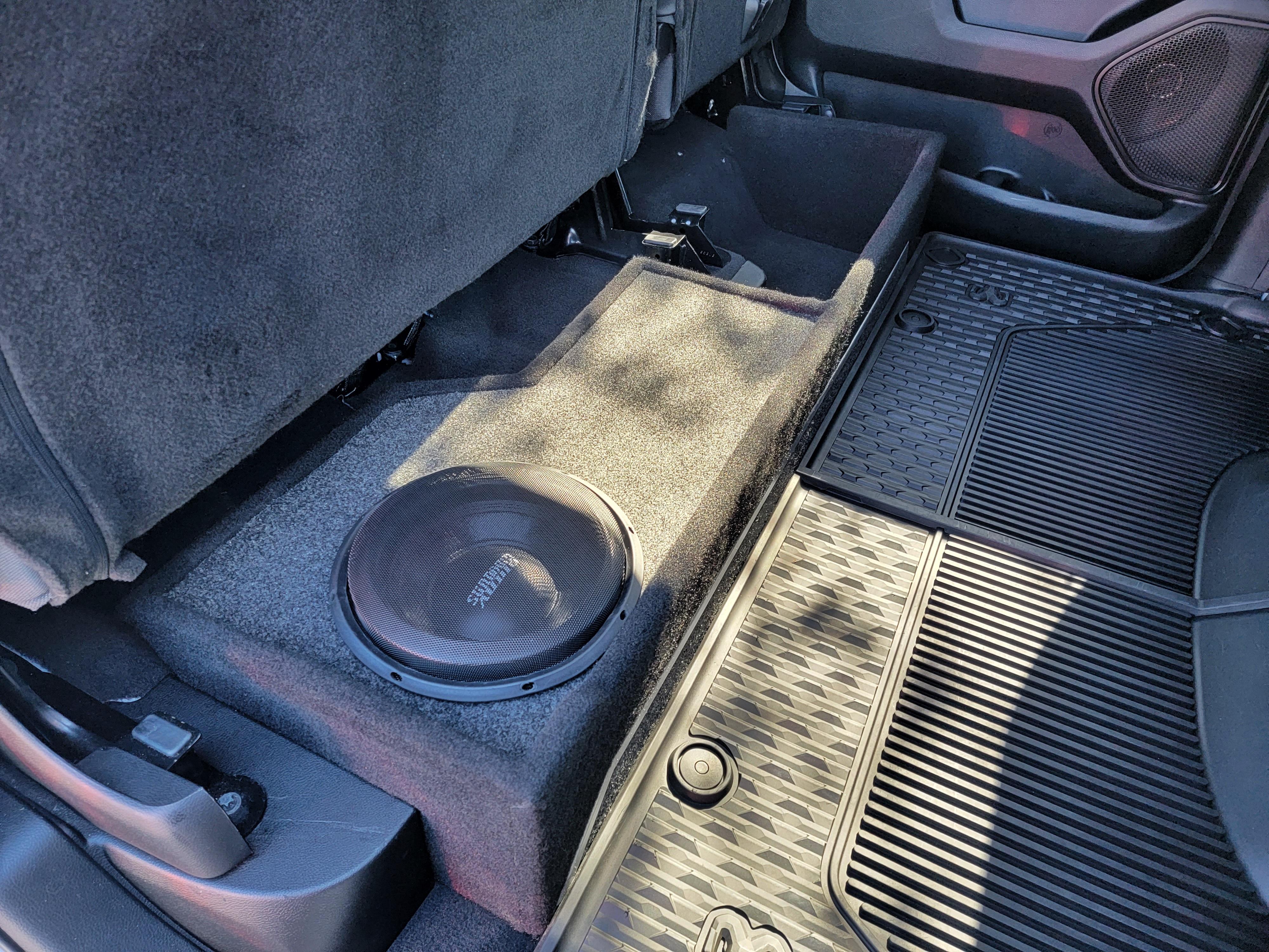

Thanks! Today I got the amp temporarily mounted behind the rear seat. I have to remove it all when they finally replace my back window. I'm also going to sound deaden the back wall. That's were most of the outside noise is coming from. Drive without your rear seat and you'll believe me.
Also got those wrinkles out of the front carpet. I'm thinking I'm going to add some of the silver trim to the sides as well.
All in all, ended up costing too much and was a pain to build (still cheaper than aftermarket prefab), but it's exactly what I wanted, it sounds amazing, and I love how deep the storage on the passenger side is compared to the factory fold down cargo system.
Final pics (I'm sure y'all are sick of seeing them by now)

Man I built almost the exact same under seat storage box for my truck and I’m in the process of building a sub box to fit in the exact spot/size that yours is in lol. It’s like we had pretty much the same idea lol. Yours will look better than mine though lol

i want one but down ported so i wont have anything bumping into the speakers face i also only want to add a 8 inch sub 😂

Na, yours looks great. I like how you slanted it. I was going to but decided I had had enough with trying to figure out all these angles. I should have used an angle finder instead of eyeballing it, checking, adjusting, and so on.... I also, built mine to ensure I can still remove the OEM all weather mats and also access the storage bins. Good luck to ya, excited to see the results.
The area above my sub in the seat is pretty much hollow, but that's also why I added the grill. There are some benefits to downfiring, but you have to factor in the woofer's excursion height, and a good 1-2 inches of clearance beyond that for it to sound right. That would have left me with maybe 4 inches of mounting depth. So, so something to consider when you're planning. On the other hand, not sure if it's a good or bad thing (depending on male/female passenger) but up firing REALLY vibrates the seat above it. (flashback to the Howard stern movie) So there are some pros/cons to both.
I think the front of my box was 9", probably 10 or 11" if you slant it, so you could possibly do a forward firing 8" as well.
