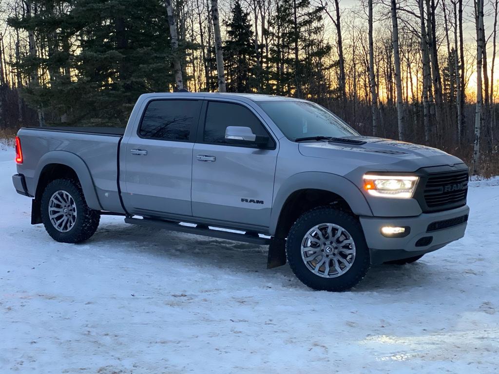

Just got the Mopar Lift installed on my 2020 Bighorn last week. Stock Rebel Tires, and Westin running boards.
