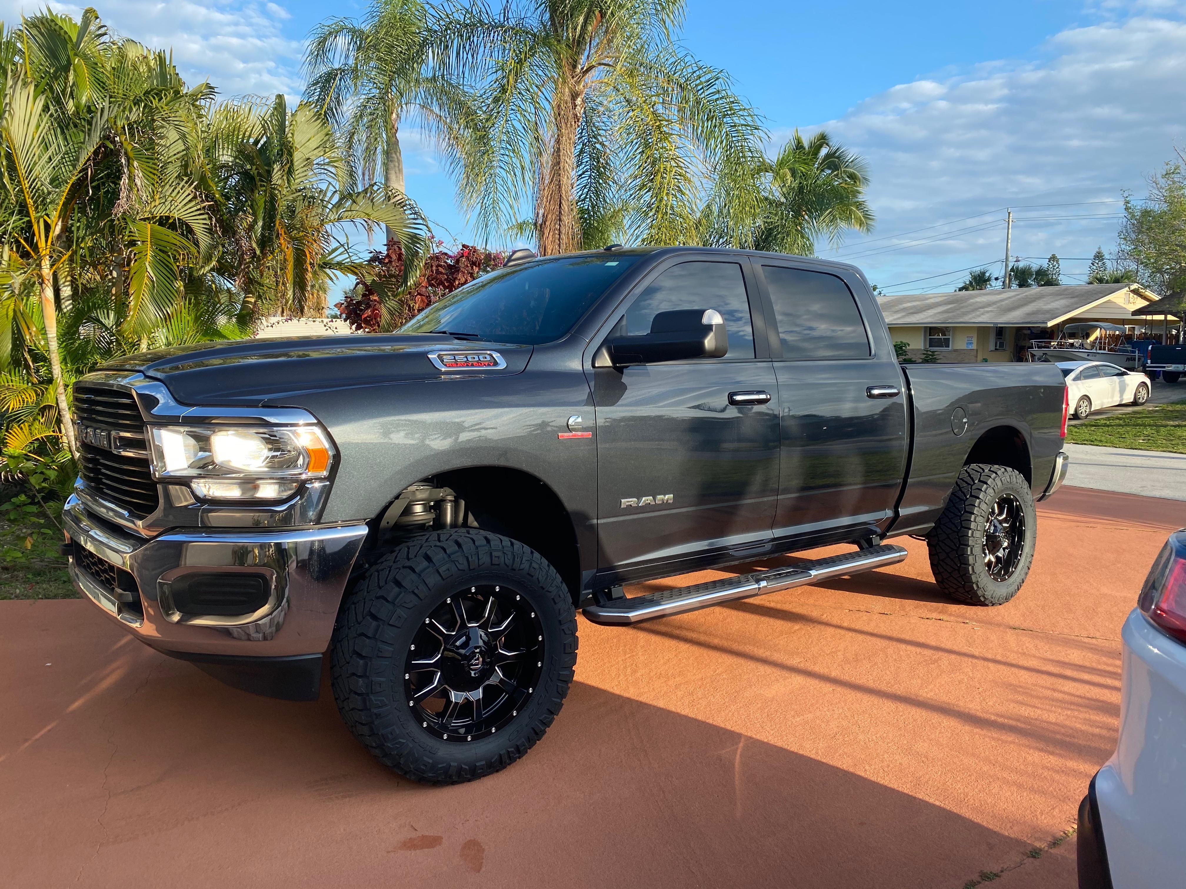

Off road truck
My rake changed by about half an inch. It was 2.5 before now 2.0. The newer kit makes it closer to level. I am guessing by about half an inch. Some with a regular truck are doing off road springs just in the front with the lift for a more level look. I have the ORP springs all the way around.
Atrestes1,
Your truck looks great, I’m looking to achieve the same lift on my truck.
Do you know the part # for your Mopar Lift? I want to add ORG springs (all 4) to my Mopar lift... I’m hearing that it might not work in the rear as the springs are to long for the fox shock that came with my lift. Are there different Mopar lifts for those with the ORG?

Dont know the part number but it's the genuine updated Mopar lift and it works on my truck.
