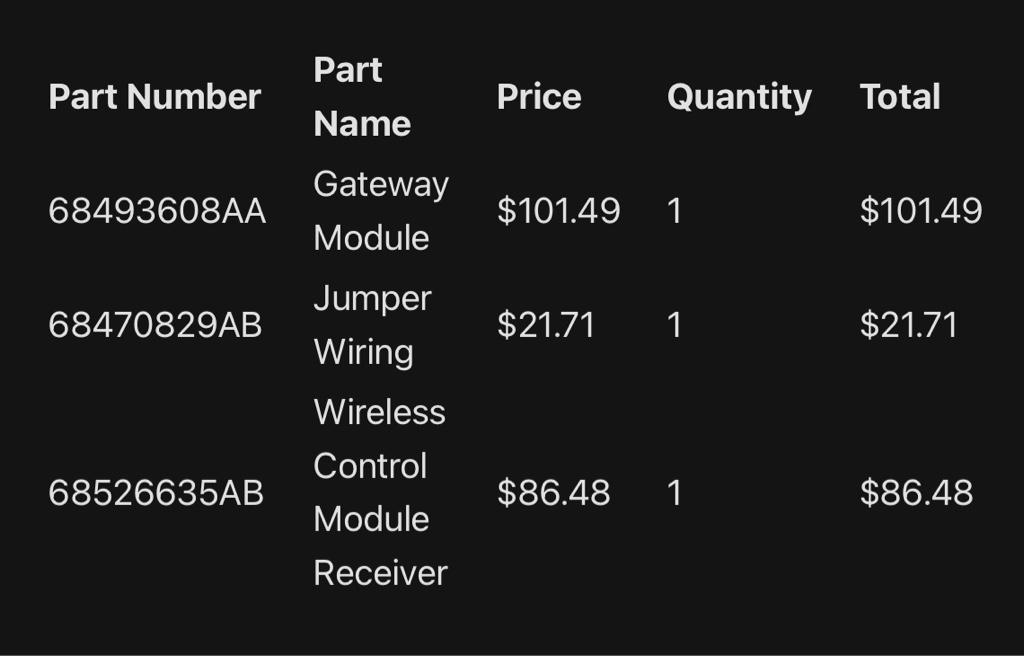

I ordered the TTPMS stuff from MoparParts on 9/5/24. I already got the custom cable from Jimmy07. There’s been no update on the order. Just curious what others experience has been.
Disregard after contacting them the replied with the tracking number. Good news, the parts are getting delivered today.
