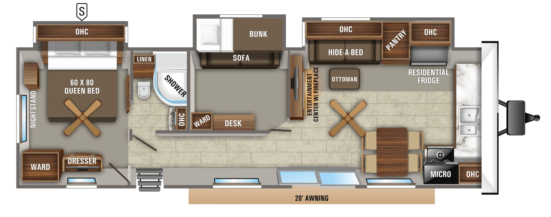

If I were you I would be looking at trailers with a GVWR of 7500 or less. Or a trailer that you will not load past 7500 lbs. This way you can have a 750-900 lb tongue weight. This will keep you in the required 10-15% of trailer GVWR.
Now remember that 750-900 tongue weight is without a WDH. So if you are at 750 tongue weight then add WDH (let’s says 100lbs) now you are at 850 lbs. the max tongue weight you can have is 900 lbs based off your 650 lbs of passenger and gear.
Load capacity - 1550
Passengers and gear - 650 (based off your assessment)
Max available Tongue weight - 900 (this can change if your above number increases or decreases)
