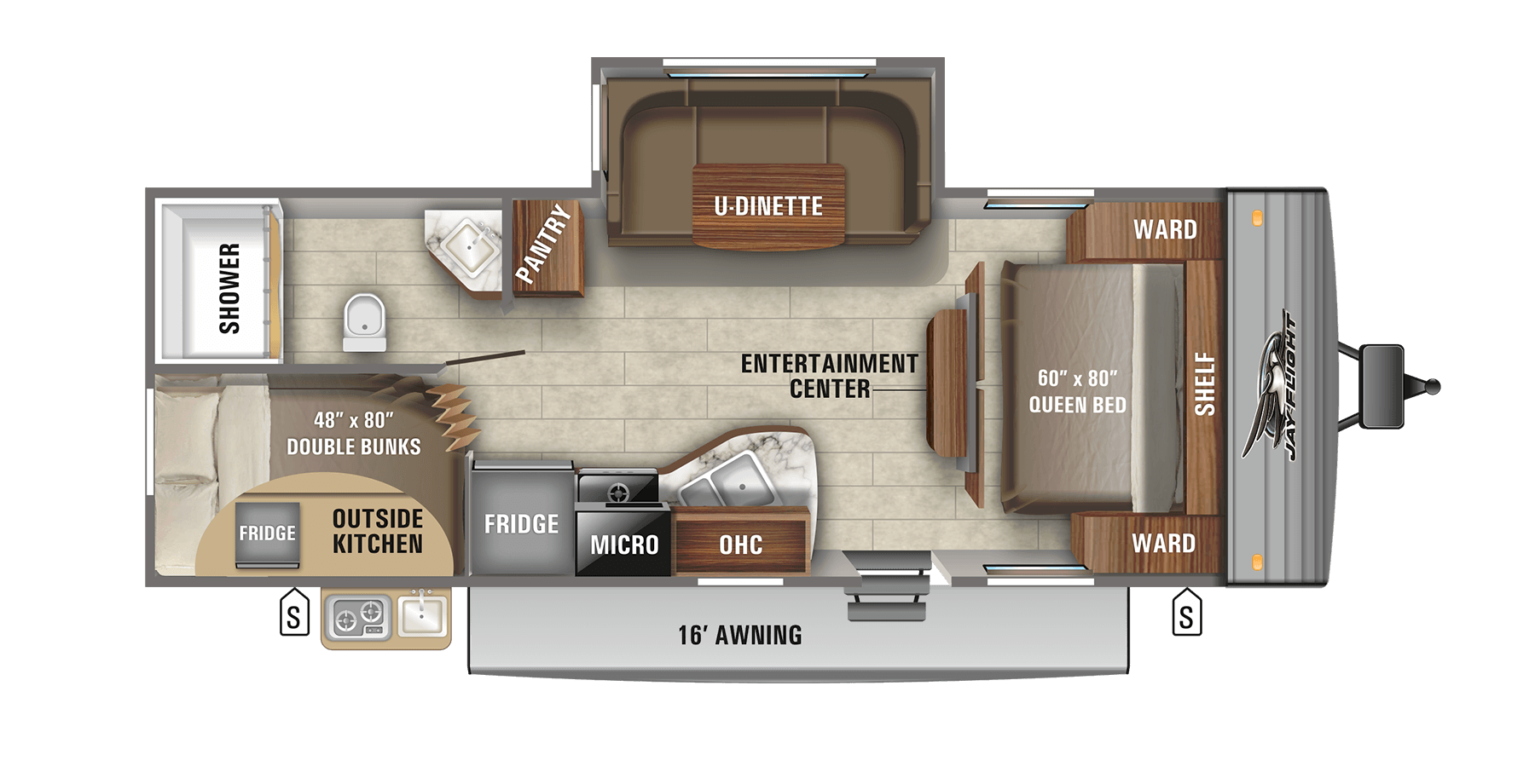

I am looking at more brands and models. My question, is it more important to find a TT with less hitch weight for the payload part of things, or the shipping wight or dry weight number? I found this one, but the hitch weight is high.
So, should I be looking for a rear bedroom layout, or rear BH layout?
