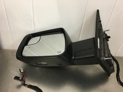

Im in a similar situation here. 2019 Limited with tow mirrors, love the look of them. BUT HATE THE FACT THEY DONT HAVE SURROUND VIEW. drives me nuts.
Im about to order a pair of the NON-tow mirrors used on ebay. all i care about is having the surround camera view for my limited..
Would this mirror... 68276511
Work with this this box... 68319955AD
I was going to order the parts below... Just want to confirm they play nice with surround view mirrors..
Window Switch with folding mirror Part # 68262252AC $80.74
Driver Door Module Part # 68319955AD
Passenger Door Module Part # 68319954AD
Also i have alpha OBD etc, is there a DIY on what i need to do to enable the surround camera veiw to work on the 12" screen once everythings intsalled?
Thanks
