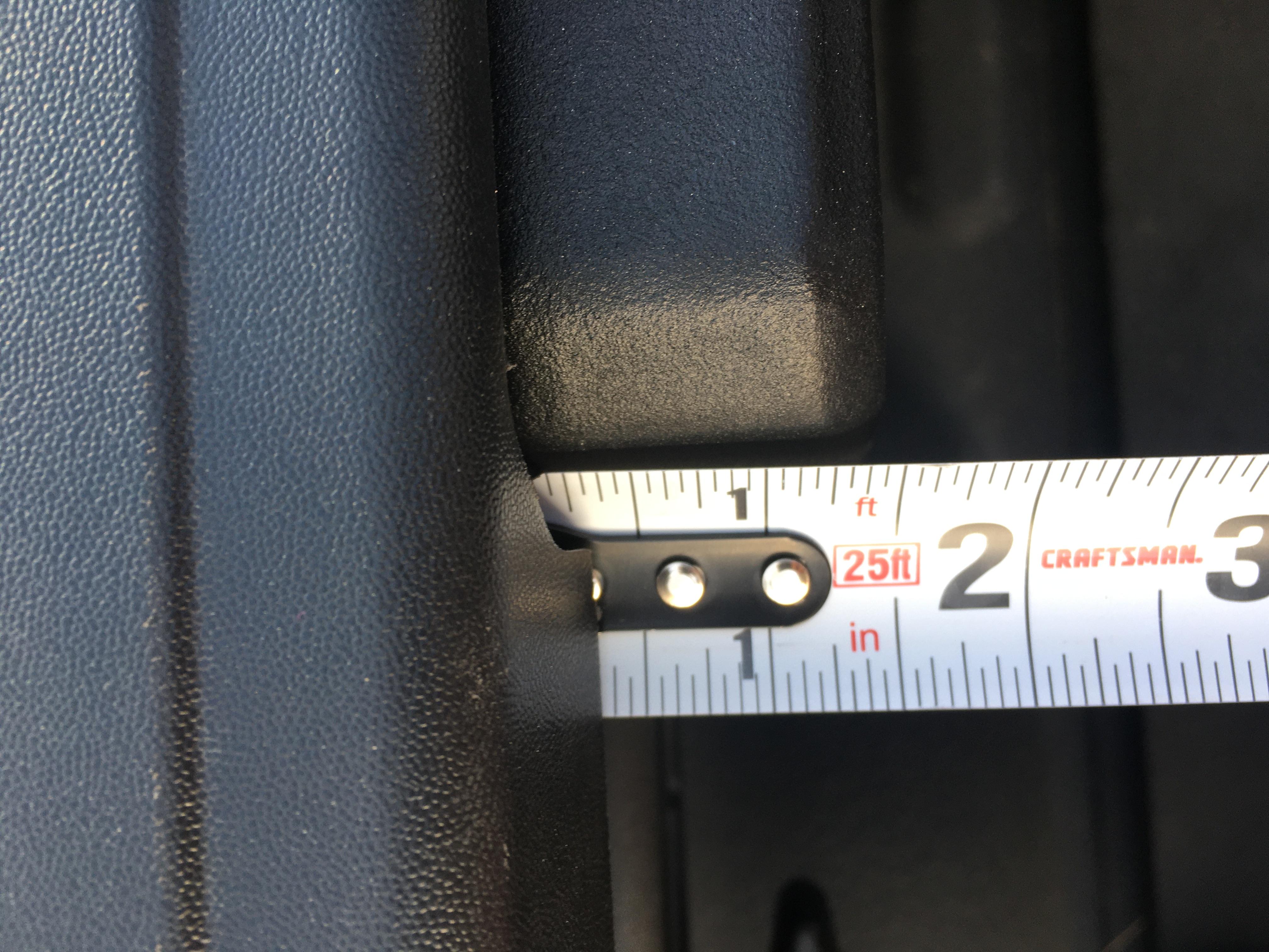

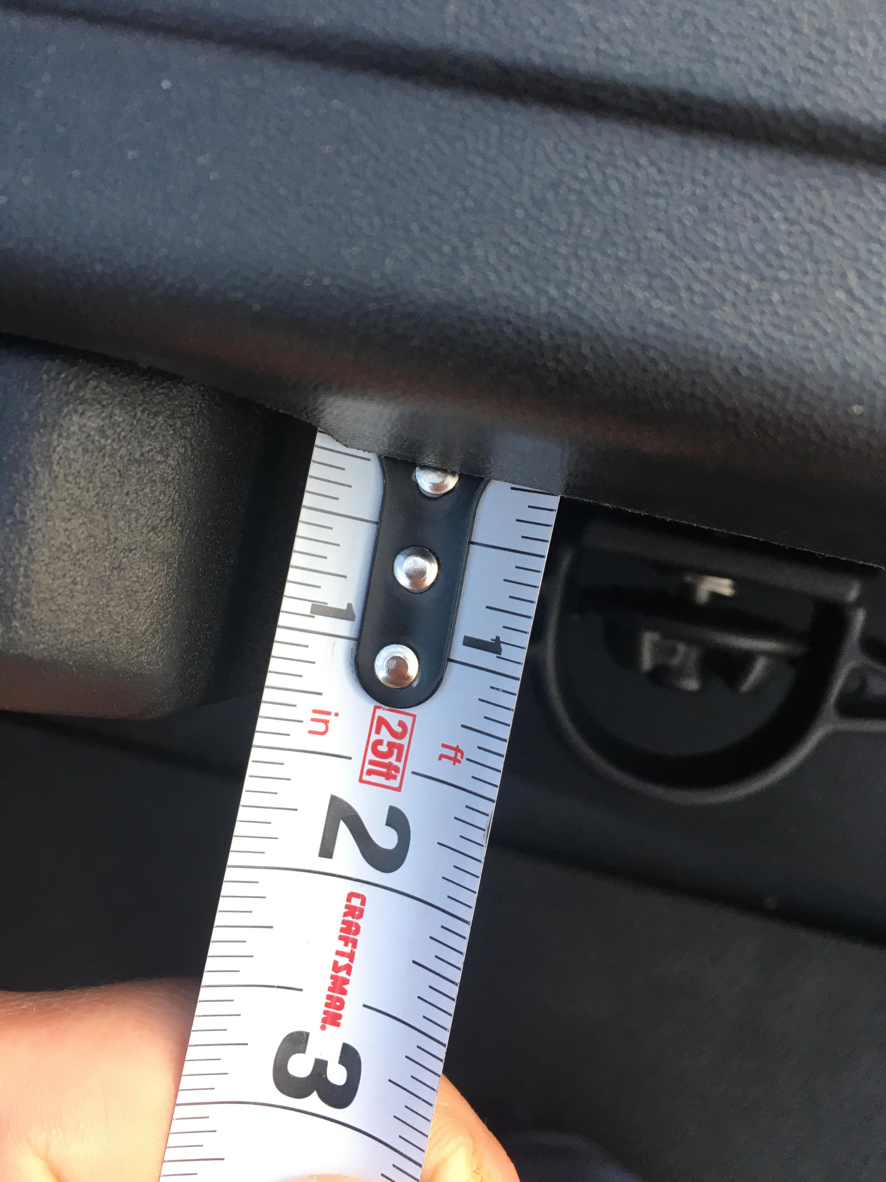

Has anyone tried mounting the flush fit tonneau rails behind the righton brackets? If the righton brackets are skinner now, believe down to 2" from 3", would this be possible? Thinking that if you drill holes in the tonneau rail where the righton bracket holes are that it would fit flush on bed rails and still have your corner bracing and the width would be correct for a flush fit tonneau. Anybody else think this could be a possibility??
I was wondering the same thing.
I also looked and the plastic takes up room. It looks like if the righton bracket is 3/8in, it would only be sticking out 1/8in because of the plastic.
Here is what I mean. One side is a bit less than 2/8in.
