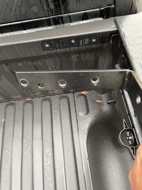

Yeah so my bracket looks different. On the passenger side, where you have 3 holes against the cab, my bracket has 4 and the large hole that’s for the bolt that’a supposed to cover the painted bolt, it’s alignment is for the holes against the cab. So I took the painted bolt out, and put in the flat screws and it still did not sit as flush as the driver side.
I’m assuming this one is the passenger side bracket. Could you post a full pic of the bracket. I’m sure @rightonbracket will make it right if it’s the wrong bracket. Just asking here to clarify, did you place the 4 holes over the side wall holes and the 3 holes over the cab side? Will the holes line up? Just from the looks of this picture it seems that it should work. Again not trying to be a smart a$$ here, I’m just asking.
Yeah I thought I uploaded them all but here is the other side of the bracket. I’m holding it the only way it aligns.
If the holes align then it’s the correct bracket. Just start with the cab side bolts first and it’ll pull it forward over the painted bolt/washer. Basically the brackets are mirror images of each.
They aren’t, that’s my point. The larger hole on the driver side, fits over the painted bolt. So that’s 4 holes and then the 3 holes on the cab. For the passenger side, both sides have 4 bolts (unlike the driver side) and the larger hole for the painted bolt, doesn’t align for the painted bolt. Just wondering if I got a wrong bracket. If you got two backets, with 7 holes each then I got a wrong bracket.
You did. They should be mirror images. Get with @rightonbracket and I’m sure they’ll correct it. They should see these as I’ve tagged them.
They do screw in, I can get them lined up and bolted in, but when I do, it sticks out pretty far.
I’m assuming further out than the drivers side bracket? Could be an early edition bracket that got thrown in by mistake. They do stick out some as they need the strength. Let me run outside and take a couple pics of mine installed. BRB 😀🏃🏼🏃🏻🏃🏽🏃🏾🏃🏿
