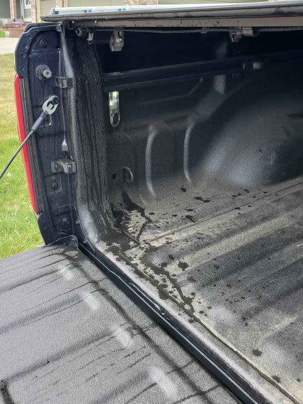

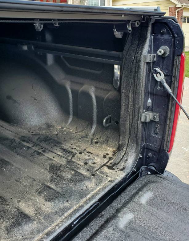

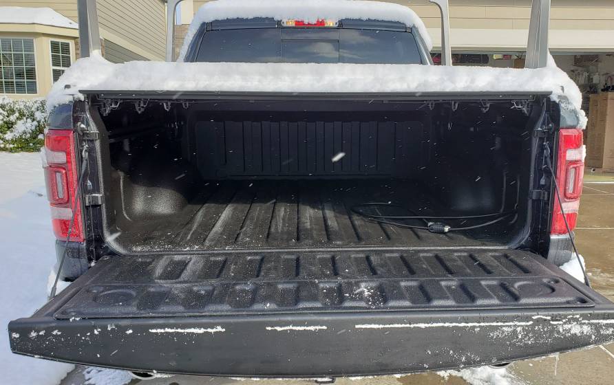

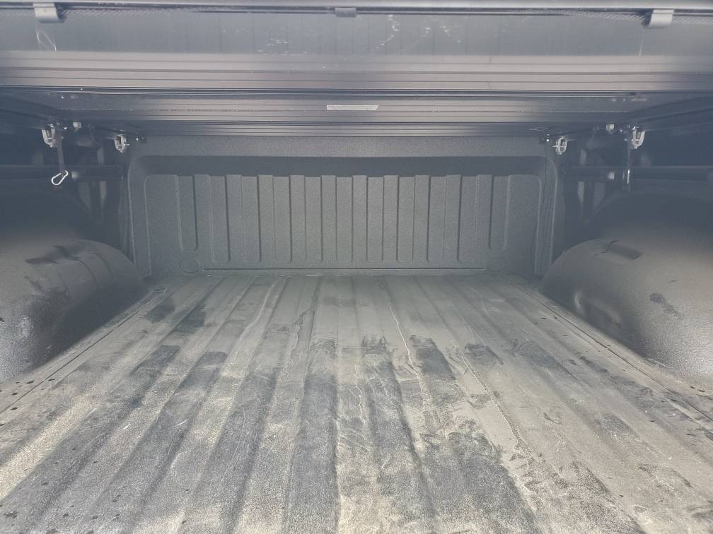

I decided to take mine to the carwash and high pressure wash around the cover edges. Wand was about a foot away so it was pretty direct.
It didn't spray under the seal but it did find places to leak in at the front and down the sides a bit. Knew it would get in the back but was impressed it didn't go in above the tailgate.
I don't see leaks during normal rain storms or snow. It has leaks for sure but am pleased with how mine keeps a lot of the water out.
Here a few pics. Need to take cover off and wash bed...ha.
