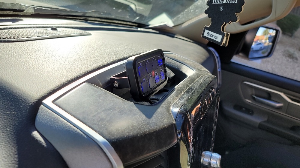

Here is how I handled the mounting of switches. B382102D-FDC5-4C34-A507-D6D93DBA0AF8.jpeg
I 3D modeled a switch pro mount that uses the CD player as a mount.

Finally found a solution for switches that I am happy with! Did not use the CD player at all so I removed it, cut a piece of black ABS to fit into the hole and wired up a push button switch.
What switch is that?
That's how I did mine. I found that spot to be useless for anything else.

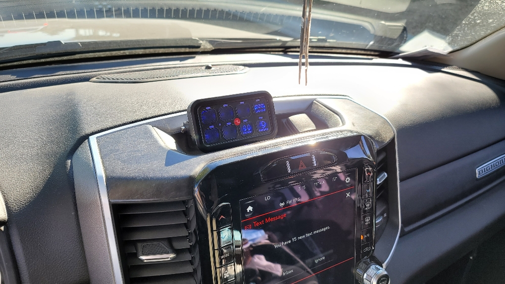

Just finished setting up my swithpros. I mounted the switch panel to the proclip cell phone mount that clips onto the vent and ran the wire in behind the center screen. No drilling any dash panels so all is reversible.

update...
