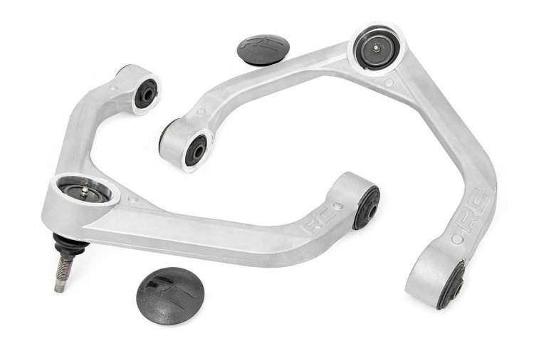

If you going with 3" of lift in the front I would go with these UCA's from RC (link below) for your 4th gen. I actually used these on my 5th gen and they work great even though they are for a 4th gen.
I don't know if the new 5th gen 2" mopar UCAs will fit on a 4th gen but if you are going with 3" of lift in front then I would recommend something else anyways. My mopar lift UCA ball joints were about maxed out at 3" of lift which is why I switched.

I had the 2" mopar lift installed along with ORP springs in the front which essentially netted me 3" of lift in the front and I was a little concerned about the UCA angle especially when towing or with any kind of payload. You would probably be ok using them if you don't do any kind of off roading or towing aka pavement queen. Here is a pic of the Mopar UCA angle after install...not good in my opinion.View attachment 79233
I ended up installing RC UCAs...pic below, much better angle.

No issues whatsoever, alignment is great, tires are wearing perfect and steering overall feels like stock. I've been running them for about 16k miles.
