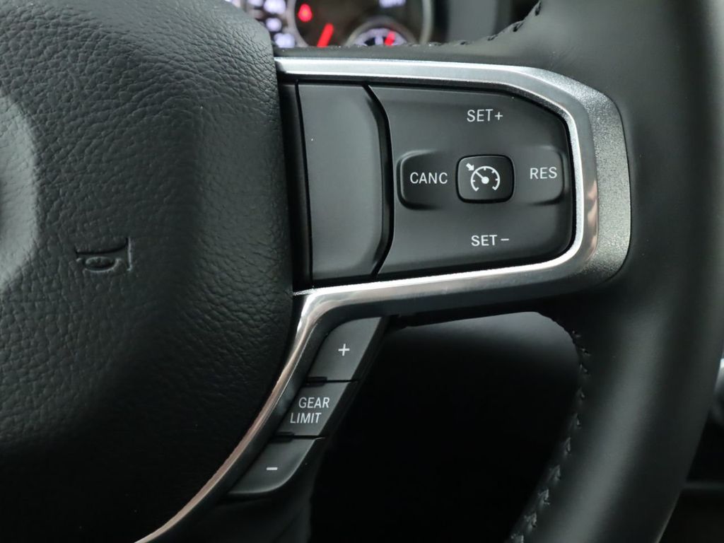

Yea, Yea. Still, I question anyone who says the 3.92 is better on the highway. Set your gear limit to 7 and you basically have the same truck, at highway speeds.
