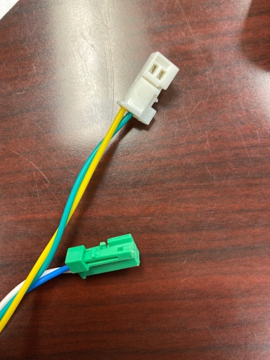

Need help installing mine into a 2019 3500. Where do these two plug into at?
I'm guessing the 3500 module has those inputs, but the TAZER DT does not.
