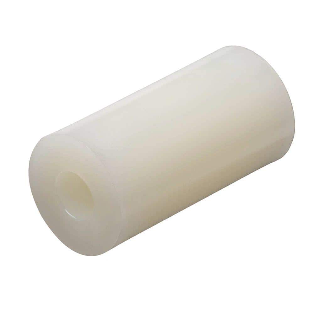

I think they should sell them with the spacers. How long did you make the spacers?
1/2 spacers on outside clips and 1/4 spacers on inside clips. I used 2 of each spacer to mount bar.
Pretty sure these are the ones I used but either way they should work
