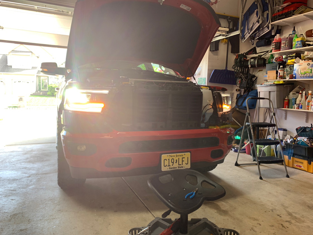

so I finally drove at night with these lights. I can confirm that the headlight revolution led headlight bulbs for the halogen assemblies are brighter than these OEM led headlights. Sucks they are now sitting in the garage.

The LED assemblies are still 10x brighter than the halogen assemblies. Everything is very well lit. The halogen assemblies with the headlight revolution bulbs are almost too bright because you end up blinding everyone else going the opposite direction as you.

Have you checked the adjustment on your headlights? There is a good chance they are set too high especially if you’ve done a lift or level.

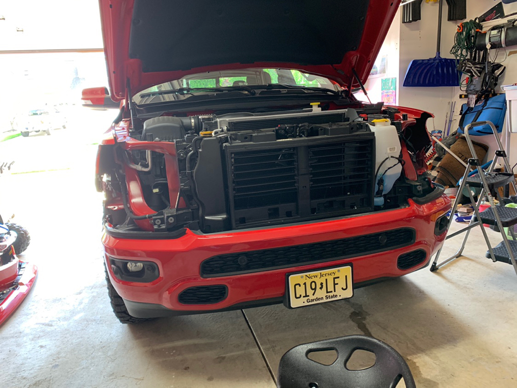

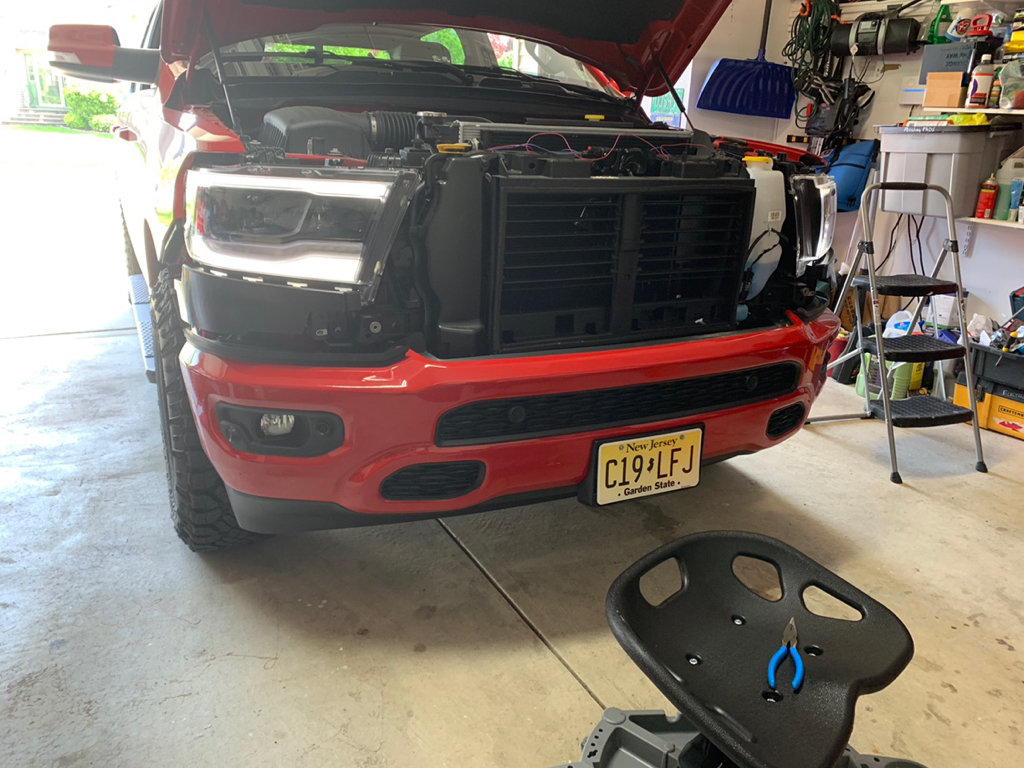

Yea I redid the headlight alignment at work. (I’m a Auto-tech). They are still bright no doubt about it. But that headlight revolution bulb is brighter. But I still see a lot more clear than the stock halogen bulbs and assembly. Still very happy with it. Currently having a issue where the high beam on one side is constantly on with the low beams. I’m gonna swap the adapters around and hope that it switches to the other side so I could just get a new adaptor. I don’t feel like taking everything apart again
