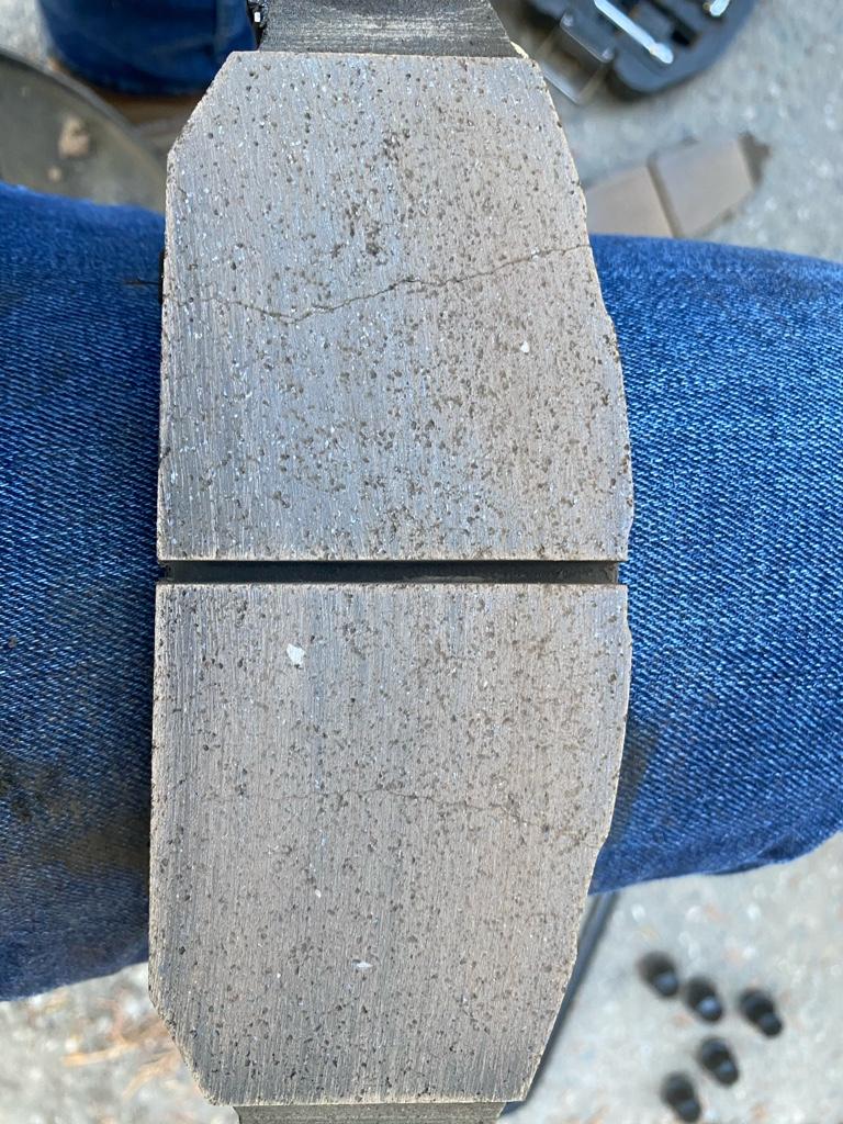

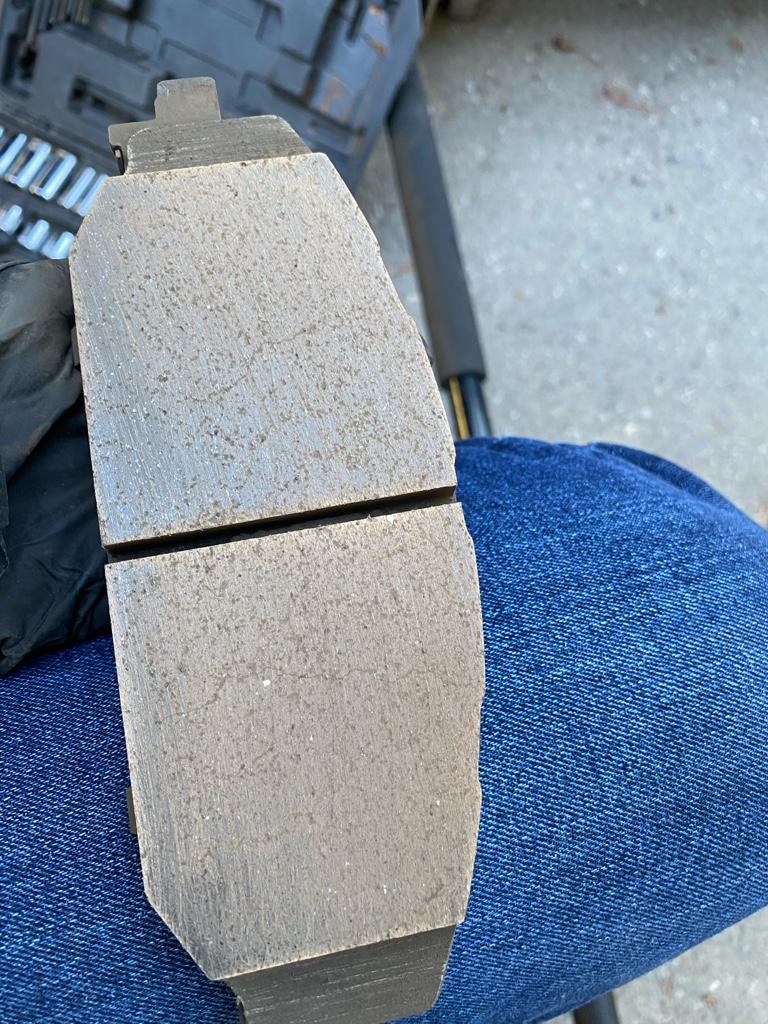

As you could guess, after I got home from getting the driver’s side mirror replaced the passenger’s side started doing the same thing. So I dropped off the truck today and mentioned the TSB to them and said they’d check it out. I mean, the truck is there might as well. But once they take care of that mirror, if they come up with nothing, I’m buying that part and doing that together with the new brake pads All the good news of it working gives me hope. Because in the mornings or even after sitting for a few hours, when pulling out of a parking lot or something and hitting the brakes slowly, it does make that weird humming/squeal noise. Thanks for your guy’s input and info with that part #

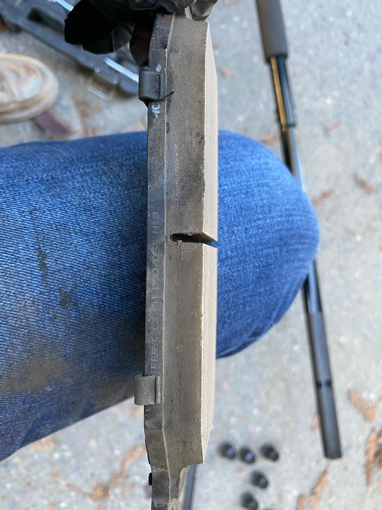

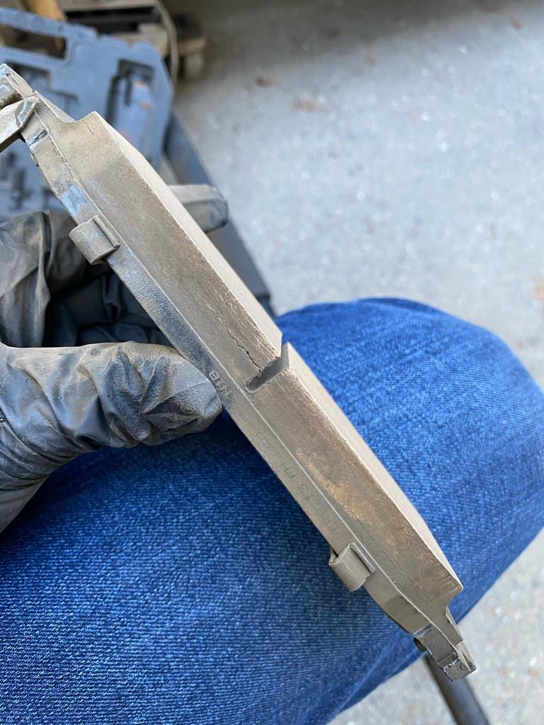

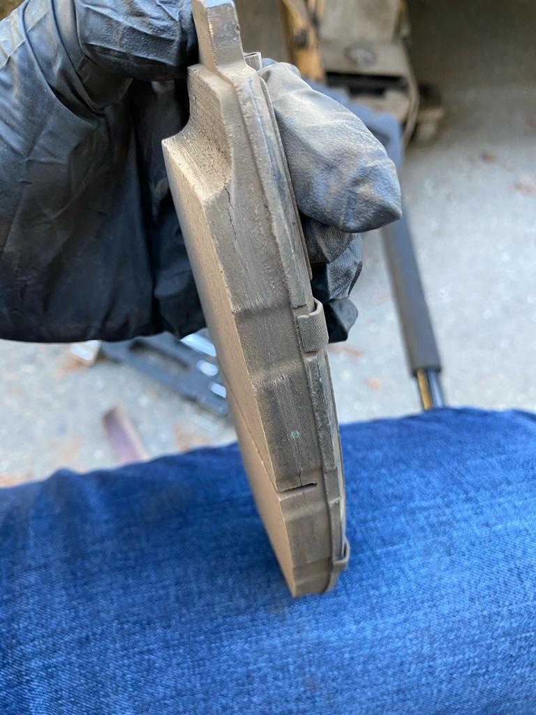

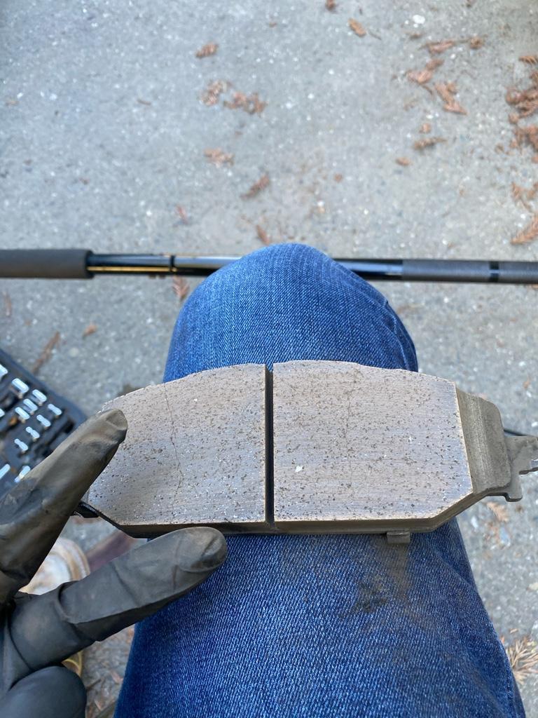

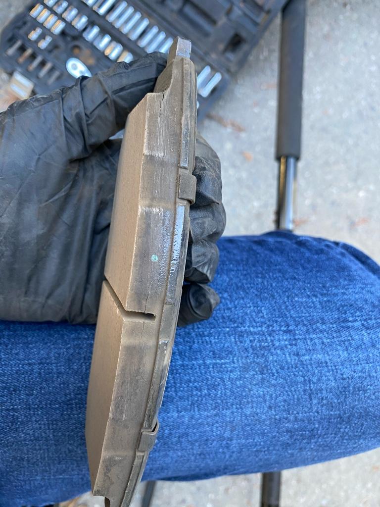

Well its been a month since I installed the moan kit (a little more involved than I assumed it would be). Bottom line is, it unfortunately did not solve the high pitch sound I occasionally hear my truck make while lightly tapping the brakes above 40MPH+.
Since it only does the squeal occasionally when the brakes are warm, my next attempt to fix this issue will be to remove the existing brake pads, clean the rotor and pad surfaces, apply some brake pad grease on all moving parts and cross my finger that's all it needed.
If that doesn't work, I'll just have to live with it until they're worn out. When it is time to replace, I will definitely look into replacing the discs and pads (probably go with an aftermarket ceramic pads kit like powerstop).
dang sorry to hear it didn't resolve your noise. this is still my favorite/best mod yet
