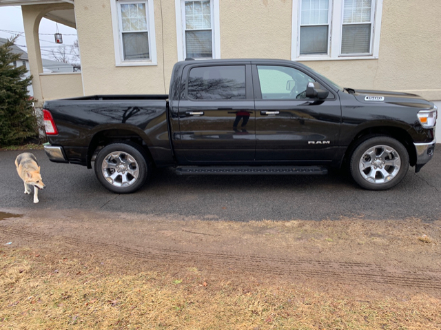

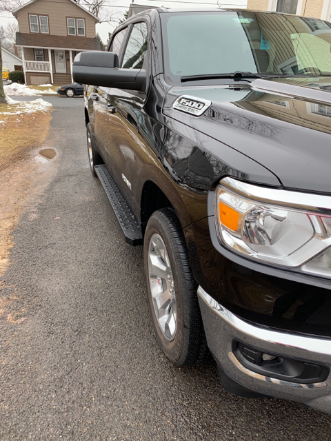

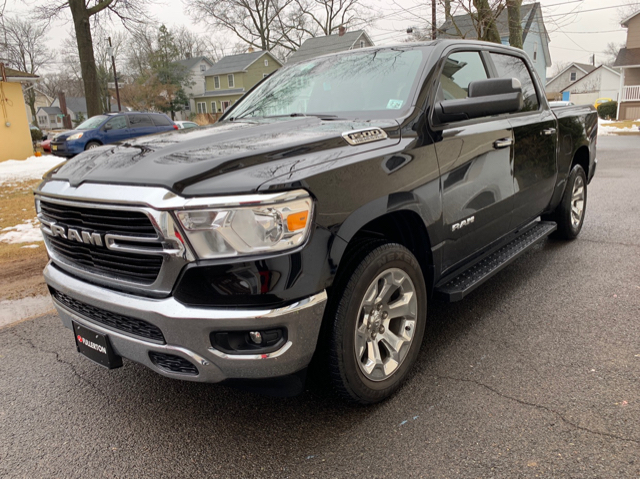

I got the Ram Off road edition side steps installed. I'm gonna be honest, I'm not liking the look at all. I know they won't stay on, it looks too SUV style to me. Gonna have to find a tubular running boardIMG_20190302_1405429.jpgIMG_20190302_1405231.jpg
Thanks schoon85 for taking the additional pics!!!!
Sweet!!! That first pic's the side pic I was looking for to view how they taper off at the ends!!!
I like them!!!
