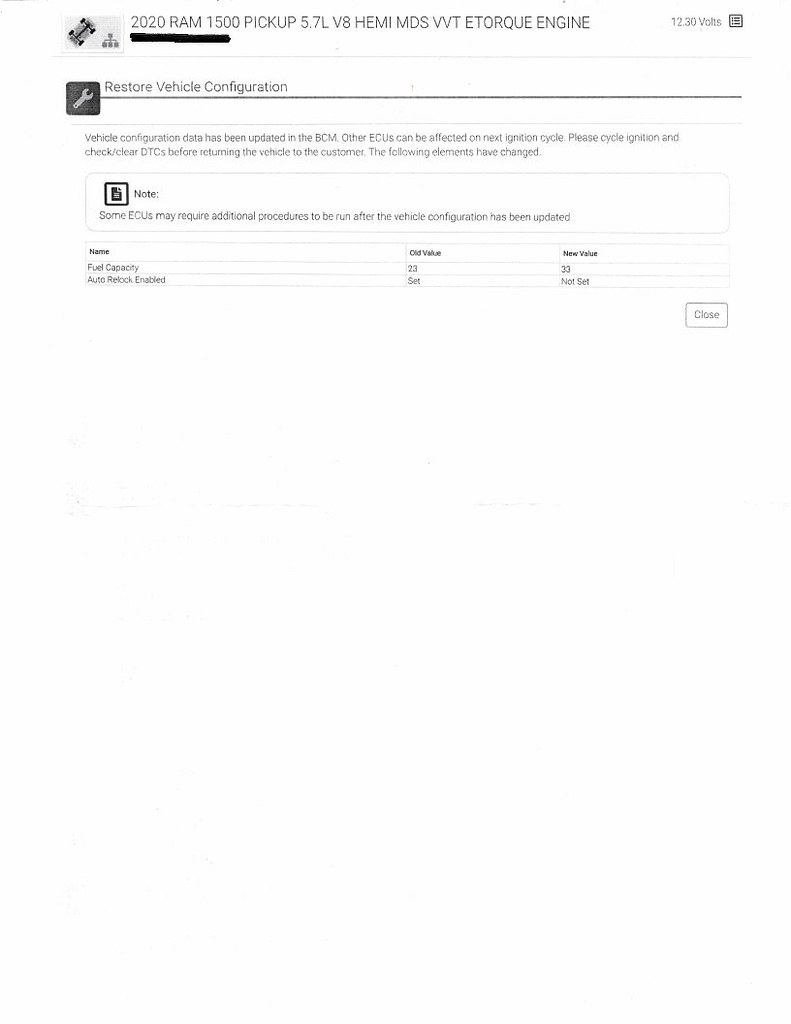

As a requested here's a picture of what my dealer gave me when the recalibration was done. The blacked out spot is where your VIN should be. I'm not sure what the "Auto Relock" part is, I haven't been able to get an answer from my dealer about that. It doesn't seemed to have changed any lock settings that I'm aware of (so far).
After the dealer recalibrates your DTE, this is what your proof of the DTE fix should look like.

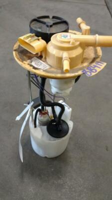

For anybody that has done the swap, does this fuel pump look to be complete? Thought about going with a used one if it's worth it.

Ah ok, yeah you are going to need a fuel pump too then. Makes sense, I haven't done it to my truck yet so I'm no help. Doesn't look too hard though, I just started to order parts.
