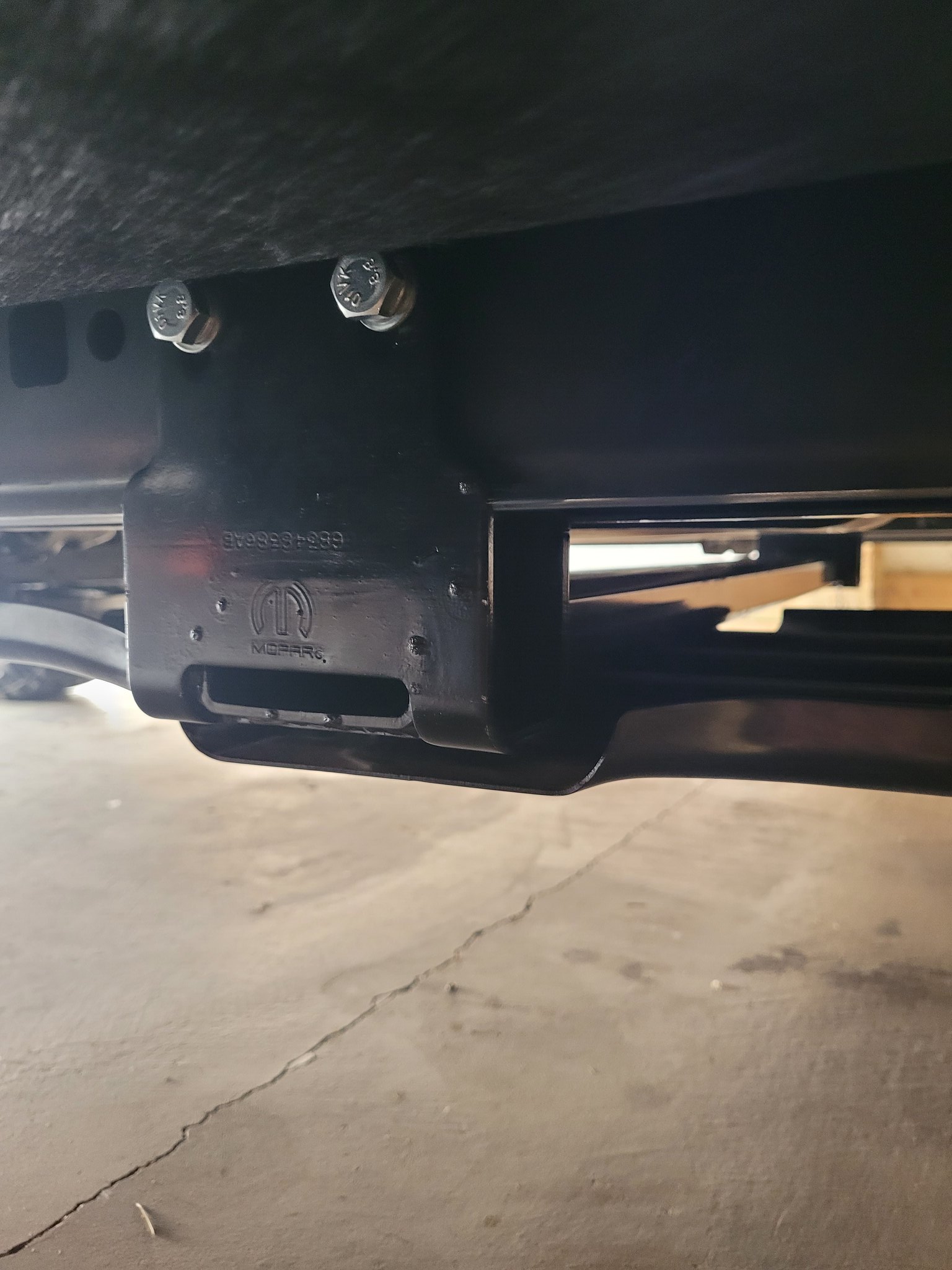

Actually, I recently discovered there is a crossmember that can be used and would give you what you are looking for. It is #22 in the diagram below. You can bolt this up without the longer skid plate and accomplish what you want but it is the crossmember for the longer skid plate to give it strength up front. The part number for the 33 gallon skid plate is 52029964AD, the crossmember part number is 68348386AB and the part number for the four hex nut/retaining clips to hold up the crossmember is 06508646AA. You will also need 4 M10x1.50 bolts to bolt the crossmember to the frame (I forget what length I bought). If you are bolting the skid plate to the crossmember you will need 2 more M10x1.50 bolts. Once in place this crossmember is plenty strong enough to be used to add support for the tank (it sits about 1" below the tank).
Thank you for this info, helped me to understand what is the idea behind long fuel tank skid plate for 33 gallon tank.
I've upgraded from short skid plate to a long one, and I was surprised how front part bends easily. Protects the tank no doubt, but it will bend if you apply truck weigh on it during rock crawling. Now I see that just skid plate is not enough - you need a crossmember to add strength in the front of the skid. It it not needed for a short skid plate.
Here's some extra info on the 33 gallon skid plate if you need it or want it. I have a Rebel, so I decided to get the longer skid plate. Overall I'm into this $1360. It's a bit more expensive swap for my truck, because I have the skid plate (Rebel) and went from a 23 gallon tank. I still need to fix the DTE issue. That's been a work in progress with my dealer, which if they can't resolve here within the next month I'll be using Alpha OBD. Just trying to do the FULL installation with them.
1 - 52029964AD - 33 gallon skid plate
1 - 68348386AB - Crossmember for skid plate
There is also 4 nuts and retainers you need for the cross member too, but my dealer didn't charge me for them or list them on my paperwork.
Here's a picture of the skid plate crossmember:

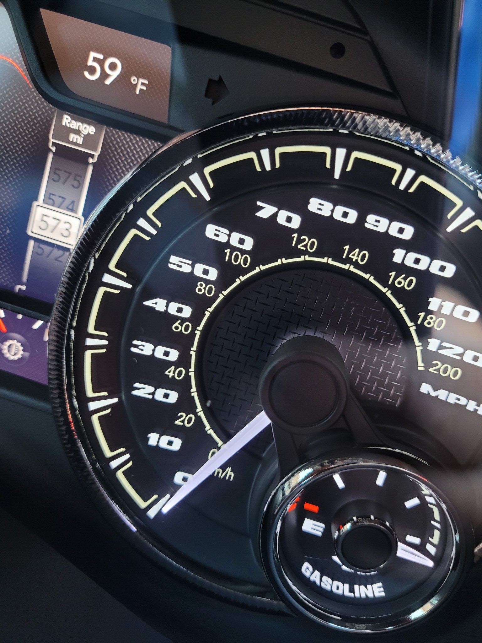

Dealer DTE update success!
Steps your dealer must do to get the DTE to work:
1. Your dealers MUST involve Ram Corporate (FCA/Stellantis). Ram Corporate MUST remove the old tank value 23/26 gallon and add the new 33 gallon tank to your specific VIN. This is called your Vehicle Configuration data.
2. Once Ram Corporate adds the new data, your dealer needs to do a "Restore Vehicle Configuration". This process is very simple. My dealer did it in less than 5 minutes. Once that is done, my dealer printed me off a "Restore Vehicle Configuration" page that shows Fuel Capacity - Old Value 23 - New Value 33.
You will likely get resistance from Ram. They don't seem to want dealers to do this upgrade. Seems like some are trying to claim false warranty, in an attempt to get this upgrade done for free or cheaper. Also sounds like Ram is fearful customers aren't putting all the correct parts in. Just tossing in the tank for example and not putting in a new pump (23 gallon has different pump). Their could be other reasons as well. Just know your dealer has to get Ram to make this change. If they do not, your dealer cannot do anything.
The change was instant. First fill up, averaging 17.6mpg at the time.
