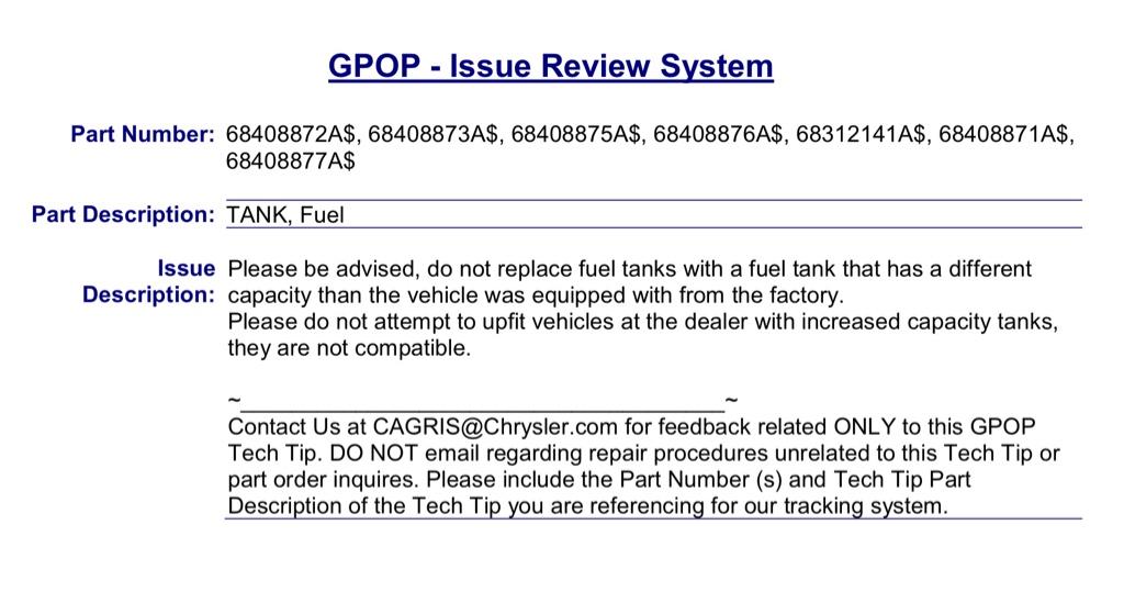

Does anyone know why there is a TSB stating not to upgrade fuel tanks?
Interesting for sure. I’m going to assume it’s because folks at the dealer probably don’t know that Evap canister isn’t the same. Same goes with fuel pump based on part numbers from 23 to 33 gal. Might be causing other issues. Below TSB is pretty generic but lists a bunch of part numbers that all seem to be fuel tanks. All seem to be 33gal tanks.
Could also be for liability reasons.
