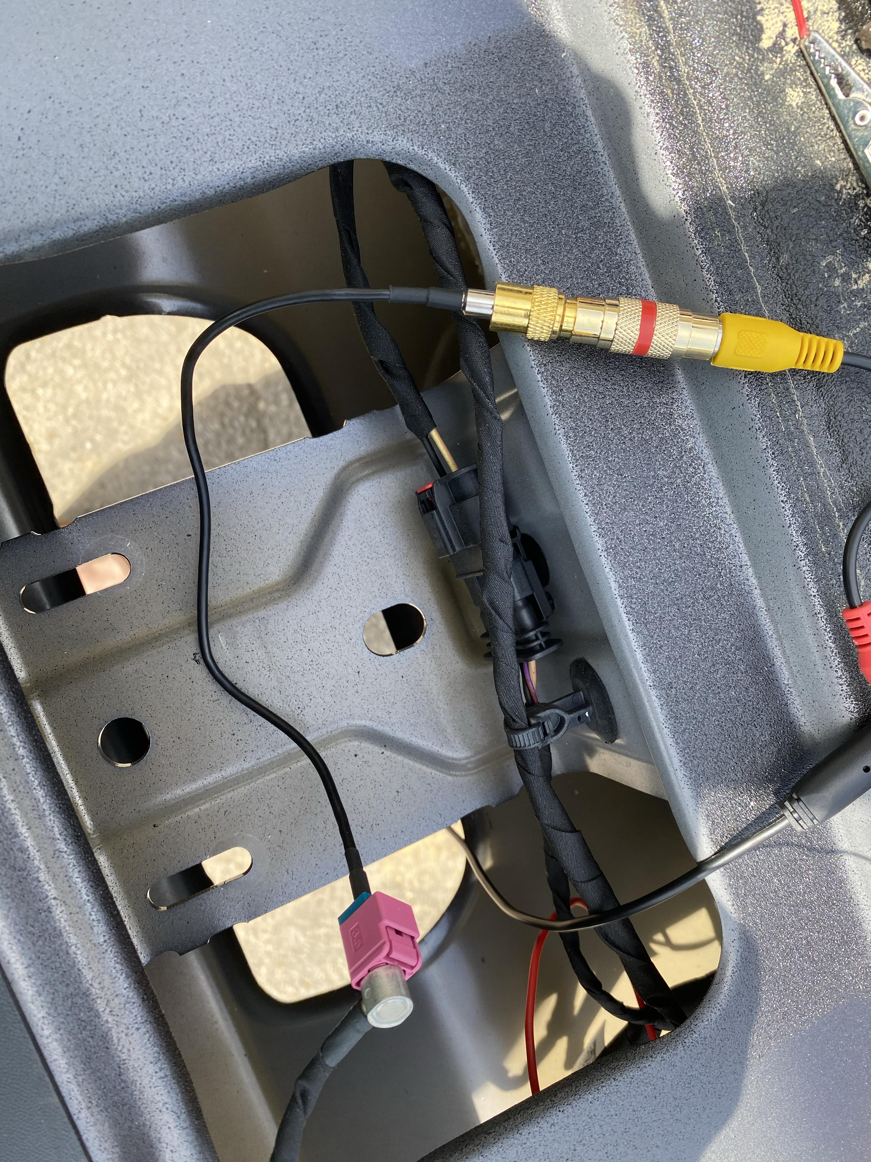

I removed the OEM camera. In its place I put in an after market camera, fit was perfect, no modification on the hole. From there I used an RCA to Fakra adapter then to the cable the OEM camera used.
Up front I used another Fakra to RCA adapter and connected that to my head unit.

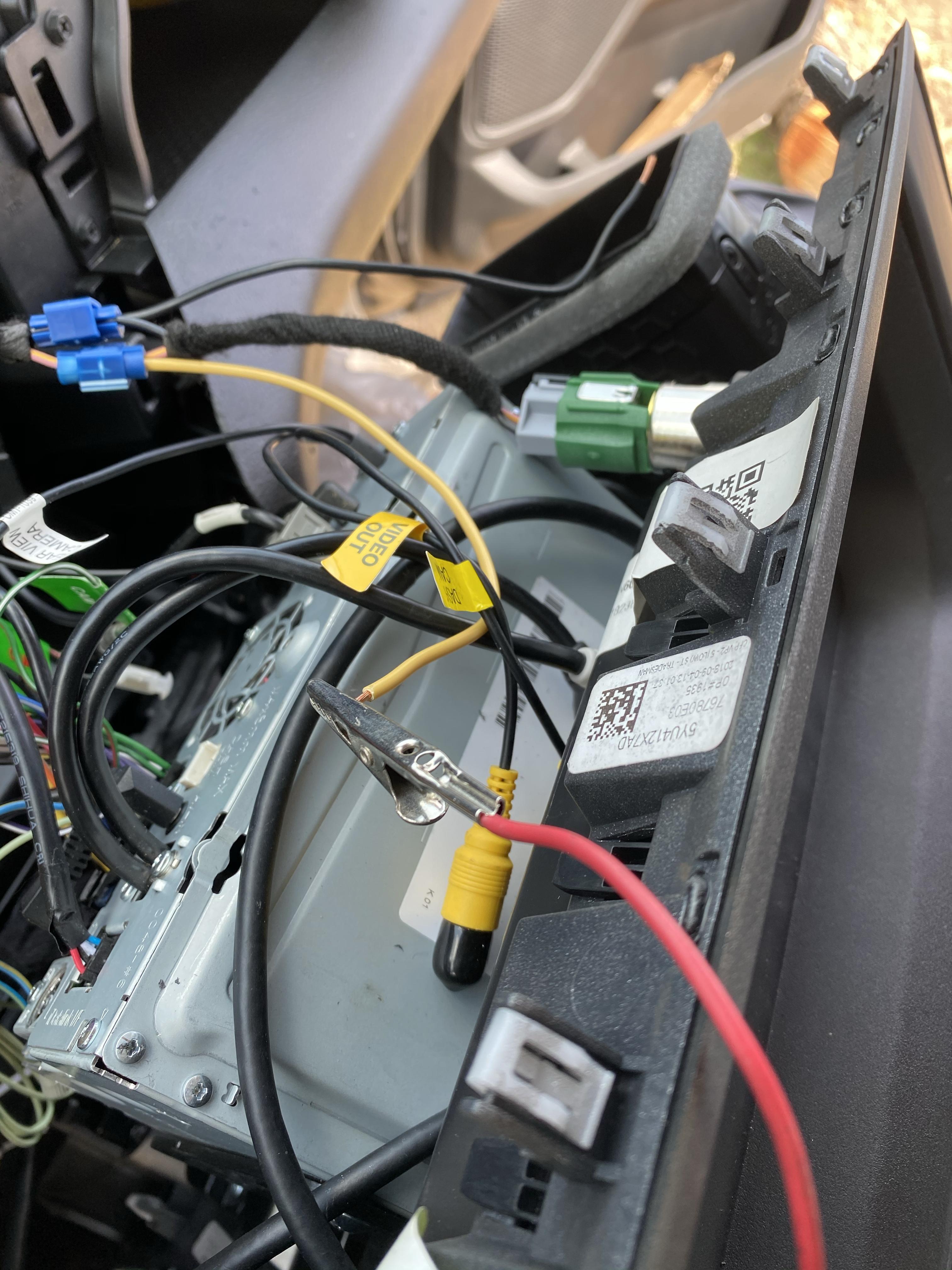

I’m under the truck wiring the camera power to the trailer harness for the 12v power. My head unit has a reverse line input so I can provide continuous power to the camera.

I use a Maestro RR unit that connects to the factory harness up front, that has a reverse sensor coming out.
Both of my Fakra adapters were female on the RCA side so I needed two male-male adapter in there as well.

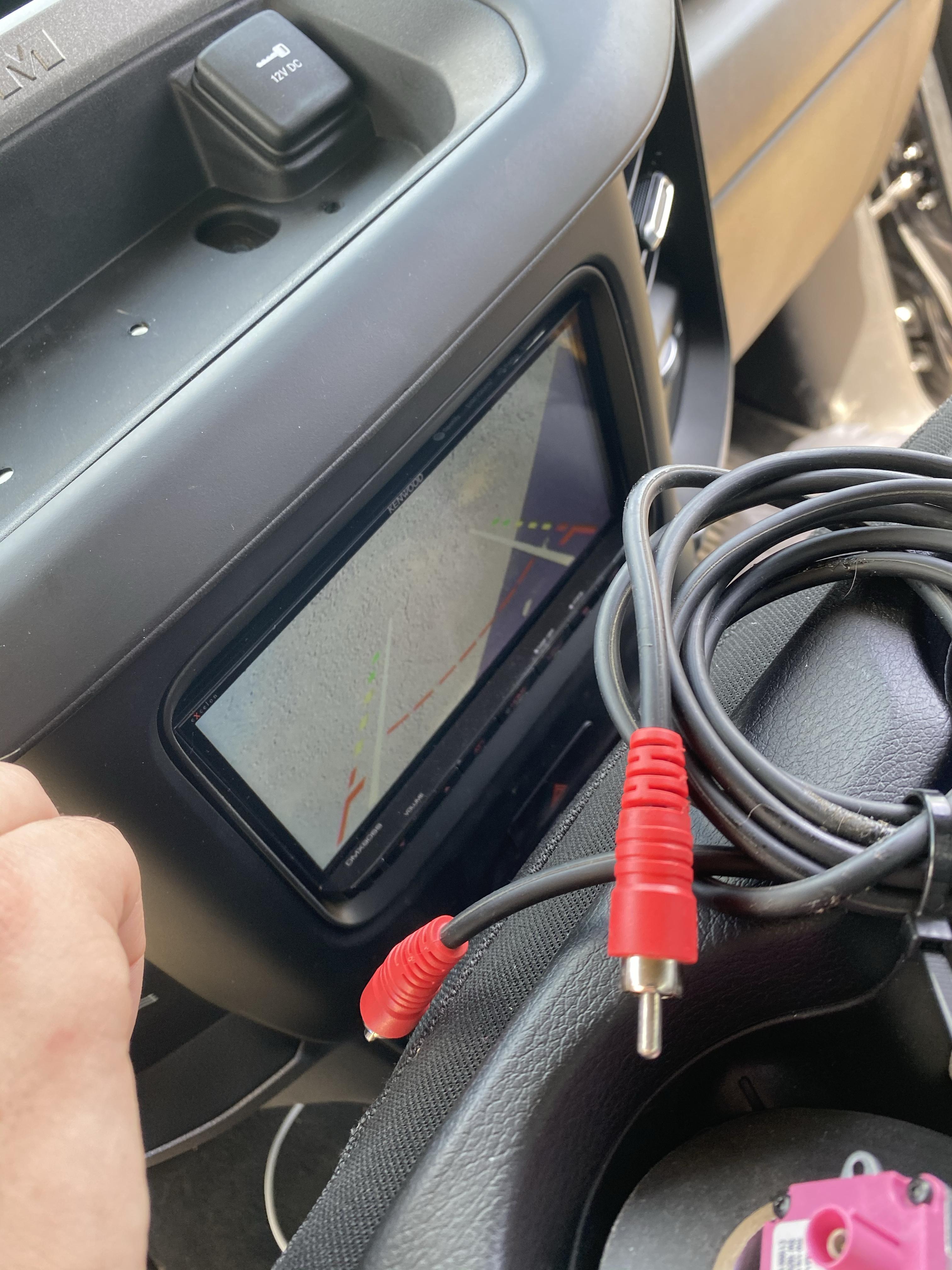

Fits just as good as the other, picture quality is a little better, better field of view.

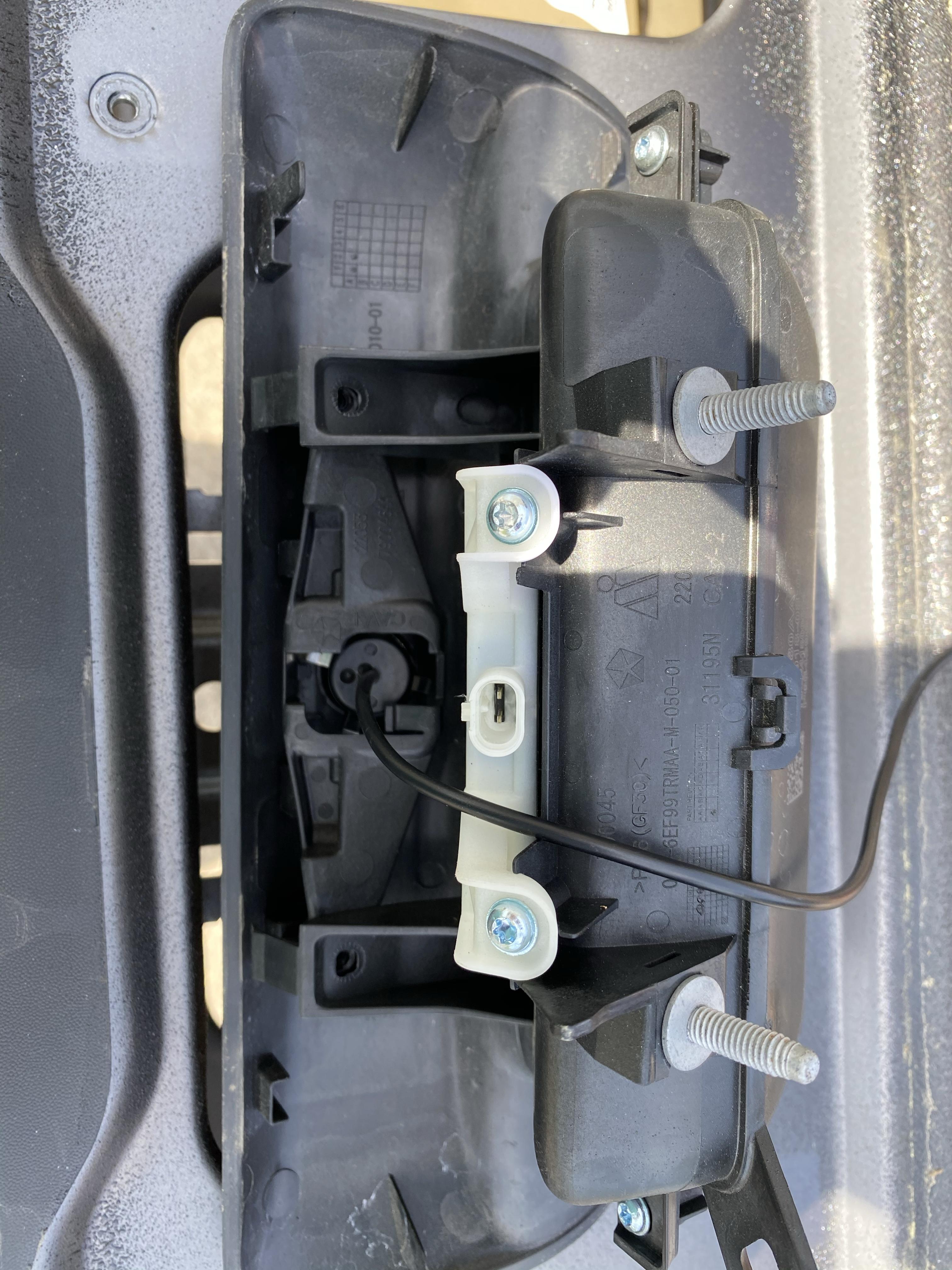

I should have taken pictures of this step:
I ran the camera wire from the tailgate handle through the tailgate following the factory wiring. Comes out the bottom of the tailgate a little right of center. Followed the factory wire still through the hole to under the bed. That comes out just left of center, a little left of the spare tire. The trailer plug wiring goes from the plug and follows along the top of the bumper to the left side of the bed.
Point being, where the camera wire comes under the bed, the trailer wire bundle is not far away, just a few inches. I just cut open the tape and tapped into the wires there. You could grab the reverse there as well.

Worked great. I the radio/truck combo didn’t show any results on the site, but the desktop app had it. Ended up being able to use the short press on the call buttons for volume control and long press for phone.
Haven’t confirmed that rear camera doesn’t work, but I’m assuming that the red connector in the factory unit is the camera feed. If that’s the case, yea, that’s still dangling in the back.
Left the usb disconnected. My head unit “does not support USB hubs” and if I left it plugged in, for some reason the ports wouldn’t power up. With it disconnected they charge the phones just fine. I installed a dedicated USB port to the left of my traction control/ tow buttons.
Getting everything back in there was a chore. It’s a full size unit so it goes in a substantial amount more than the factory unit. I ended up trimming some of the plastic brackets back to get it all to fit.
Seems to work great though. I’ll keep my eyes peeled for a camera adapter, or rig something else up. The unit has a standard RCA input, shouldn’t be too hard to figure out something.
