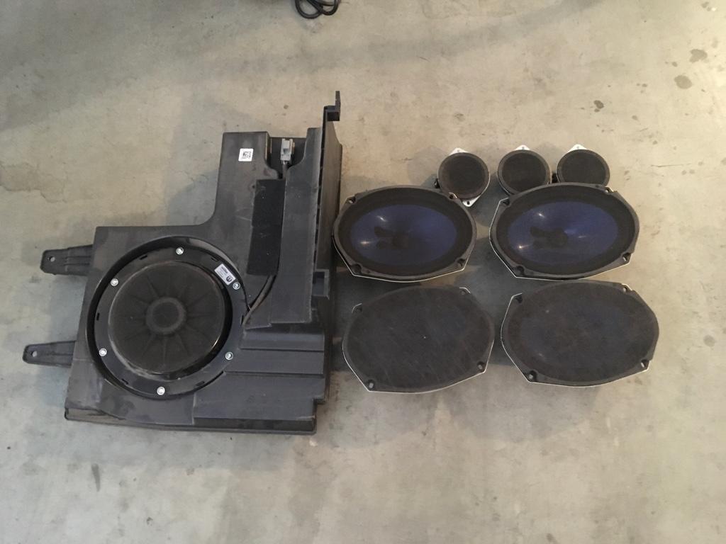

does anyone have pictures of their stock speakers from the 9 speaker plus sub option?
They are just basic 2-way generic Chinese speakers. Nothing really to look at. Completely unmarked other than "Made in China" stamped on the back.
I don’t have the speakers from the headliner out.
Here's what came out of my doors.
Not sure there's any differences between the sound systems...
