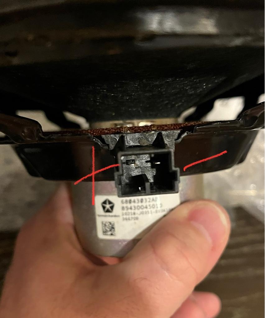

I took your post to heart and tested the polarity of the two stock speakers I already replaced. (See below picture.) Then I tore down and rebuilt the Red Wolf harnesses I have yet to install to match that polarity.
When I take the front door panels off again I will swap the harnesses I already installed and test/rebuild as necessary.
I’ll report back on whether they came backwards from the seller or not.

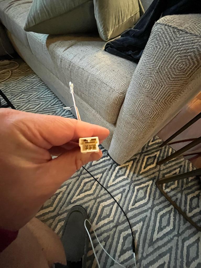

Based on a grainy picture I took before the first two harnesses went in (see below), the polarity appears to be backwards from the factory.
It may seem extremely obvious to you, but sometimes people get in the zone and don’t think about it so I’m mentioning this: after you do your swap, leave the door panels off and take it for a drive to see if your problems are gone. That way you’re not uninstalling and installing door panels a bunch of times with those clips that are easily broken. (Ask how I know, lol)
