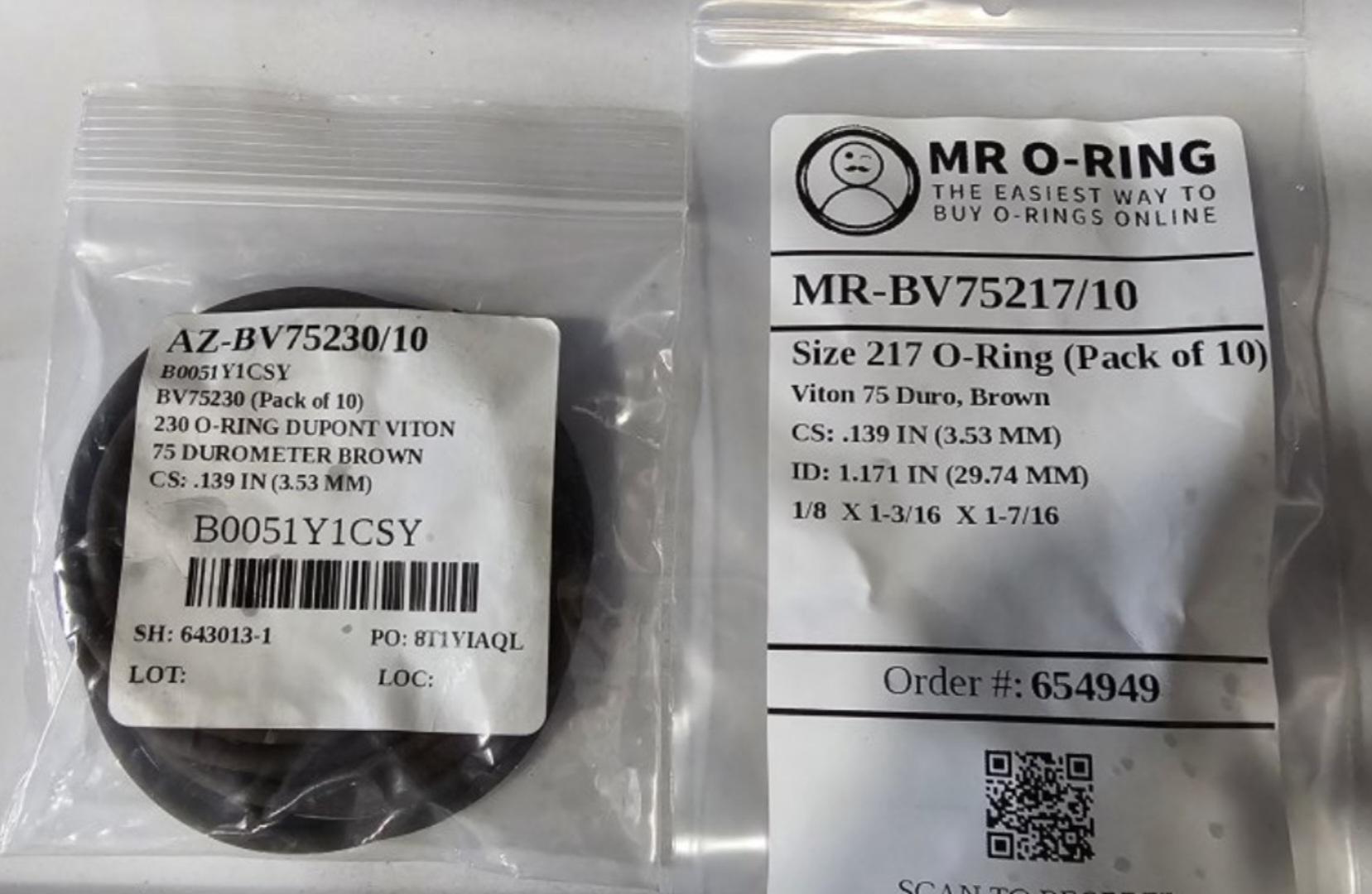

For reference later...
@Carlos.33193 posted the following oRings earlier at post 258 as replacements for the earlier PacBrake HP105363 kit but I wanted to have them added to my post to find them again later if needed for the the HP10596 kit.
And

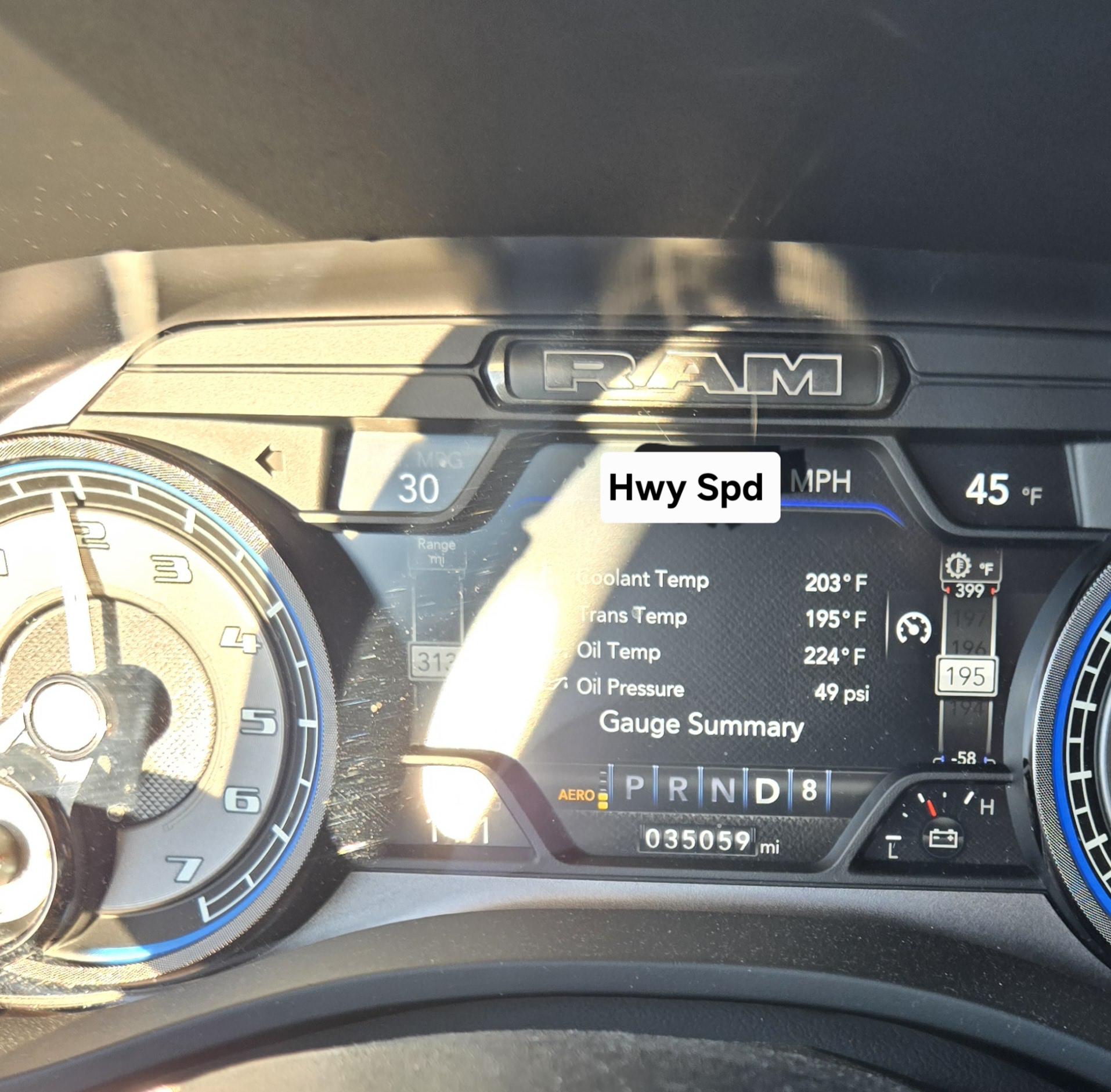

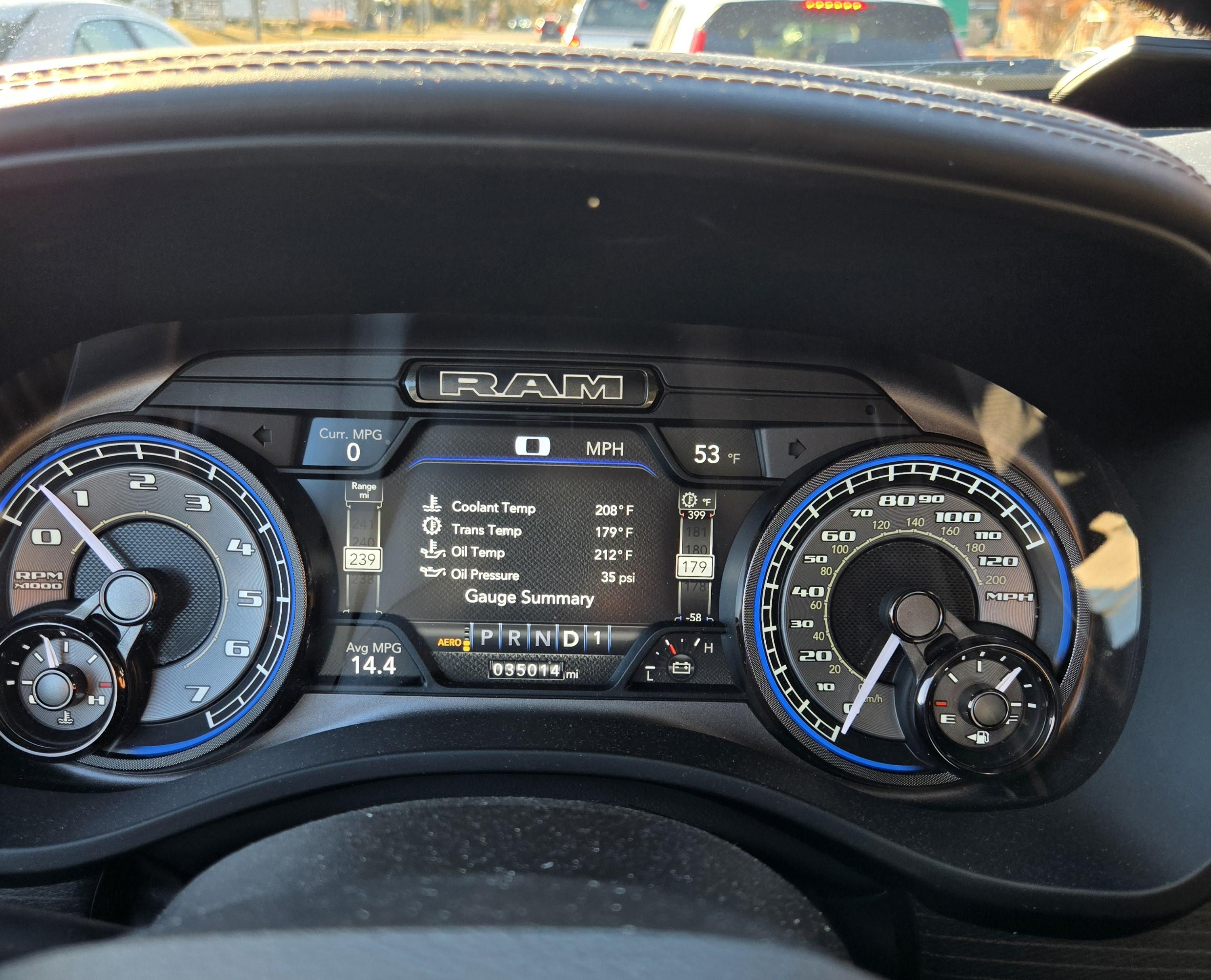

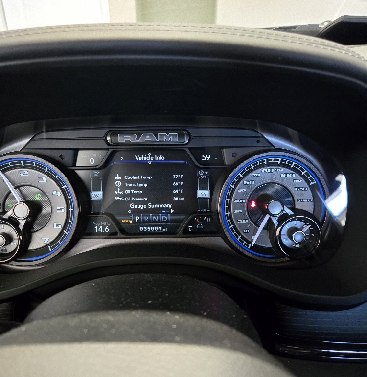

Oil pressure/Temp before kit
- Cold startup
- Warm idle
- Warm running/driving
