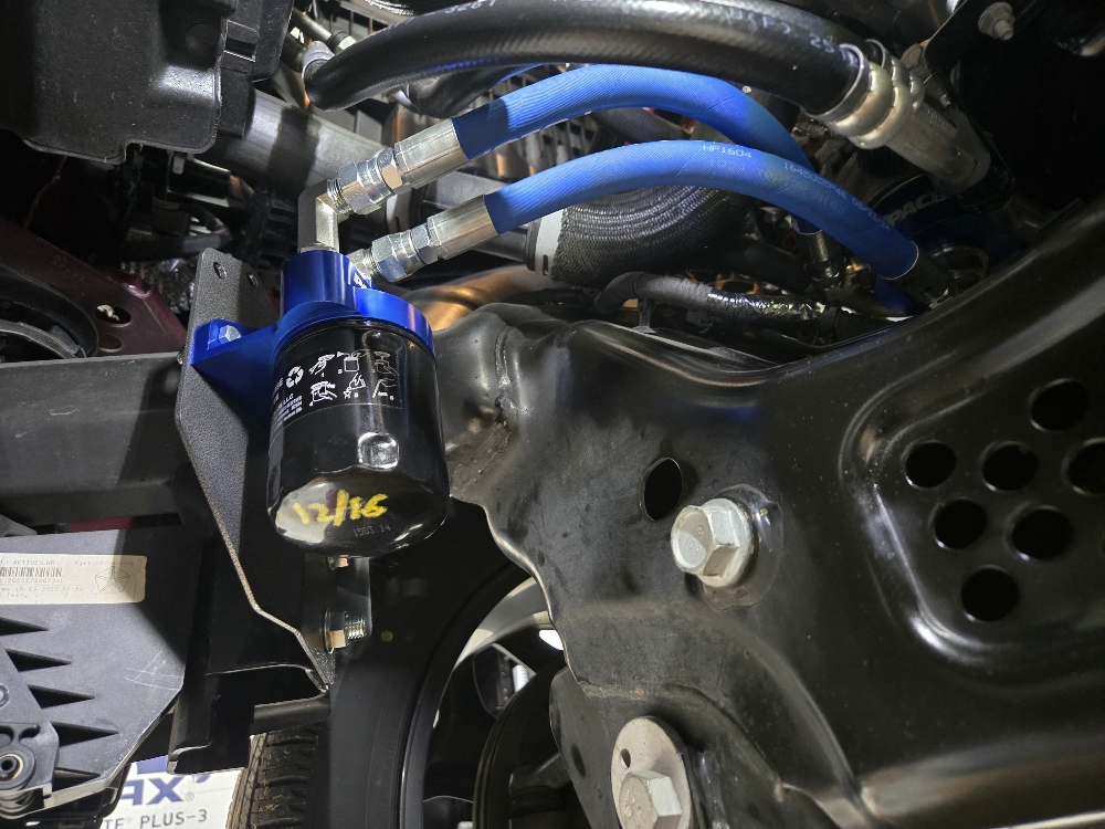

Got mine put on today
What filter are you using in this pic?

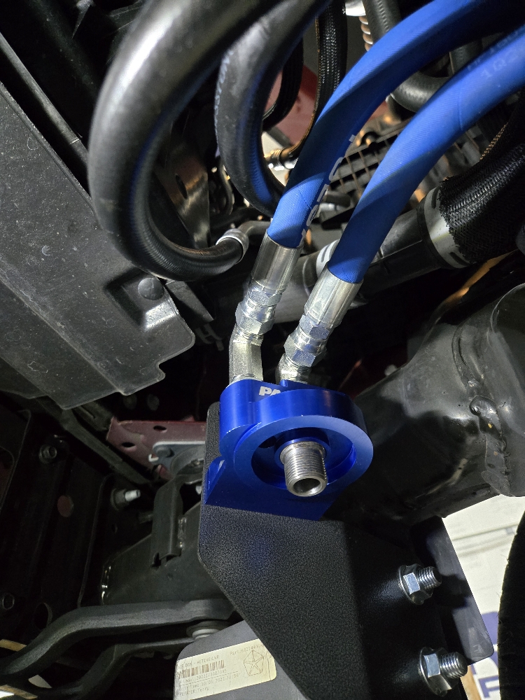

- I also found that, IMO, the filter mount is about 2" to high and I didn't like the hoses bending up to the remote Mount, which also made them rub against the other lines. I drilled a new set, 2" lower which made the hoses align/fit better IMO. (See pictures).
- Total install time for me was about 4.5 - 5 hrs and even with the truck up on the ramps in off road mode, was difficult to work in that space/install. My step dad said I looked like that Aussie break dancer lady (RayGun) spinning around/contorting constantly for better access... And I felt it the next day!
- Oil pressure dropped about 3-4psi across the board with same oil and OEM Mopar MO-339 filter (PN: 04892339BE. See before/after below).
I definitely like the smoother, cleaner look of the oil lines with your filter mount lowered 2" on the frame mount! I may do this to mine at some point also.👍

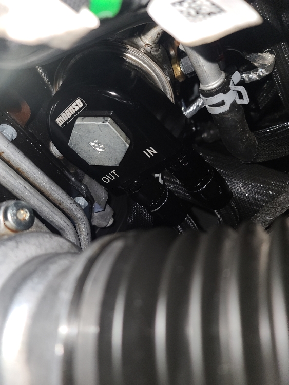

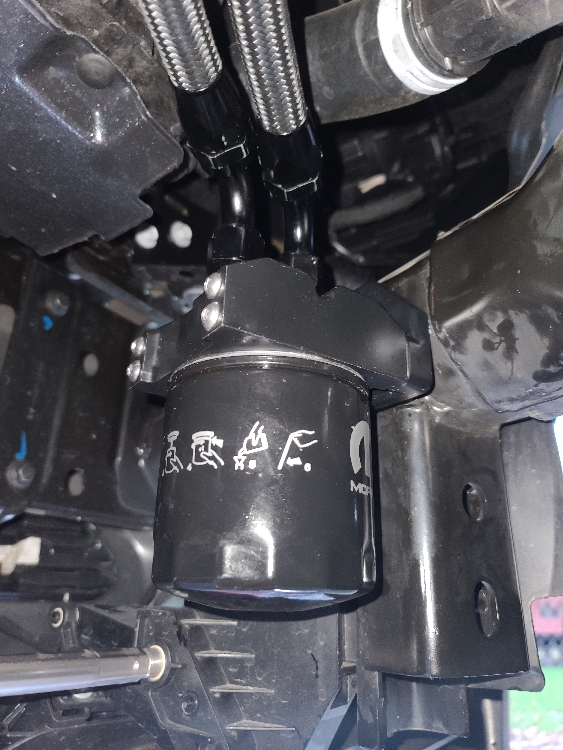

Checking back in at 20k miles after 4th oil change and my system has developed a leak in between the engine block and the manifold adaptor plate. All fittings are still good but the big main gasket seems like it has failed. Been leaking for a couple weeks, just a drip but its getting worse and I dont want to chance blowing it out so I am going to pull the main plate and put the filter back in the OEM spot until I can get a hold of pacbrake for the new gaskets or try the moroso adaptor with the pacbrake filter block. Will keep the thread updated!
Definitely two of the main adaptor block gaskets. It appears they shrunk a bit and started letting some oil blow by the gaskets. In pacs defense i just ripped this engine hard on a 500 mile trip including offroading and it never lost oil pressure, just dripped oil a bit. Michigan is very hard on mechanical things from wet salt and -10* in winter to 99* and humid in summer, this is what it looks like after a few michigan seasons. Will see what pac says about the gaskets, its my understanding they came out with a different material on the gen2. Oh yeah… if you think you make a mess with the filter on a normal change; pulling this kit beats it!!😁
