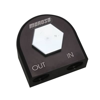

1 x Moroso Oil Filter adapter for 22mmx1.5 thread (AN-10).

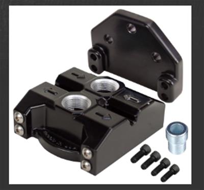

1 x Derale Oil Filter Adapter (AN-10) I bought mine through Amazon since it was out of stock @ Summit. There were a few different kinds but I liked this design and mounting bracket. I chose 3/4x16 thread oil filter version since there were more oil filter options (search Fram ph8a alternatives for oil filter brands you prefer).

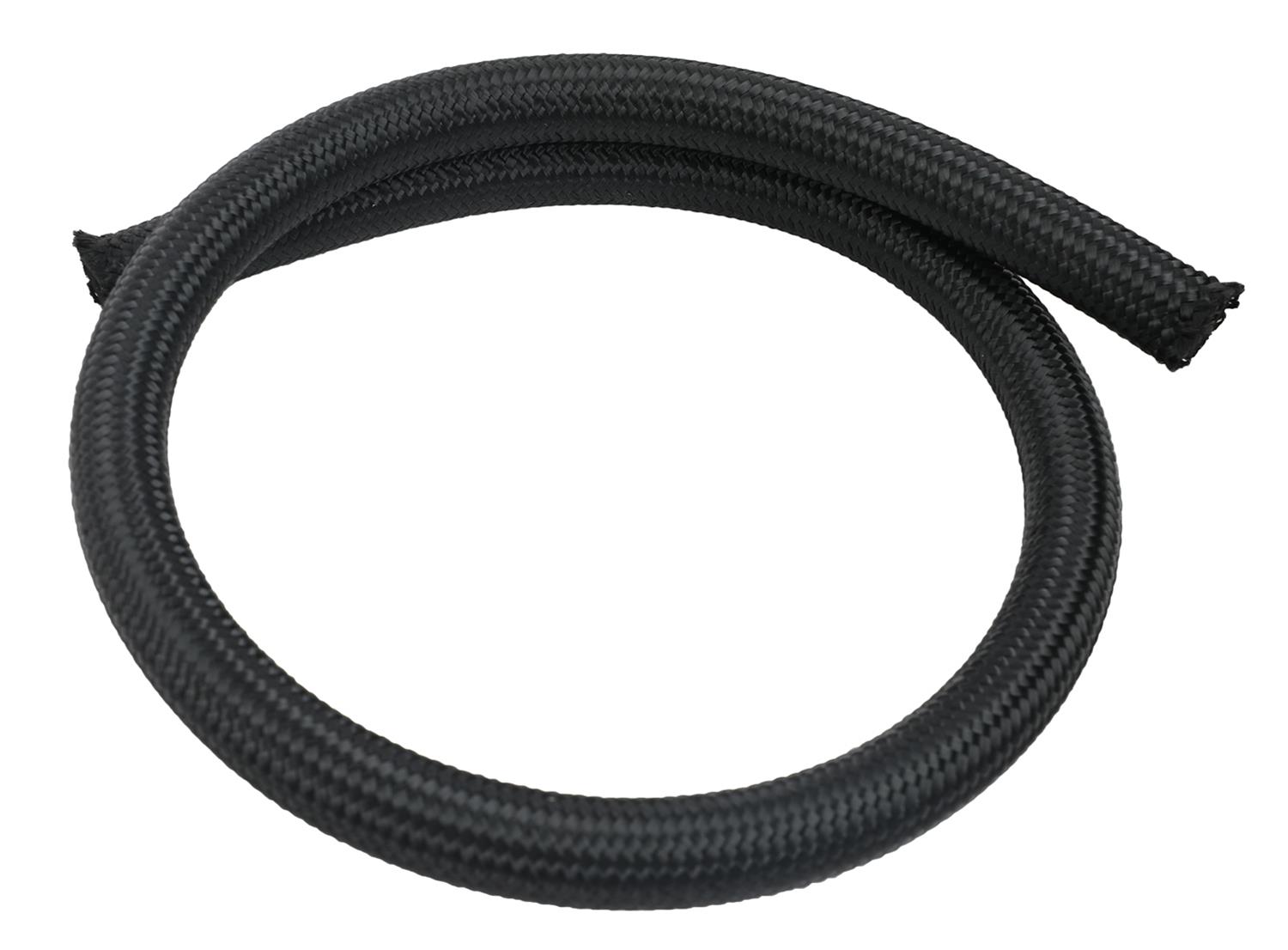

2 x Summit Racing Nylon braided hoses AN-10 x 3 ft. I didnt need 3ft and 2ft could have worked since I ended up cutting both in half. I would rather have more than less to finish the job.

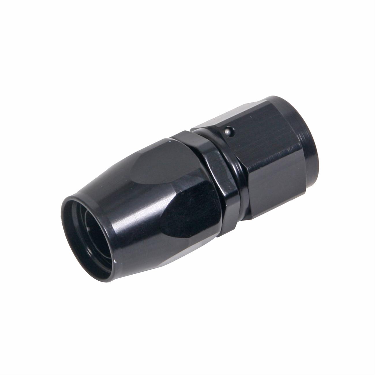

4 x Russel AN-10 Hose Ends. I ended up stripping one and I ended up using hose clamps on one fitting to finish the job. I will redo the one AN-10 hose end on my next oil change. I would buy 1 extra at the least. I have never made AN hoses and it took me a while to cut and install hose ends cleanly.

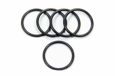

4 x Summit Oring AN-10 to AN-10 fitting. This installs on the Derale Oil Filter Mount and the Moroso adapter. Lube o rings and tighten down all the way, none of the orings should be visible.

Moroso Oil Filter Adapter bolt head size is 1.5". I had a socket but there wasnt enough space to fit the 1/2" drive socket underneath. If you buy a 1.5" box wrench, then the 12 point side should make tightening this bolt much easier. I had to struggle with a huge crescent wrench that made it more difficult.
AN-10 nut size is 25mm/1in which I didnt have so again, I struggled with a gigantic crescent wrench. It is good to have 1 or 2 25mm box wrench handy and I ended up buying an AN-10 wrench for future needs.

When installing and clocking the Moroso Oil Filter adapter, try to test fit the AN hoses to the Moroso adapter to make sure you have enough room to tighten the AN hoses. There are a couple hoses in the way and it could save you from having to reclock the Moroso adapter.
Apply lube to AN Oring/straight cut fitting before tightening it down on the Derale adapter.
Lastly AN hoses look nice to save cost and make the install easier using hose barbs and hose clamps might work just as well. Factory oil lines are clamped on too.
