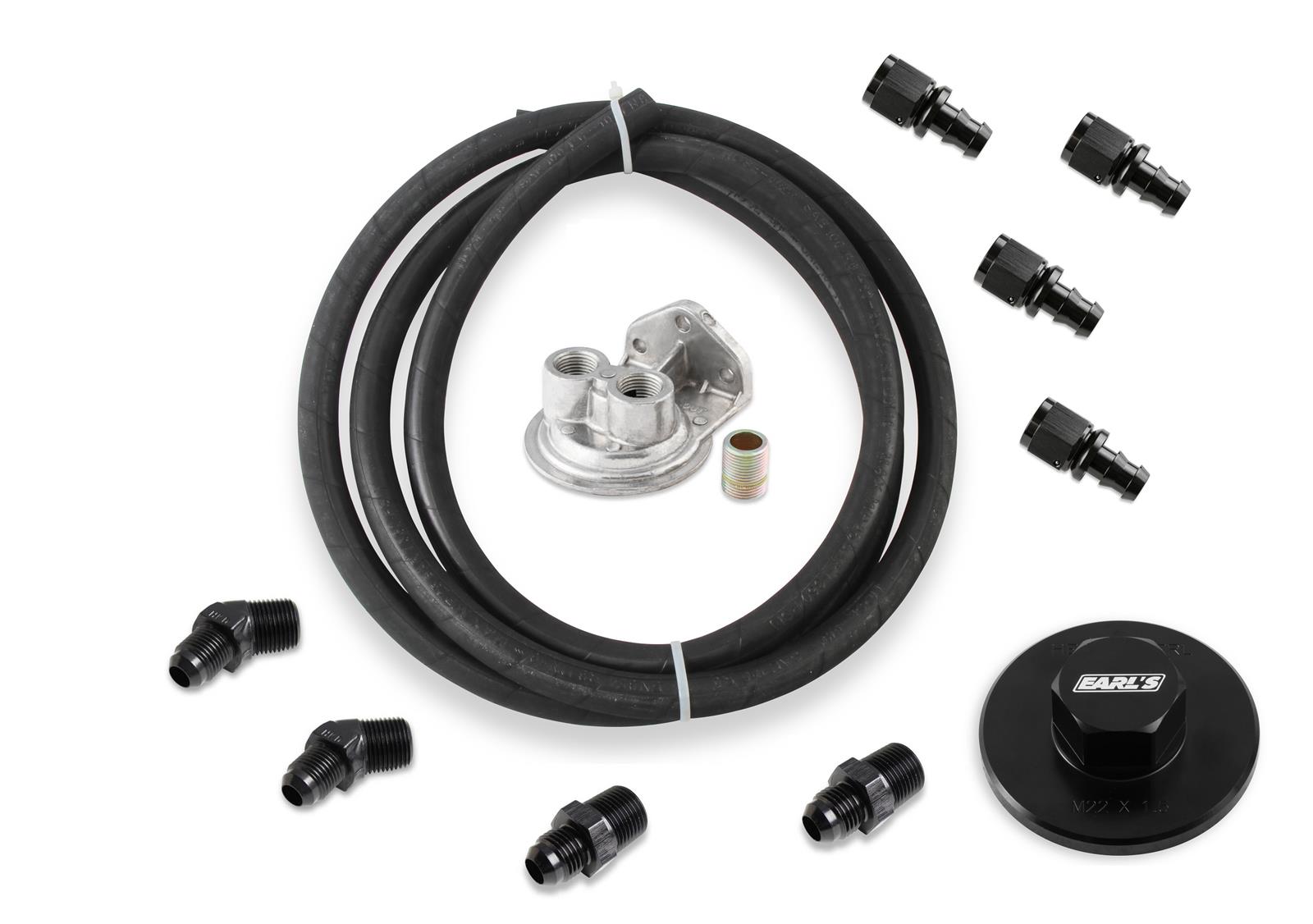

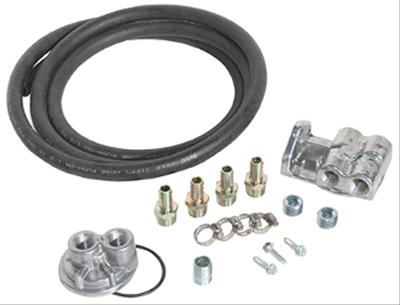

Or this
The Earls kit doesn't have an engine adapter, only the filter end. The second one is a complete kit, but doesn't have the proper fittings for a Ram. You would end up having to buy new fittings, then have to fab brackets. You could make it work, but I actually ordered the Pacbrake yesterday. I would rather spend a little more, and get an engineered to fit, and bolt right on, rather than hodge podge something together. But that's just my opinion.
If you read the Earls kit, it has a block off for where the factory filter screwed on, and there are plugs in he block you would remove and screw the hoses in. Eliminating the oil filter pancake adapter. IMO, if that's correct, it would be the preferred way to do a remote mount.
And what do you mean "proper fittings" for the RAM? It's a universal kit with the correct threads on filter adapter to fit Hemi block. The rest is, as it says, universal. Make your own hoses.

There is this
The Earl's kit is for Gen 3 Hemi's. It's not clear if Gen 5's have the necessary ports drilled and threaded in the block, that would have to be checked out. If true, that might be better than the pancake adapter. However, it does not look like swage sleeves are included with the hose and fittings, so you'd have to source those somewhere or cobble it with worm clamps or something.
It's still a Gen III Hemi used in 5th Gen Rams.
I see you were already corrected about the generation thing, but I don't like those hoses either. You could still use a kit like that, but I would have custom hoses made. Napa makes custom hoses.

I kind of like the flexibility of the Earls kit. I do see how the convenience of the Pacbrake would be nice though.
I follow you, it's the engine generation vs. the Ram. I think I'd still crawl under and verify that the bosses are drilled and tapped (and not blocked by a motor mount or cross member or ?) before plunking down money for a block-off kit.
