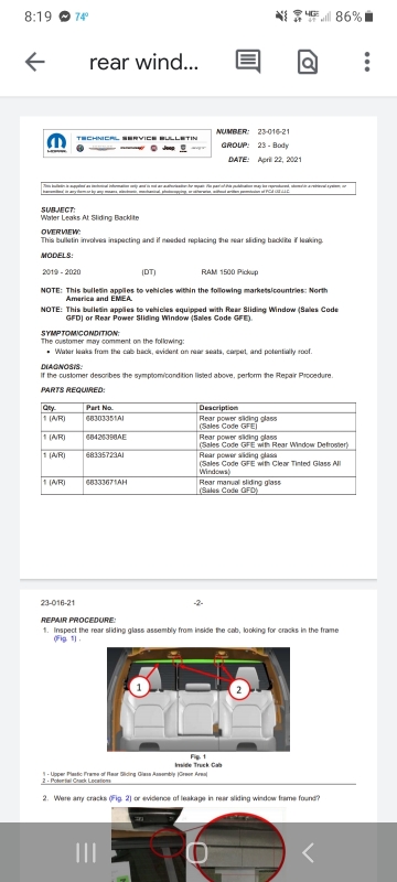

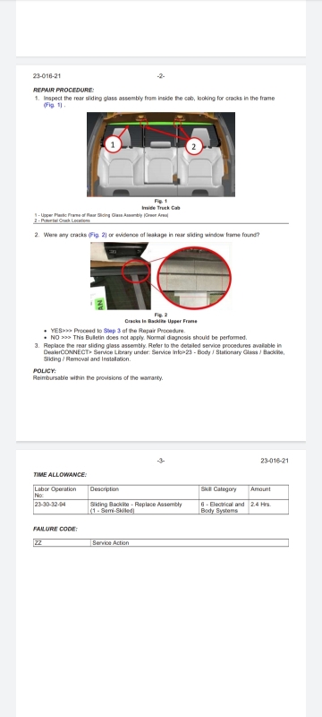

Screenshot? Can’t open the file
This might help
You should be good, the provision on the TSB is for 2019 - 2020. We are assuming the 2021 have the revised rear windows. Did you notice the design of you 21', does the frame look any different?
This isn't a confirmation, but to the best of my knowledge I don't believe I've heard of a 2021 with this issue.
