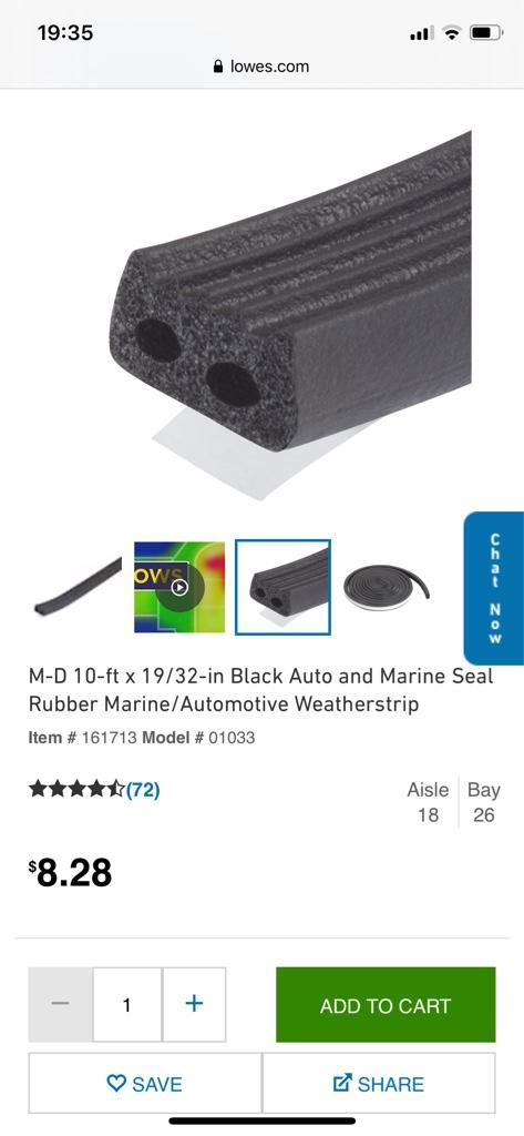

Check your 3rd brake light They has to remove it to replace glass They May have not tightened it enough or the seal can be worn out. It’s a spongy foam that can’t be reused to often because it deforms. Most of us have upgraded the seal with a rubber weatherstrip from Lowe’s. I had that happen to me after glass swap and once I installed the seal it’s dry even after 3 inches fell on it last week
Hey, do you know the item # of the weather stripping from lowes?
