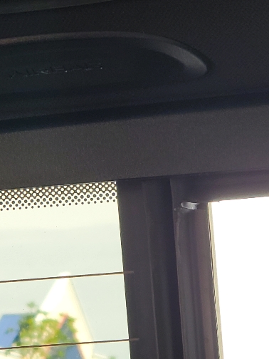

Rear window surround crack.

My rear window was cracked, and only leaked through the crack. As far as I can tell my 3rd brake light isn’t leaking. I’ve never had water spots in the headliner either.

I could be wrong, but I think what he means is “patching” it by installing the same flawed rear window which will more than likely crack again.
February 2020 build date. Crack faint but there. This is a hot spot in there molding process. Obviously 2 years later they still don't care. No leak yet.

I thought they were replacing the whole back window ?
Multiple leaks going on. Seems the two most common "rear" leaks are the Third Brake Light OR the Rear Sliding Window. If the cracks appear on the rear window, they replace with what looks to be the same window, however, the part numbers are different.
400 miles, my Ram already has the crack. No water ingress (yet) at least.
I've seen water spots on the window for a while now, but finally visibly confirmed that the cracks are now leaking. Going to have to schedule a replacement soon.
I agree. I had the crack, had the rear window replaced and it is still leaking. The third brake light is next to be replaced, which is a whole lot simpler than replacing the rear window.
