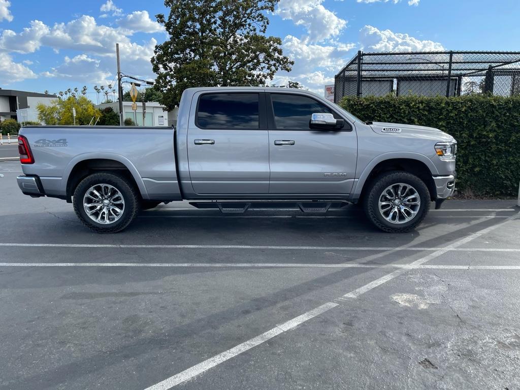

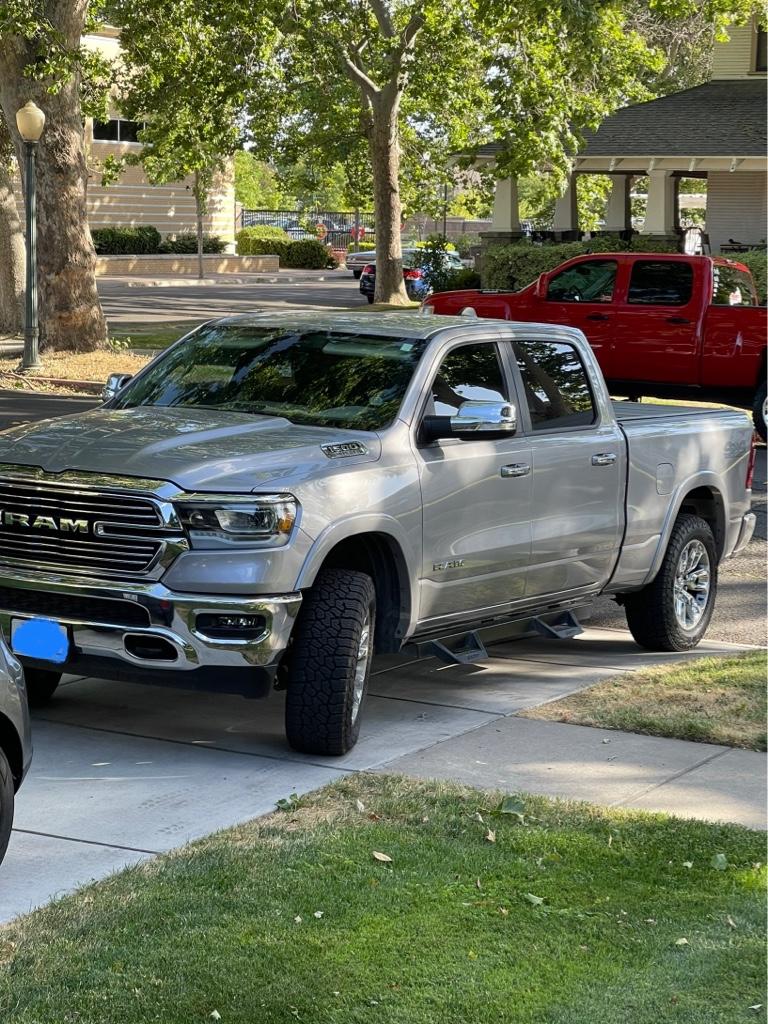

You need the spring and the shock. But what you can do is take it to the max setting on the bilsteins and get the mopar ucas. I have the orp package and did the ucas and the bilsteins at level 5. That was the max for my truck. I have a slight rake but looks dope. 285/60r20 but could have gone 34” or even 35”no rub currently. There’s a forum on here that talks about all of your options.
I like the truck! ORP springs do not appear to be that expensive compared to Bilstein or Icon springs. I can order these, install with the Bilstein's, and UCA and be good. I'm on the fence with the Mopar UCA vs ReadyLift UCA. With the ORP springs, I can get the additional 1" I want in the rear, and allow me to keep some rake for towing / hauling.
Do you know how much rake you have after everything?
1/2”.

Post pics when your kit gets on!
That looks really good!
Looks a little bit lower on the back. I also changed the sway bar and seems to have dropped the back. Maybe it’s just me.
2019 Ram 1500 ORP “long bed” - setting #5 bilsteins, 2”mopar ucas, hellwig sway bar, tonneau cover, bed mat, 20” Laramie sport wheels on 285/60r20 falkens. Flowmaster outlaw.
