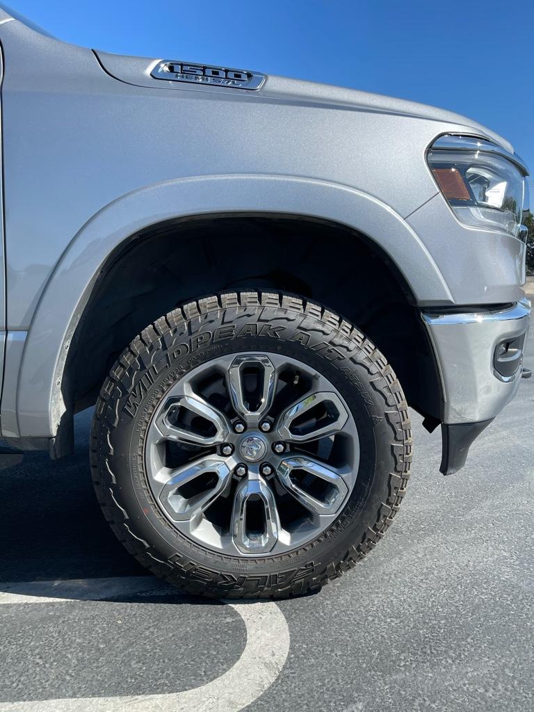

Maybe someone can shed some light on this, as I've read over 40 pages of different threads and I think I more confused now, than when I started. My truck is a non-ORP Laramie crew cab. I am on the fence between lifting the truck with the 2" Mopar lift, or going with Bilstein 5100s to get <2" and nearly level (I want some rake as I tow and haul). I will be putting larger off road tires, but no bigger than 295/60/20s. I'm not married to that tire, but will at least go 275/60/20s, just don't want rubbing and need better offroad tread.
I am a function over form kind of guy, and the truck does and will see some rutted gravel roads, fire roads, and creek crossings in its life. I would like suspension travel and not just looks. With that being said, I don't need more than 2" of lift to accomplish this, and realistically I think 1"-2" and bigger tires would do the trick. What's the best way to accomplish this goal?
The Mopar lift comes complete, but if I go the Bilstein route, will I need front UCAs? What about track bar re-location? Do I need ORP springs? Anything else I am forgetting?
