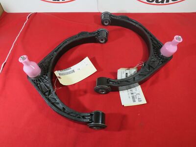

$150 Mopar ORG control arms

I know this is a little late but I can't find the org control arms on the Mopar site, I only see the stock ones. Does anybody know if they still sell them separate from the kit and if so could you post a link? I would really appreciate it!
2” offroad ones are what you want not the ORG package ones which I learned not long ago are the same regardless of how the trucks optioned.
awesome thank you!
