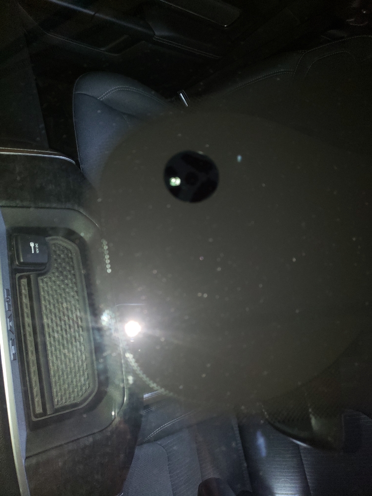

Is this what your talking about on the outside mirror shroud?
Yes. That circle is the humidity sensor. That would be replaced with the rain/humidity sensor combo. It looks exactly the same but is a few bucks more than the standalone humidity sensor.
