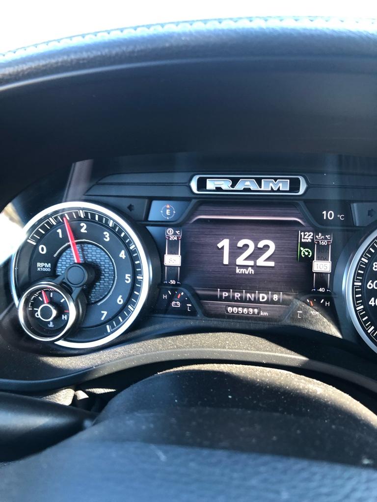

75.81 mph @ 1500 rpm

Nice! Thanks man. Is your speedometer calibrated? Mines not calibrated
That makes sense because I'm at ~1950 rpm at 75 mph with 33's with a calibrated speedometer. Your speedometer is off by about 10 mph at 70-80 mph.

Yep I know the odometer is off. The odometer, speed, and mpg is off. But I know my tires are 14% larger than stock (I’ve calculated and tested it) so I know my odometer, speedometer, and mpg are off 14%. So at 66mph on the truck I’m actually traveling at 75mph. Every 100 miles I actually travel 114 miles. And if the truck says 11.6mpg avg then it’s actually 13.3mpg (according to the truck itself - but surprisingly my hand calculated numbers are usually really close too). I find my true mpg by taking how many miles the truck says I drive (usually about 280 miles per tank), multiply that by 1.14 = 319 miles. Divide 319 miles by how many gallons it takes to fill up. Usually 24 gallons to drive 319 miles, so I average 13.3mpg.
Yep, you've got it figured out. I was just discussing this with another member and while he was aware of the speedometer error, the odometer error slipped his mind.
