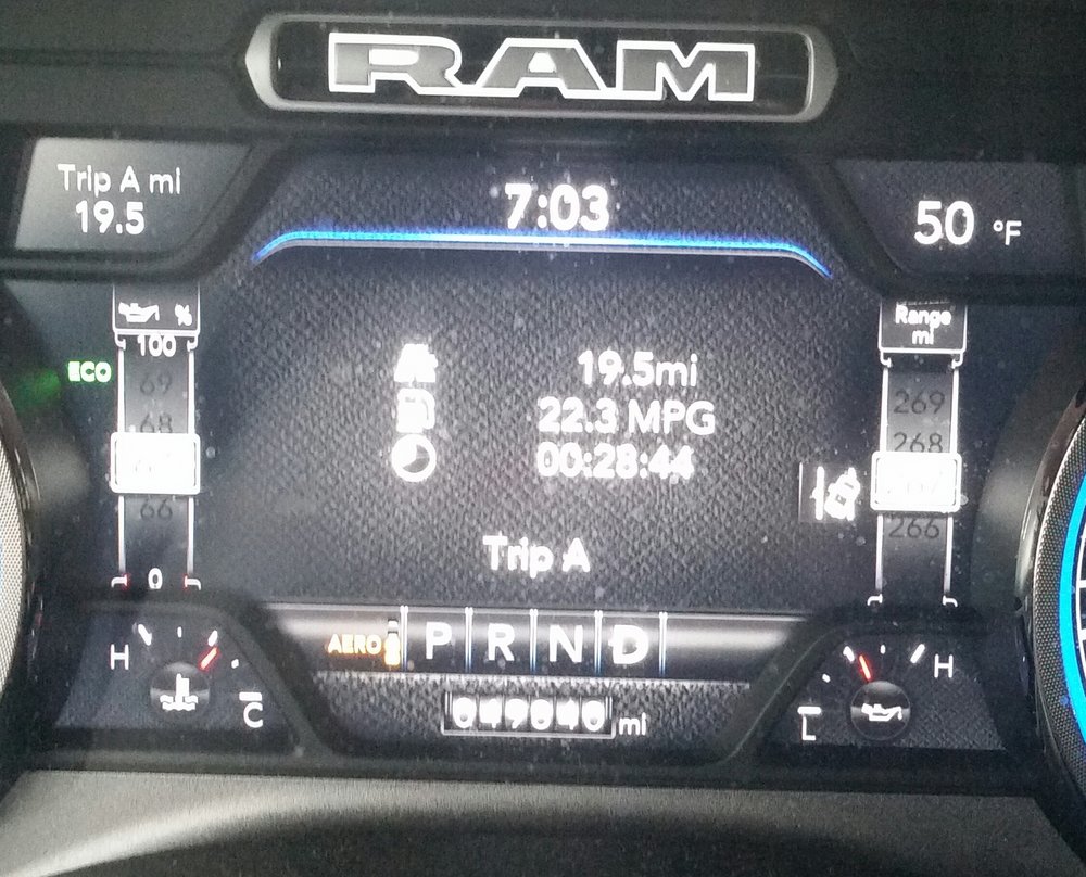

It's possible. You just have to drive slow and like one of those Prius forums hypermilers. I think a tonneau cover helps, especially with a long bed. Also 93 octane, CAI and Borla exhaust (maybe?). If I didn't have towing mirrors, off road skid plates, AT tires and 3.92 rear diff mileage could be better.
Overall a lot of variables involved but driving style seems to matter the most.
your MPG over 19.5 miles is really NOT a true representation(Perhaps doing down hill and on a flat highway over the 19.5 miles to yield 22.3MPG) How about driving 519.5 miles an report back then . . .
