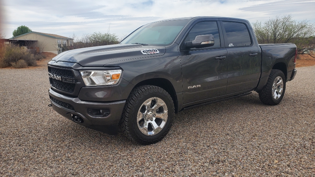

I am very pleased with my Yokohama X-AT 285/60-20's on factory 20" chrome wheels with 1/4" RC spacers. 17k miles. Good wear with rotation and real ancestors every 5k miles. Quiet for an offroad tire.

Just learning how to post pictures

raj
Mar 7, 2021
13
5
At 17,000 miles you can barely hear them. The ride is incredibly smooth. Moma prefers the truck over her Buick Enclave.
I think the 285/60/20 is the perfect size for these. Yours look great. I have 275/60/20's on my 21 limited. Would like to go up to your size but I hate LT tires as 99% of the time they are unnecssary, meaning the p metrics aired up to carry max load are very sufficient for what most of us do. I know this is very subjective but when you put those on how much did the ride change. I know it changed because that size is an lt tire and it is heavier than stock. So they will not be as smooth as stock. I guess I am looking for a real truthful answer ie, feel the bumps more or mpg"s took a big hit or? Thank you and again yours looks perfect.
I only had the stock tires on for less than a week before the switch. The difference in ride is almost imperceptible. I am running the pressure at 37psi. There was about a 2mpg drop in milage at cruising speed but the mpg is still impressive. This truck rides so nice its amazing. The bottom line is this. My charming bride prefers driving the truck over her Buick Enclave. She drove it from here in Arizona to Montana when we moved the son up there last summer. She loves it.
