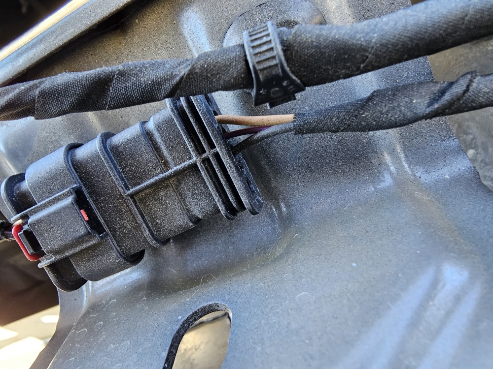

Can any one confirm how many wires are in the wiring harness that is going from tailgate to the back of the truck. I have just 3 wires leaving the wiring harness. Thank you !
Sent from my SM-S918U using Tapatalk
I’m hoping someone can answer for you more definitively. From memory, I remember seeing the same thing and thinking “hum, three wires at the end”. And then thinking perhaps the black is split somewhere in the harness to the latch and is shared. Also, since the third magenta wire matched the added wire in the new harness, I assumed this has to be ok. Does it work? I guess that is the ultimate answer.
