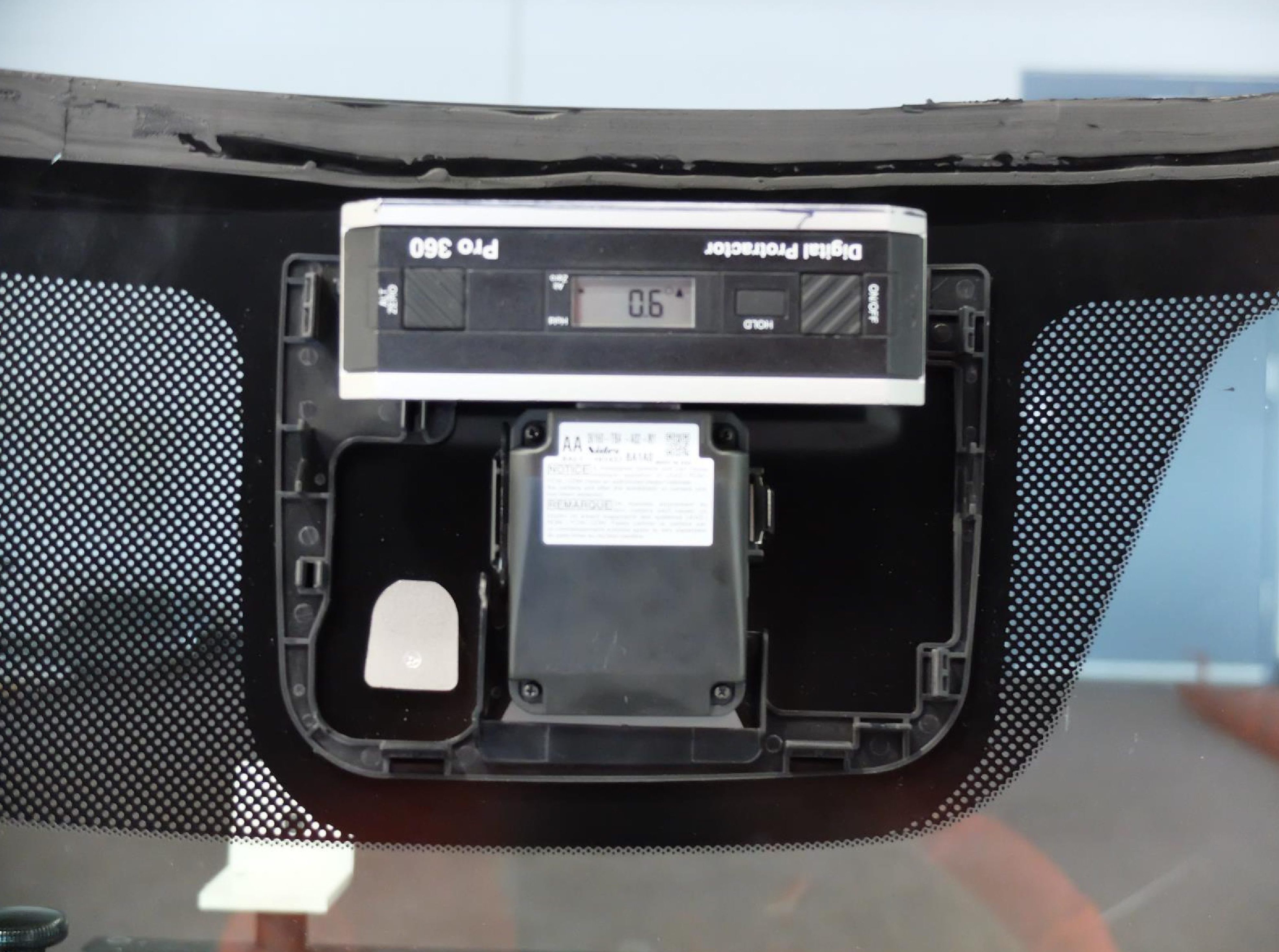

Had my windshield replaced and tinted last week. Ever since I picked it up, the lane departure feature defaults to off and gives me a message to see dealership. Auto glass company swears they never unplugged anything. The tint was cut around the camera, so i don't think that is it.
I had issues in the past where it would randomly turn off and back on while driving. Wondering if a calibration is needed?
I would just pop off the cover to the camera and check for an unplugged or damaged cable.
I think I remember reading in the owners manual that you can reset the lane guidance camera, and should, when replacing the mirror or windshield. Not 100% positive, but check there as there was something about the camera in the rear view mirror.

I will have to look into that. The auto glass shop had never heard about it needing re-calibrating. Seems to me they need to get with the times. I am assuming the system will default to "off" if it senses a calibration is needed?
The windshield was replaced in my wives Mazda CX-9 with the same features and it needed to be re-calibrated by Safelite. I suspect yours does, too.
Subaru windshields are the same and the owners manual states that it must be recalibrated after replacement.

I am assuming that this will have to be paid out of pocket to get it re-calibrated?
Two windshields within a week. One had a blem so safelite replaced. Dealer Recalibrated both. No charge. Safelite makes you sign a warning you know the Lane departure is out of service. Apparently safelite will have the codes to recalibrate the 2019s by now. They didn't have them when I did my windshield. It cost glass shops like 30k for a calabration device. Probably why some don't calabrate

I have had to replace the windshield on my 15 durango and 16 infiniti. Both times my insurance company told me I had to have the camera re calibrated. They reimbursed me for both once done at dealer.
