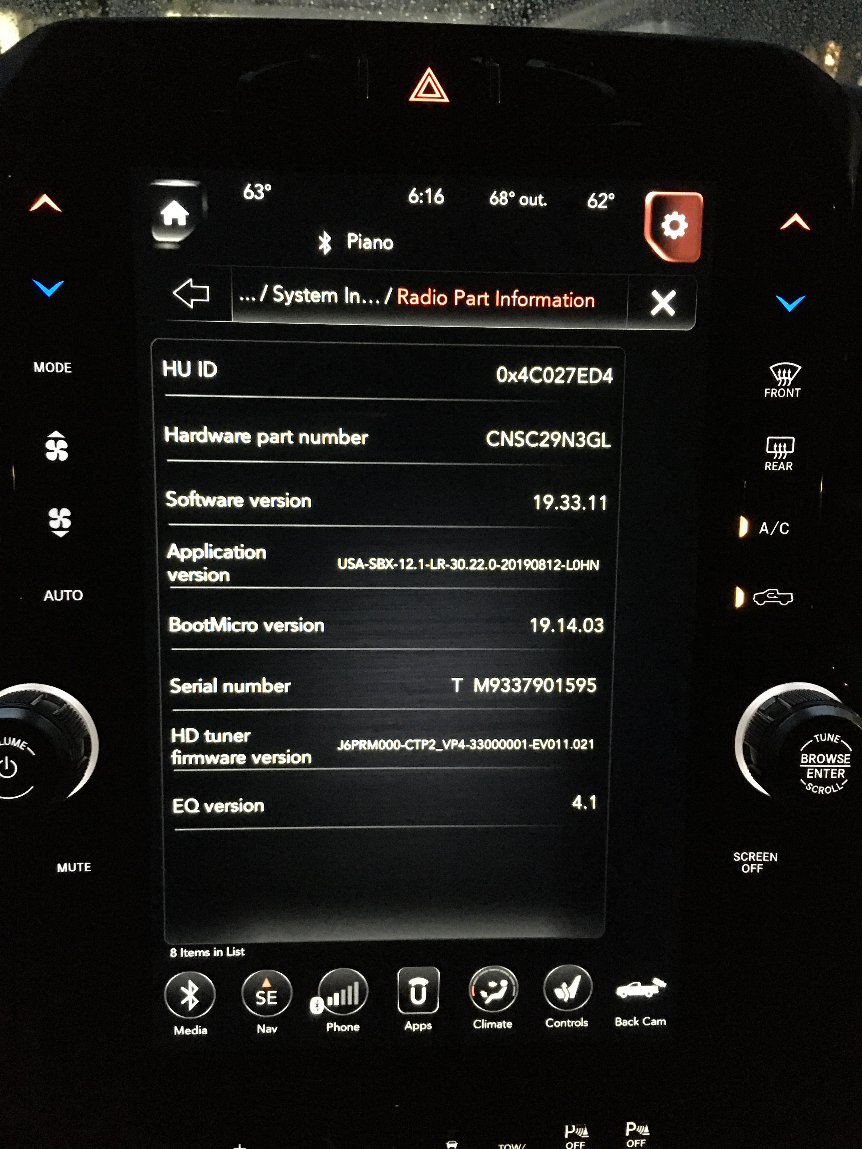

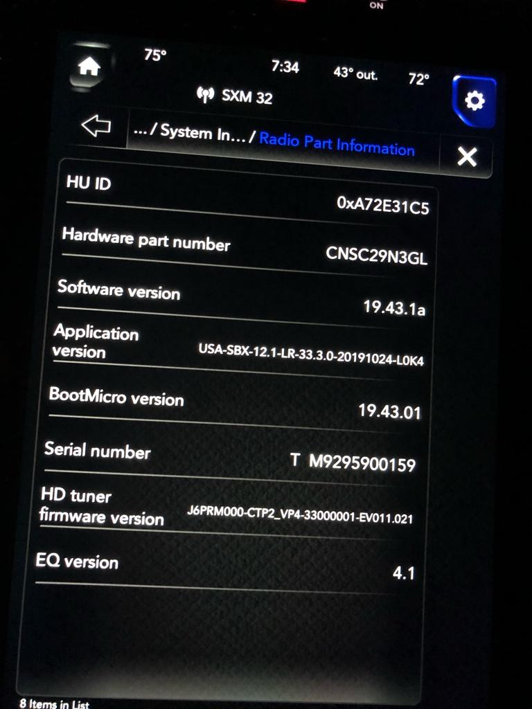

Just press and hold the two icons I have circled and it will bring you into dealer mode where you can see the software and radio part information. 20200201_113613.jpg
Okay got it what number do you want off that? Software version says 19.43.1a

I’m in Southern California. It actually pop up when I turn my did the truck fromRun to Off but power was still going to the radio. I put it in ACC to keep power going to the radio. It said 45min but it took about 15mins.
