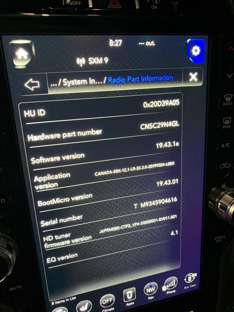

New 12" Uconnect Software Version 19.33.11? New Update 19.43.1a
According to service bulletins, the software version is found in the application version line. One would think that the software version line would be the same but who are we to argue :rolleyes:. Wait we’re consumer; of course we’re going to question and argue.:p;)
@supercanadian your photo is too blurry to see it there is an actual new app version and not knowing what your previous version was also makes it difficult to know if there was an update.

Sorry about that looks like mine is what everyone else has thou odd since my truck was built in December it was not already installed loving the camera turning on now when shifting into drive

Posted this in an older thread, thought it deserves a new start if true. Had Uconnect software version 19.33.11 loaded on my new truck when I picked it up last Saturday, could this be in infamous 4thQ update we have been waiting for? I have not seen this version discussed any any other threads to date.

Hold down the 2 outer soft buttons at the bottom until the dealer screen comes up. Then you’ll see the 1st screen. Select system information, then radio part information and you’ll see the last screen.

I have the same software as your NEW version WITHOUT a trip to the dealer. Truck build was 5/19.
I’m still not clear whether it’s a new (over the air) update or just the one my truck came with.
Just the one your truck came with. There hasn’t been; that I’m aware of, any OTA updates pushed out in the last year.
this is more a firmware update and not a uconnect software update. If you want to think of it like a computer/phone.
