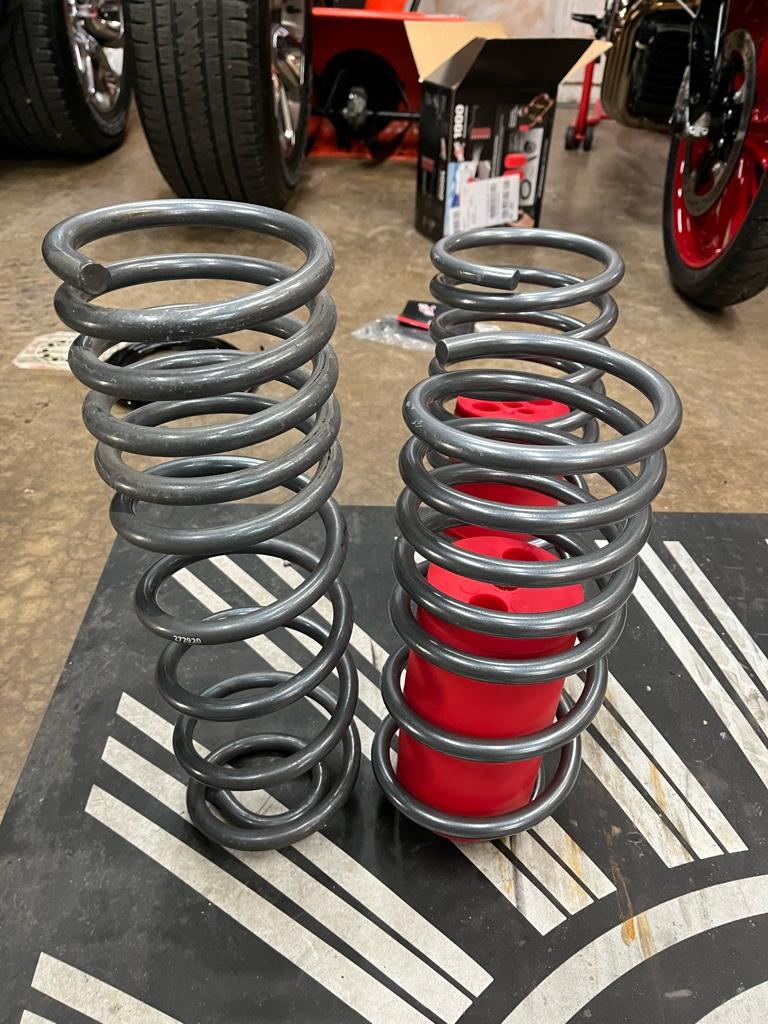

Mactrac 2/4 in lowering kit - P/N K332724
AIR LIFT 1000 Series Rear Airbags designed for a Durango- P/N 60824.
Spohn Performance Adjustable Rear Panhard Bar- P/N D09-1500-104 (you can get red or black)
Rear Bilstein 5100 shocks from a early 90s ford ranger. P/N 24-185684, ASIN # B004WO9JK2

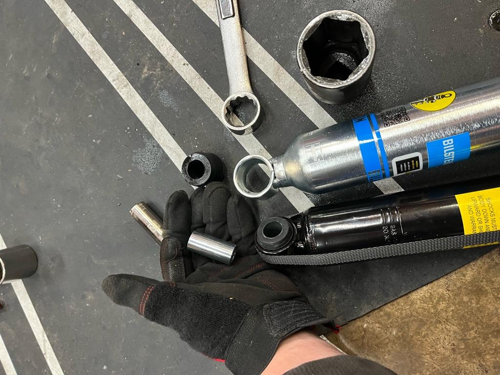

With the spohn panhard you do not use the maxtrac relocation bracket, nor do you use the sway bar spacers in the kit. For the 5100 shocks you swap the maxtrac shock sleeves into them.

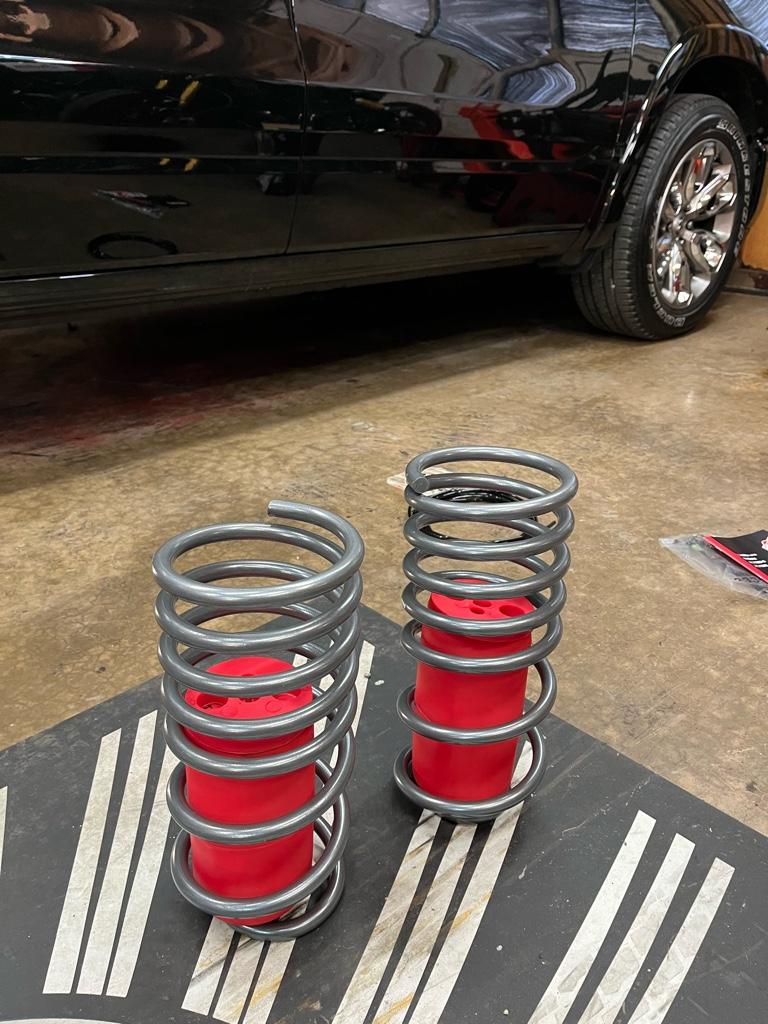

As my truck sits right now with the 2in drop springs in the rear, I'm at 36in F and 37in R. My plan is to set the front struts to 1.5in, which should give me close to to no rake, and help keep the front alignment in the green. And use the helper bags when I load the motorcycles in the bed. Since every 2/4in dropped truck ive seen still has rake.
So far im right around $5k for everything since I was able to find a few deals and discounts. Pictures and video to come as I start everything based on the weather and snow on the ground.

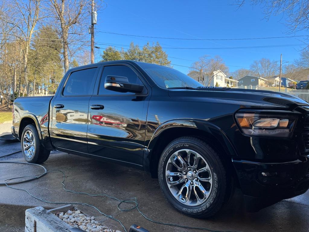

How the truck currently sits.

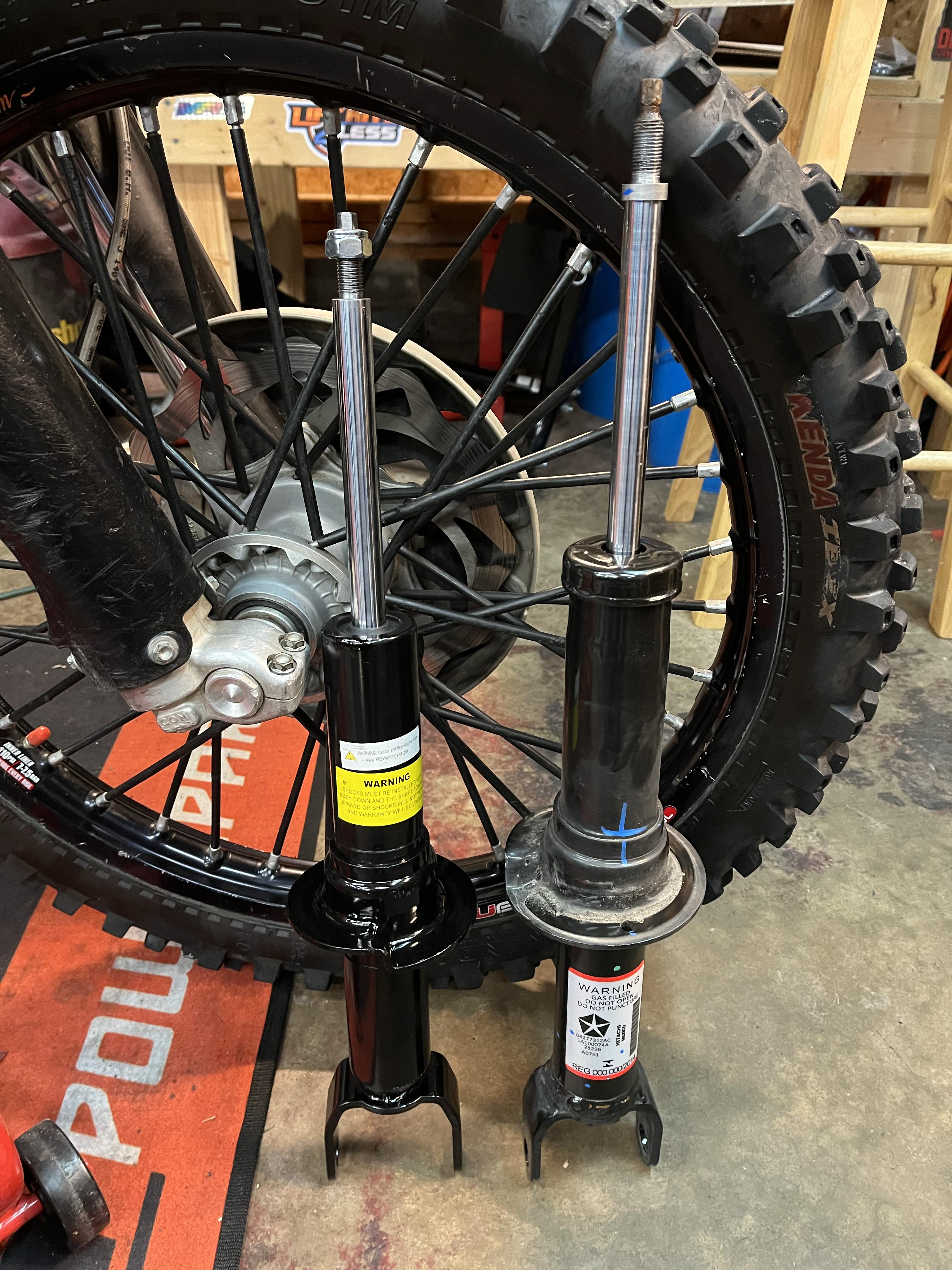

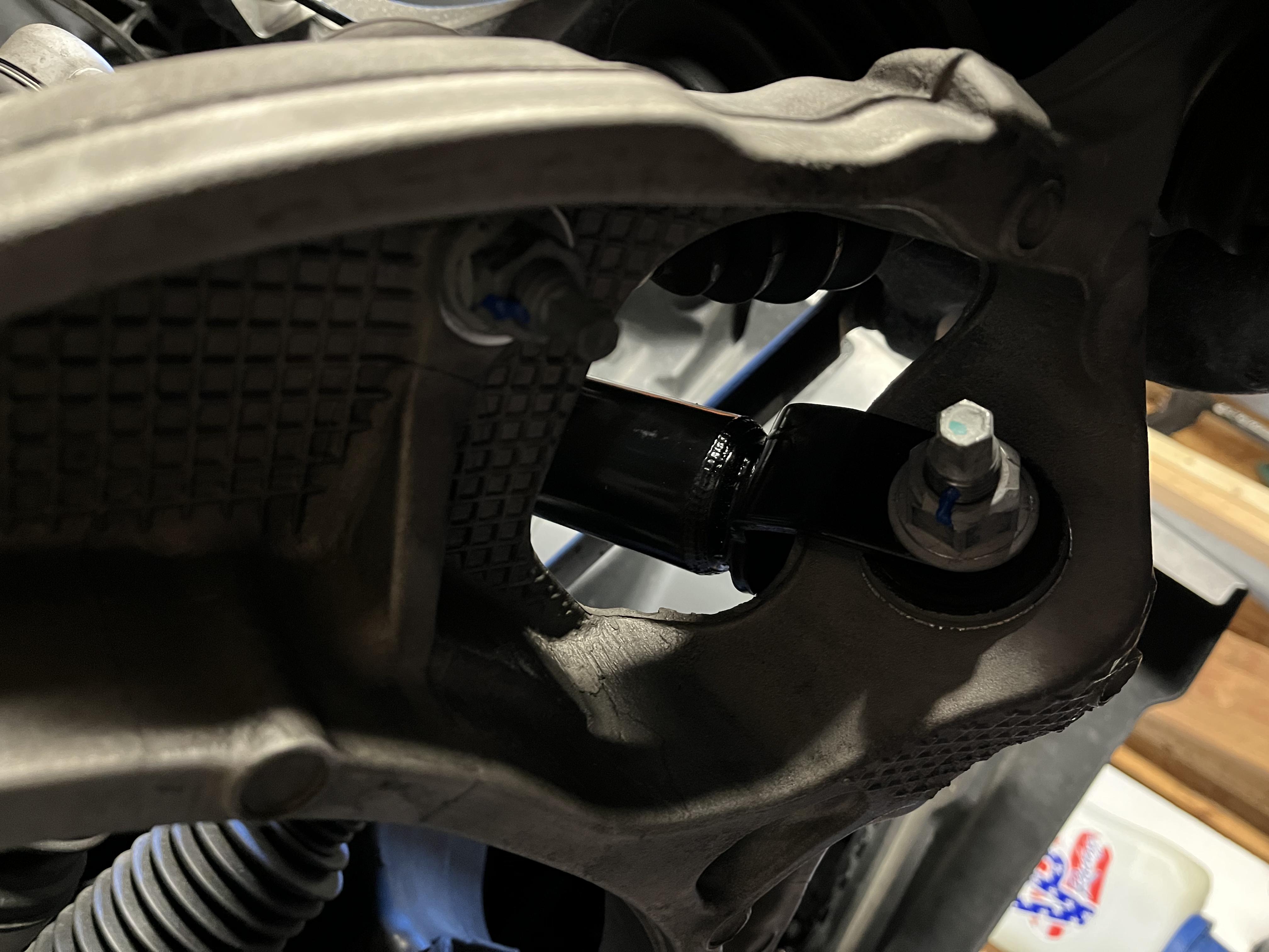

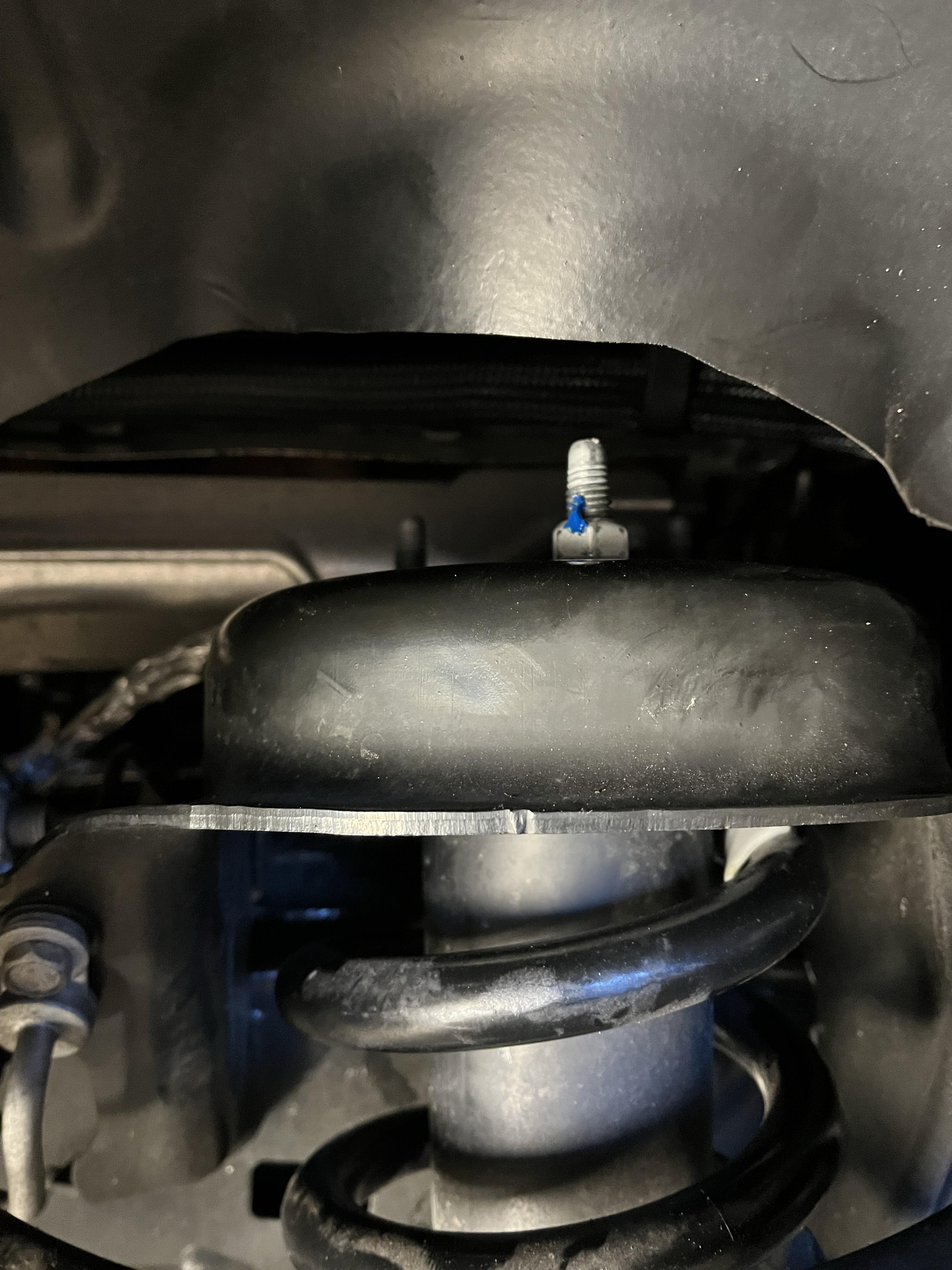

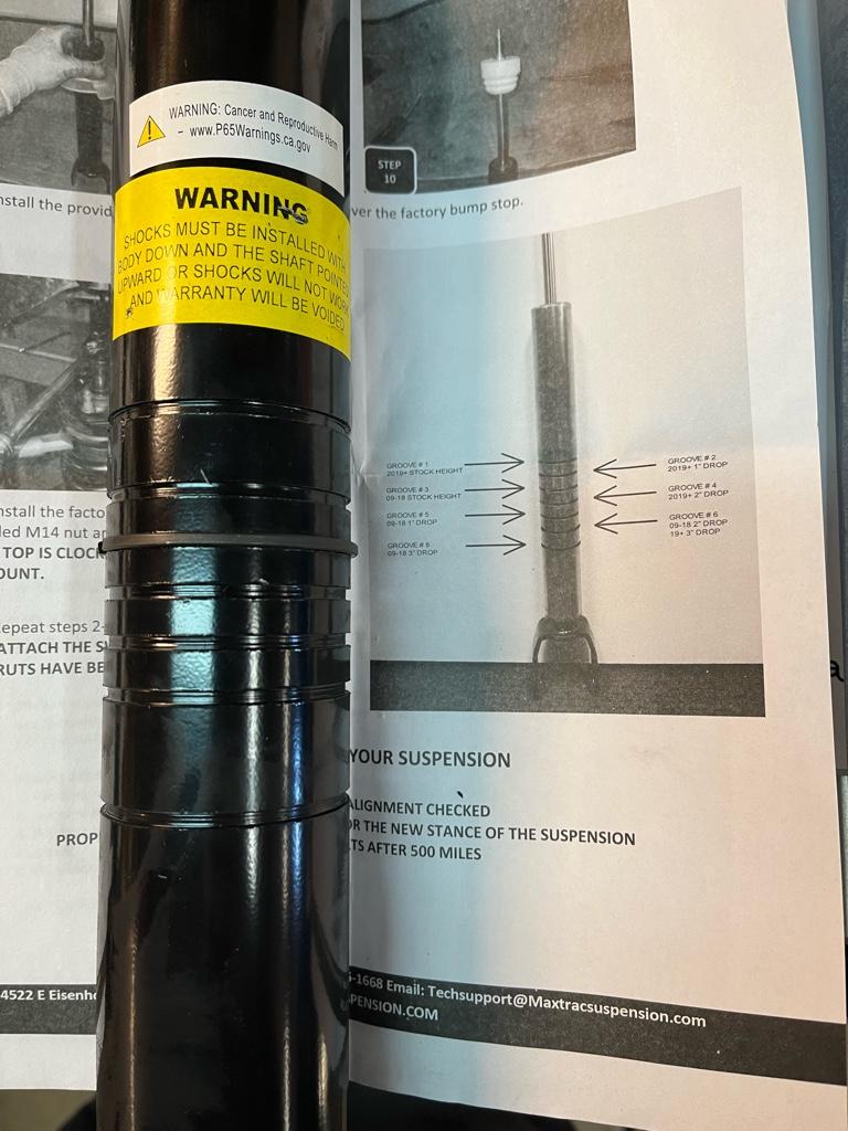

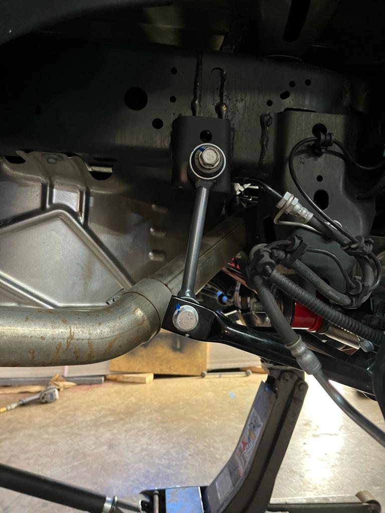

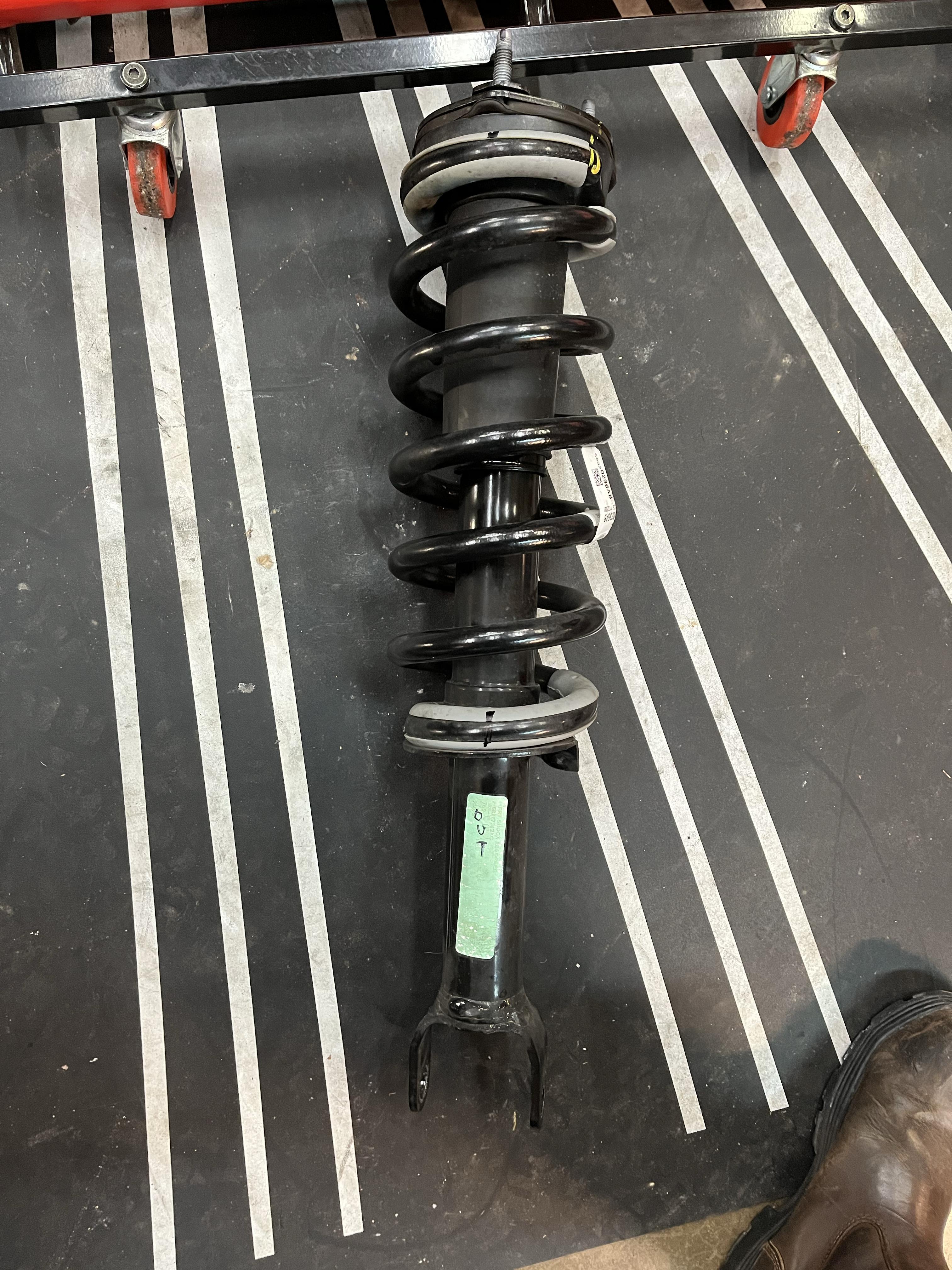

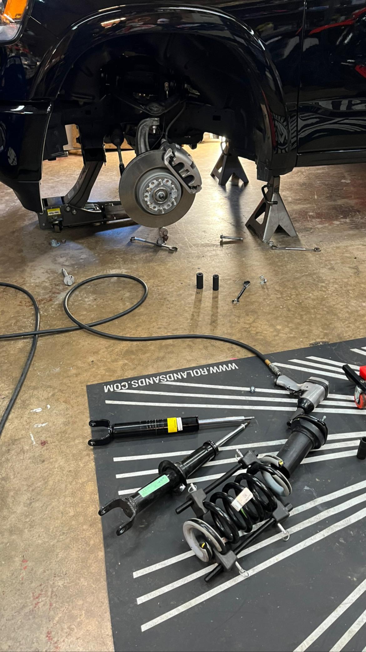

Fronts done. Took me a little over an hr for both sides including setup. I set it at the 3rd slot to give me around 1.5in drop. You mainly need a 18, 21, 24mm wrench and socket set. And a 5/8th ratcheting wrench for the strut bolts.

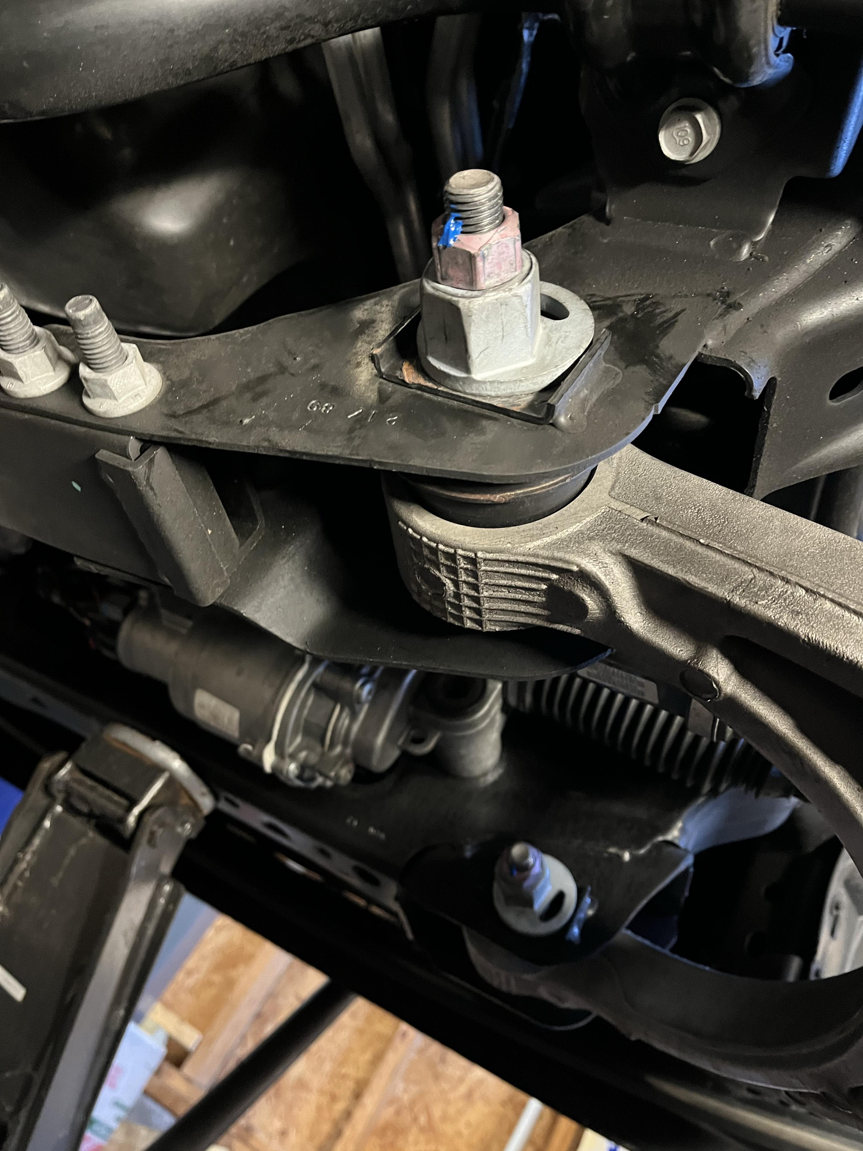

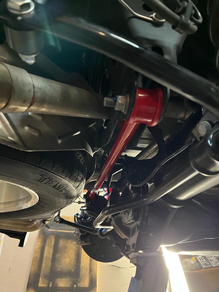

On my truck I did not need an adjustable panhard bar as everything centered perfect with the MaxTrac parts.

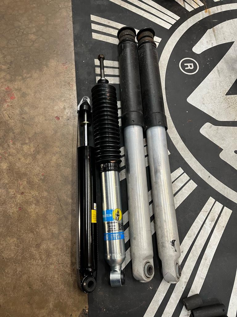

Start to finish I was at 4hrs. Including drinking my coffee, unboxing everything, and trying to stay warm, (it was 20*f this morning)
From my eye ball it looks like my axle is centered, but I think it was worth $150 to not have to mess with the relocation bracket, or sway bar spacers.

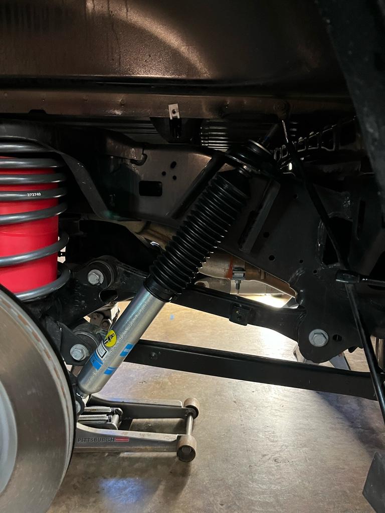

For the 5100s you need to remove the bushings from the maxtrac shocks and install on the 5100s. Everything else was pretty simple.

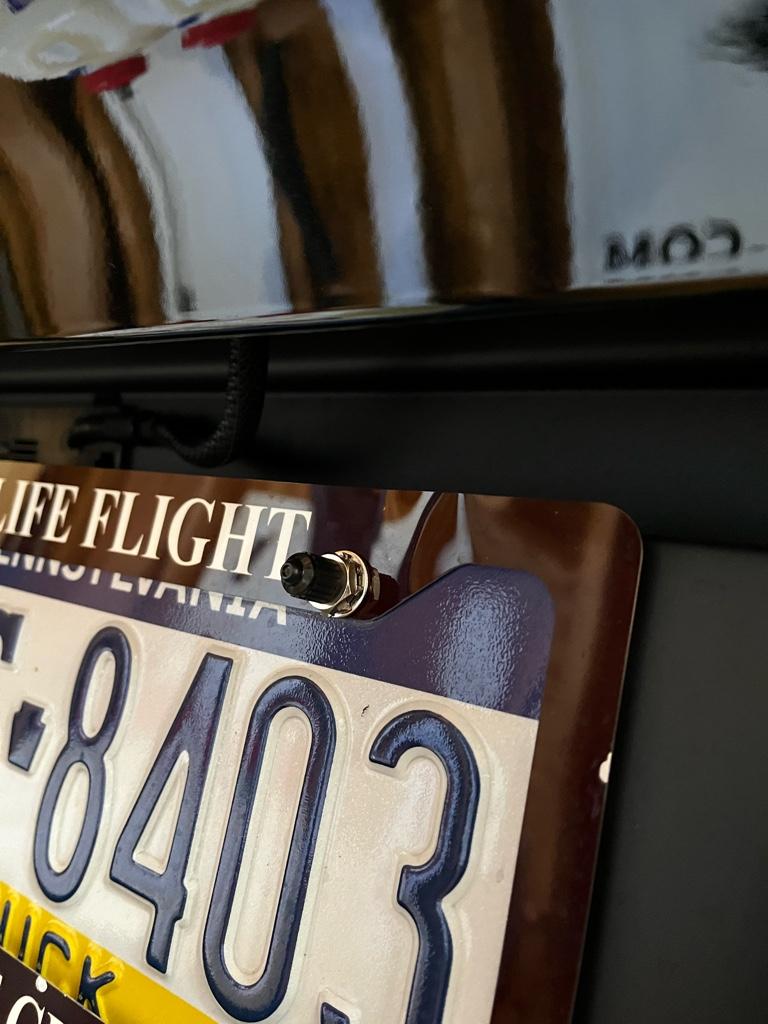

And I ran my airlines to my license plate.

I may go the adjustable panhard bar route as with the relocation bracket you can't use a Hellwig swaybar.
